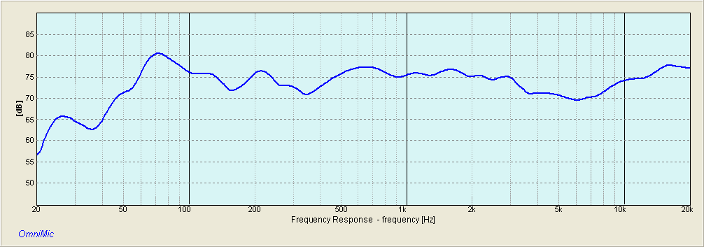

So my question for the speaker experts is what's going on here? Did they intentionally design that 70hz hump into the midbass response? I actually prefer their sound with the ports stuffed with a rag, in which case everything below 150hz is reduced by about 3dB, but I'm thinking somebody who listens to hip hop and pop music might prefer the sound with the ports open.

Re: Dayton Audio B652 and T652 [message #80833 is a reply to message #80832] Fri, 14 November 2014 17:18 Go to previous messageGo to next message
Messages: 2054
Hi, Two possibilities. One the way you are measuring it can cause the hump. Room nodes are killers. I have some that were difficult to control. Second it may just be the resonance point of either the speakers, cabinet or perhaps the port. You might try stuffing it with some open cell foam to tame it.
Re: Dayton Audio B652 and T652 [message #80835 is a reply to message #80833] Sat, 15 November 2014 07:26 Go to previous messageGo to next message
Messages: 377
Location: Houston
Bruce, thanks for the insight. I need to take one to a different room and repeat the measurement. I might also pull a woofer and measure it.
Re: Dayton Audio B652 and T652 [message #80836 is a reply to message #80835] Sat, 15 November 2014 12:46 Go to previous messageGo to next message
Messages: 19101
I agree. If indoors, you can't "see" the speakers below 200Hz or so. You see mostly the room.
It's getting too cold to take speakers outdoors, but that's the only way to get good measurements below 200Hz.
Re: Dayton Audio B652 and T652 [message #80841 is a reply to message #80836] Sat, 15 November 2014 16:59 Go to previous messageGo to next message
Messages: 377
Location: Houston
I did some more investigating. The woofers are fairly high Q for a ported enclosure. The parameters are: RE = 7.5 ohms, resonant freq = 57hz, QTS = .72, Le = .545mH. The enclosure is about 0.8 cu ft, and with a 2" dia by 4" long port it's apparently tuned to about 43hz. The woofers are wired in parallel with no low pass filter. The tweeter has a 6.8uF cap in series.
Wayne, you're so right about it being too cold. It was in the 50's today in Houston. BRRRRR. Very Happy
