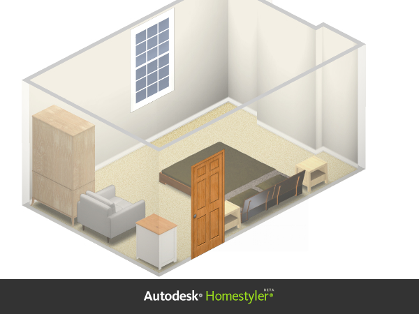

index.php?t=getfile&id=1589&private=0
This is how the room will look, the only addition is a hifi rack 2ft away from the wardrobe to the left of the window.
Our bed is 22 inches high and 5ft away from the chimney breast, the 6Pi (or 7Pi) would be in the corners of the wall with the chimney breast.
Is the bed going to cause problems do you think?
  • Attachment: snapshot2.jpg
    (Size: 141.20KB, Downloaded 4272 times)
Re: Will 7Pi work in my room? [message #80809 is a reply to message #80806] Mon, 10 November 2014 04:50 Go to previous messageGo to next message
It may make the soundstage "lean" to the left slightly, with more absorption on the right, particularly at HF. But it is not reflective, so that's better than something like a table or some other furniture with a hard surface.
