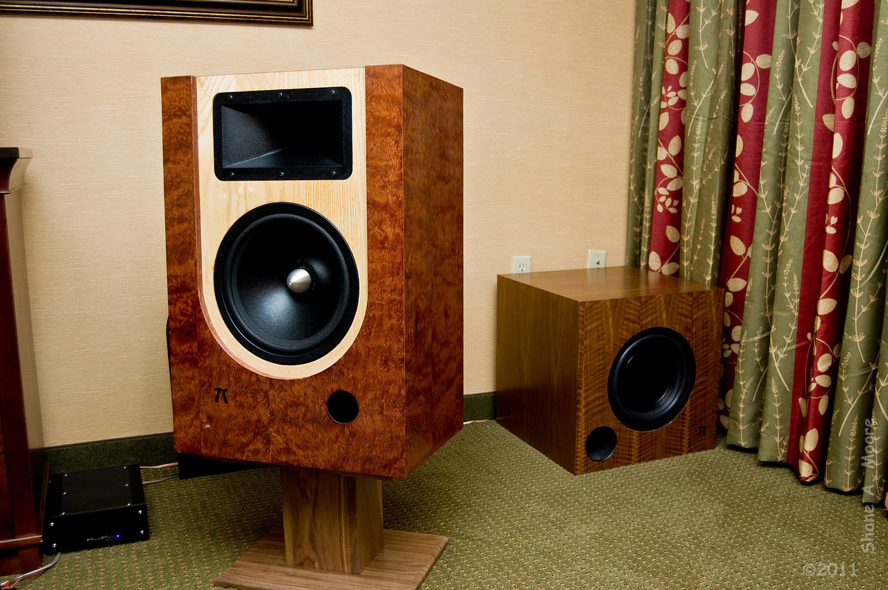

index.php?t=getfile&id=1556&private=0
" So why do this when the shape/size and port placement of the 3pi is all worked out? Partially room layout and partially WAF - unfortunately the 3pi box is just too bulky and intrusive."
Hi, I find 3 Pi quite opposite - they are very nice speakers to look at if done properly... like the one from Wayne!
Max
  • Attachment: Pi 3.jpg
    (Size: 380.79KB, Downloaded 6630 times)
