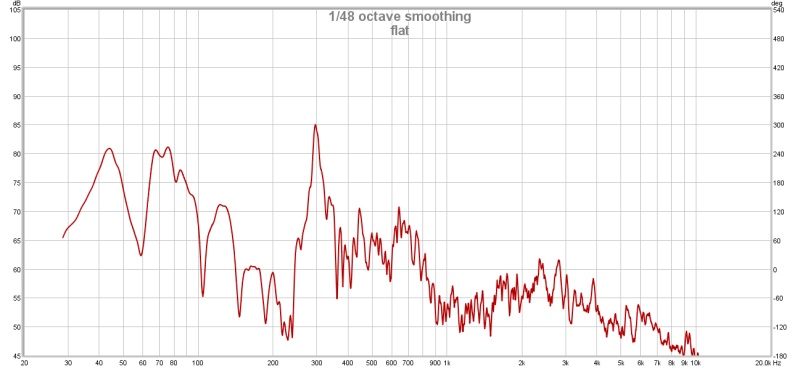

Re: 7Pi Build 2014 [message #80622 is a reply to message #80584] Sat, 04 October 2014 10:22 Go to previous messageGo to previous message
Messages: 86
Registered: April 2014
Location: Auburn, CA USA
REW flat.
index.php?t=getfile&id=1563&private=0
  • Attachment: flat.jpg
    (Size: 69.52KB, Downloaded 10412 times)
