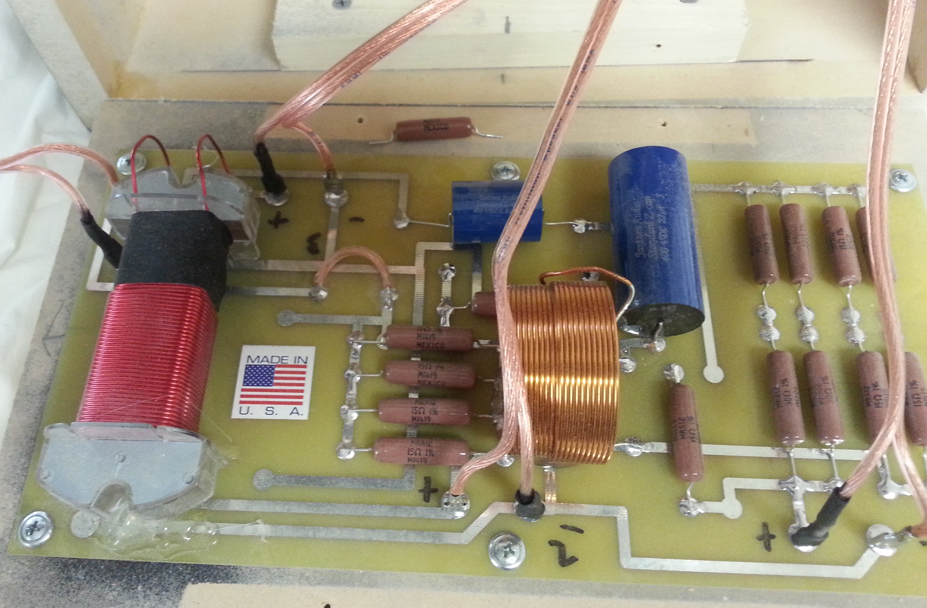

Not the problem, but one resister was rattling around in the XO box. Nothing close to touching it. A mystery. I soldered it back on and they still sound bad.
Picture of XO and wiring. Wires with black shrink wrap are negative all the way back to the drivers.
index.php?t=getfile&id=1552&private=0

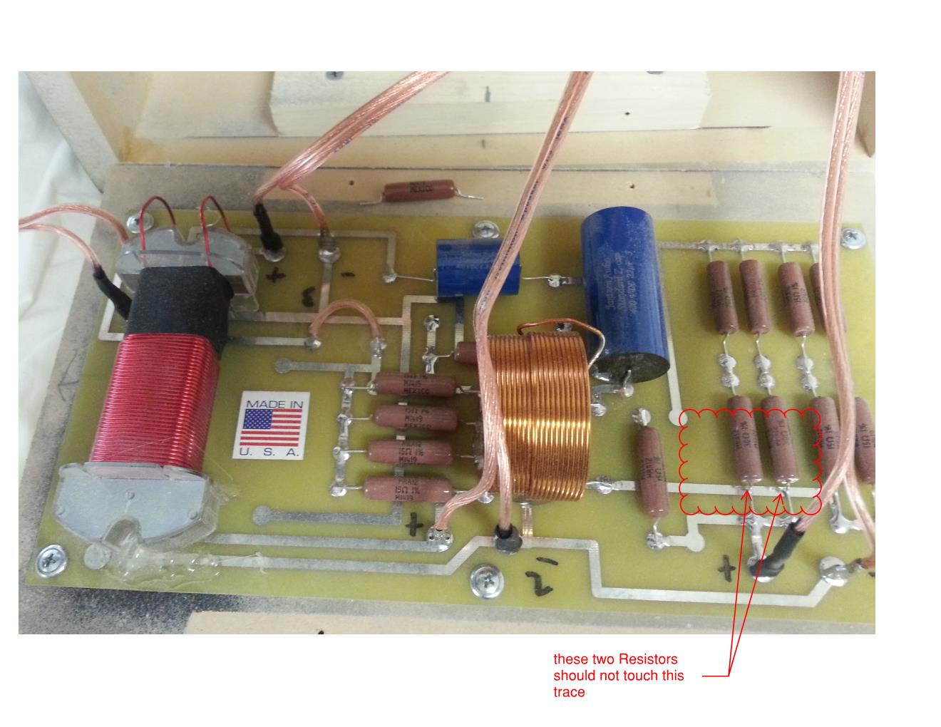

It appears you have resistors R1b and R1d touching the trace from L1. I think they should not touch this trace and only touch at the pad below. Double check all traces against the schematic
index.php?t=getfile&id=1553&private=0
Matt
Re: 7Pi Build 2014 [message #80474 is a reply to message #80473] Sun, 14 September 2014 04:03 Go to previous messageGo to next message
Messages: 37
Registered: February 2012
Location: Netherlands
It looks like 15Ohm damping resistor is also not connected to the ground?
Max

Re: 7Pi Build 2014 [message #80475 is a reply to message #80473] Sun, 14 September 2014 04:42 Go to previous messageGo to next message
Messages: 37
Hmmm, there is also a missing coil on your crossover which you connected only with jumper wire?

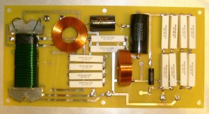

Please have a look at the picture of finished crossover form Wayne, there is a extra coil being soldered for mid horn ( I think 1mH )!
Max
Re: 7Pi Build 2014 [message #80476 is a reply to message #80475] Sun, 14 September 2014 05:27 Go to previous messageGo to next message
Messages: 37
Just one more thing... there is also a missing resistor in the voltage divider part of mid horn ( resistor between coil and small blue capacitor ), supposed to be two 16 Ohm resistors in parallel ( for desired 8 Ohm resistance ) connected with another four of 16 Ohm resistors in parallel ( for desired 4 Ohm series resistance ) to form correct low-end response of the horn ( 4 Ohm series resistor followed by 8 Ohm shunt ).
If you have only one 16 Ohm resistor then is your midrange response probably double louder in the lower-end of spectrum...
Also you used 15 ohm instead of 16 ohm resistors, this could change somewhat impedance of crossover, not the attenuation, Wayne can give as input on that.
Max
Re: 7Pi Build 2014 [message #80477 is a reply to message #80476] Sun, 14 September 2014 10:38 Go to previous messageGo to next message
Messages: 19075
I can see that resistor R5a is missing, so I'd suggest putting that back. And I agree with Matt, I would check to make sure the leads from R1b and R1d are not bent, touching the trace from L1.
But to tell the truth, crossover problems usually present as missing or over-represented portions of the frequency spectrum. Examples would be too much bass or bass that's too thin, missing treble or too much. Vocals can sound too throaty or hollow. When there's something wrong with the crossover, it usually sounds like the response curve is off, because it usually is.
When people complain of distortion in a new speaker, it's most often caused by something rubbing or buzzing. So look for things that may be rubbing against the cone. Make sure the gasket isn't in contact with the cone or surround, and make sure it's sealed. No gaps. Check the wiring too, making sure the wire isn't resting on the cone, which will make a buzzing sound. And finally, make sure the back panel is secure and doesn't vibrate. See the post about Midhorn bracing. You'll probably want to do the "rubber ball brace" for the back panel.
