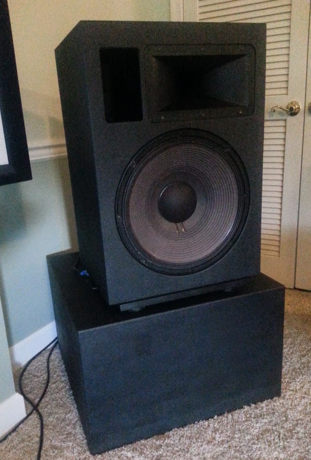

Re: 4 Pi Home Theater Build [message #80385 is a reply to message #80333] Thu, 04 September 2014 06:56 Go to previous messageGo to next message
Messages: 143
Here are some photos of the LAB-12 based flanking subs:
index.php?t=getfile&id=1524&private=0
index.php?t=getfile&id=1525&private=0
index.php?t=getfile&id=1526&private=0
VIRIBUS MARI VICTORIA

Re: 4 Pi Home Theater Build [message #80387 is a reply to message #80386] Thu, 04 September 2014 07:00 Go to previous messageGo to next message
Messages: 143
And finally, original two built 3 yrs ago getting Duratex finish:
index.php?t=getfile&id=1531&private=0
index.php?t=getfile&id=1532&private=0
index.php?t=getfile&id=1533&private=0
As soon as I get the third crossover from Wayne I will be up and running with LCR. Will be nice to have a center channel again!

Re: 4 Pi Home Theater Build [message #80411 is a reply to message #80389] Fri, 05 September 2014 17:35 Go to previous messageGo to next message
Messages: 143
It's been a looooong trip...the speakers have literally been around the world.
They sound a lot better after the refinish job, apparently during the transit from Cambodia the bolts holding on the DE250 CD's came loose, on both speakers (that or I didn't get them tight 3 yrs ago, I'm going with trouble in transit so I don't look stooped!). Amazing how much more top end there is now.
Great news about the crossover shipping, I'm putting on the final Duratex coats on the center channel speaker today.
