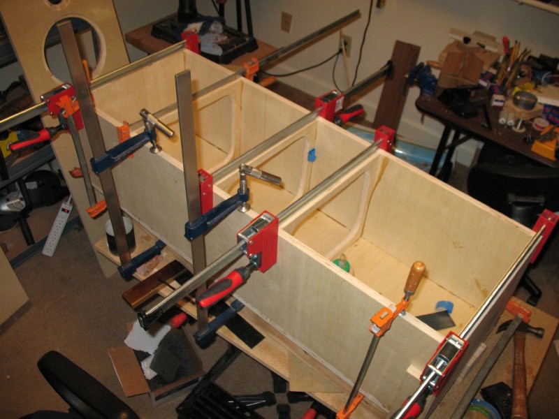

Re: 2 Pi Tower kits [message #79863 is a reply to message #79848] Sat, 26 April 2014 18:25 Go to previous messageGo to next message
How you build depends on the tools and clamps you have but this is what I do, using braces cut on the same saw setting as the tops and bottoms to square it up. No fasteners, just Titebond and Butt Joints.
index.php?t=getfile&id=1459&private=0
I just use dabs of glue to hold the insulation in place but I usually have to "convince" some pieces to stay put with 1/4" staples.
