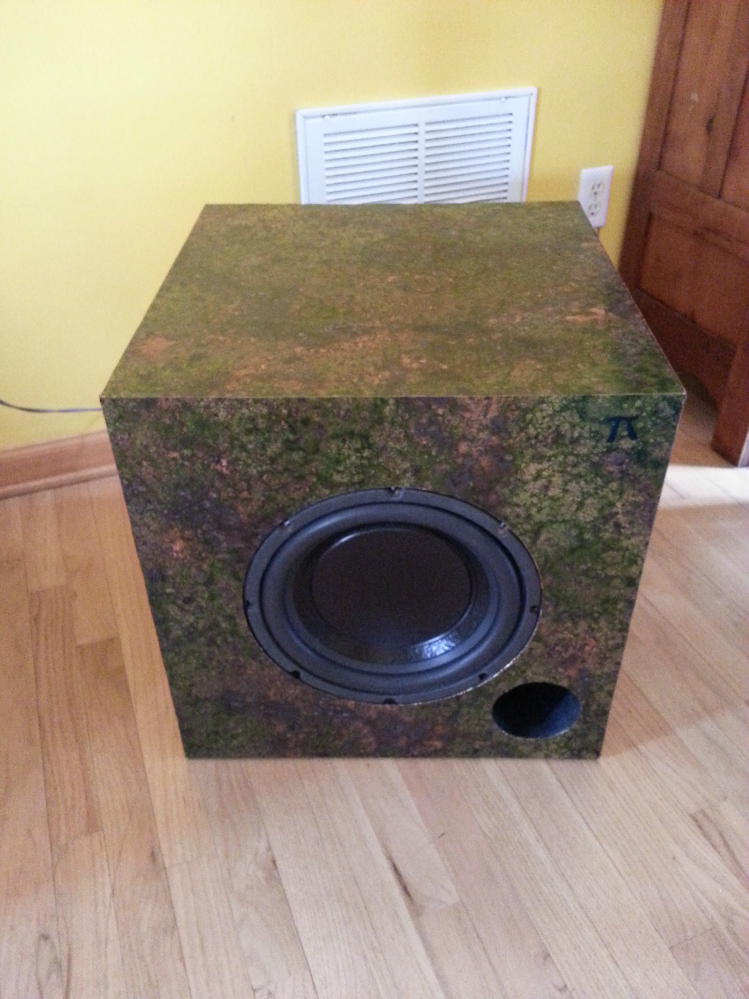

I ended up making some Ebay purchases, and the sound is great!
Adcom GFA-555 amp
Rane Active Crossover
Rane Balance Buddy
I used copper laminate on the subs, and they came out pretty well. We've had quite a few cloudy days lately and the speaker didn't show up well in my photo, so I included a photo of the top of one of the speakers so you can see how beautiful they came out.
index.php?t=getfile&id=1450&private=0
index.php?t=getfile&id=1451&private=0
Thanks,
Doug
