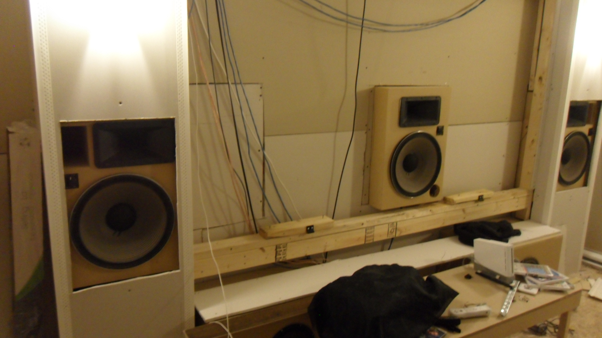

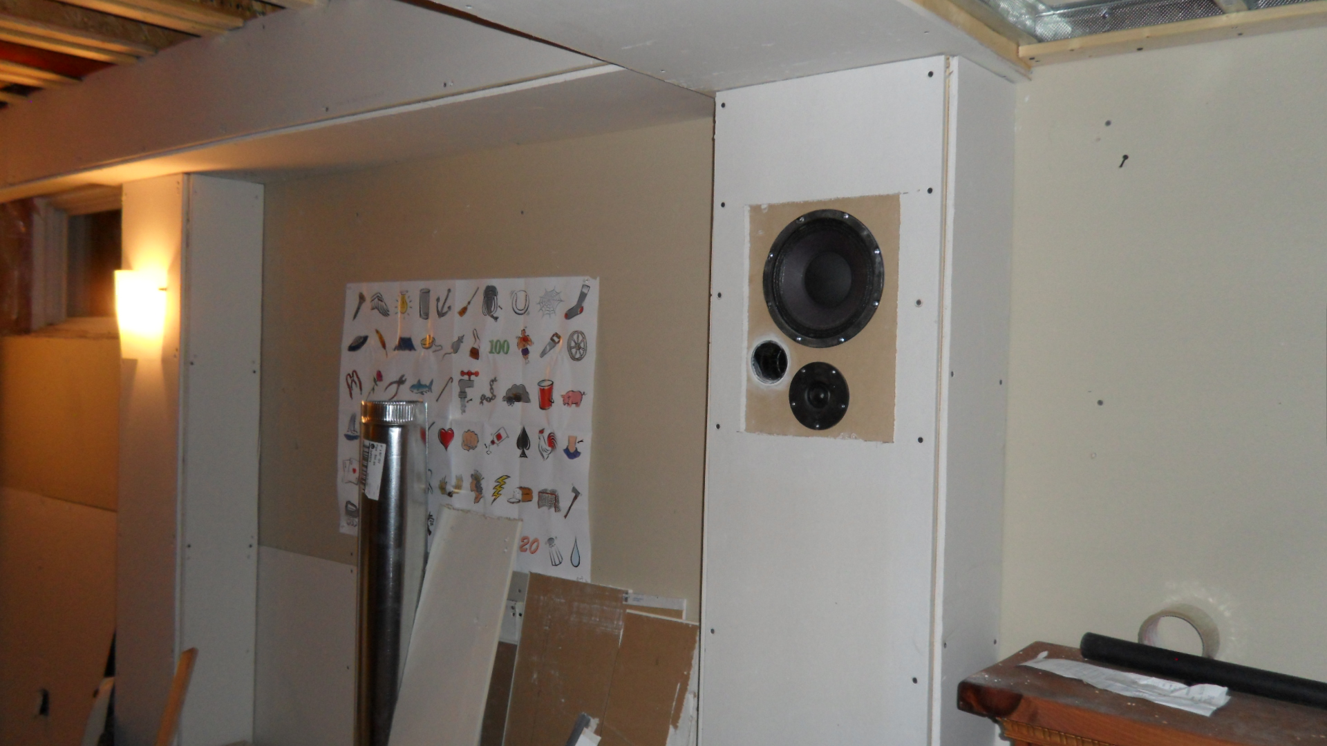

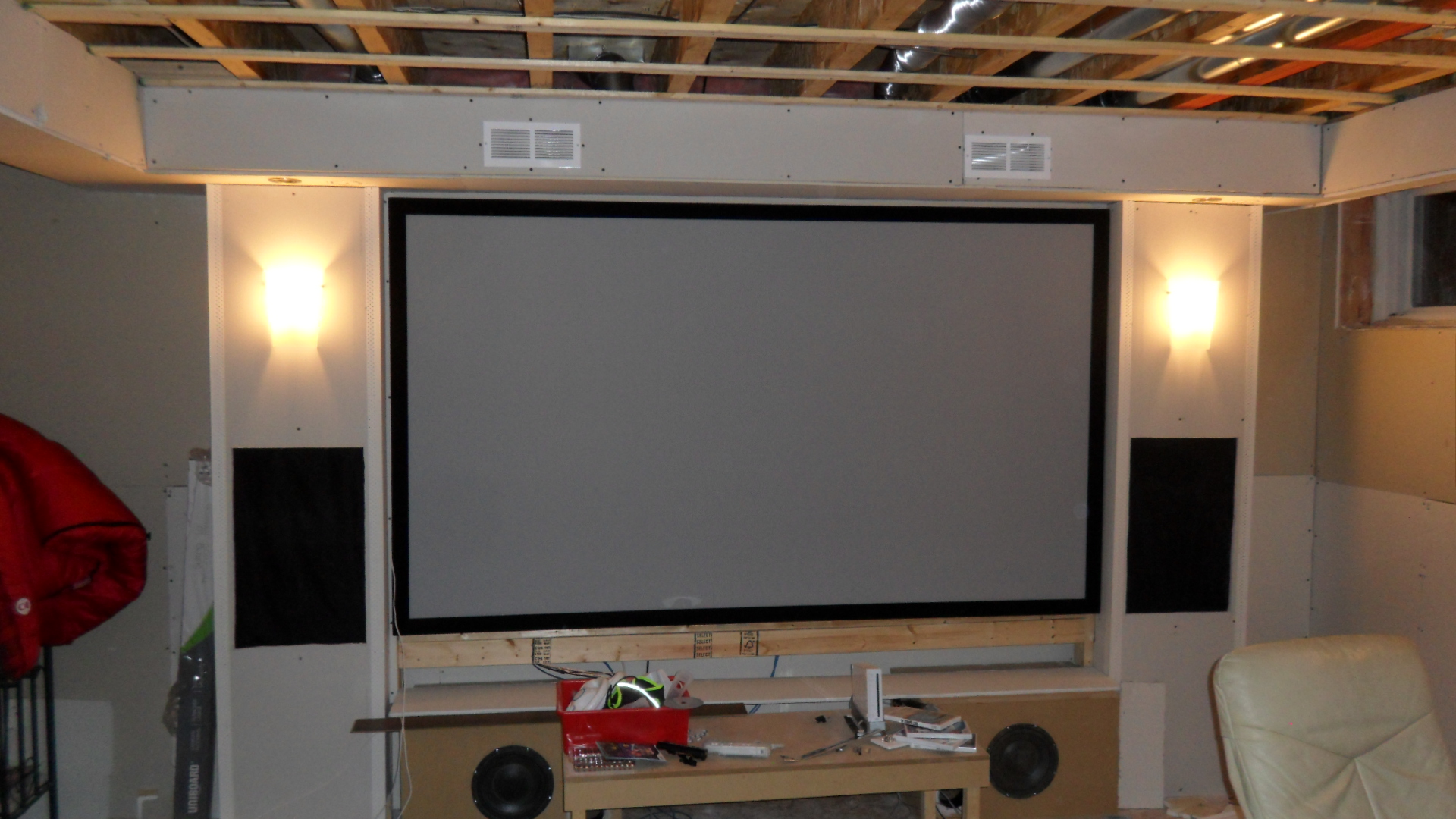

Hi guys,
I started buildin my cave man with high WAF. I was able to include PI speakers but I had to use creativity to integrate. I integrated left and right(4 PI) into columns on each side of the screen. Center is behind the screen (4PI sealed) - I had issues in compromizing here. Side columns include 1 PIs (hear level)and I have two others 1 PI at the rear (ceiling) to make a 7.1 system.
Here are a few pictures (sorry, really messy...). I am finishing the ceiling and will install flooring within the next two months.
index.php?t=getfile&id=1439&private=0
index.php?t=getfile&id=1440&private=0
index.php?t=getfile&id=1441&private=0
I will paint speakers black (add PI logo) and add shakers (cabinet style) on all columns.
The final idea is to not see any speakers (sorry Wayne!...).
Everything is up and running but all the cosmetic has to be done. Sound is amazing, dynamic, very big. Thanks Wayne for sharing drawings. I will update once in a while to show progression.

A little more info: I downsized the volume of the Center 4 PI (stupidly thinking it will only affect bass), despite advise from Wayne, to fit behind the screen. It was terrible mistake in term of quality - low mid were way too strong on some sound tracks. As a result, I will have to re-do it - keeping intact the internal volume (I will have to re-size, I assume the risk).
I resized all four 1PI to fit, keeping internal volume unchanged. No issue here (I have not measured but it sounds good.
Personnal opinion: To my hear 4PIs and 1PIs are not perfect fit together since the 1PI seem to play higher in frequency. It attracts my attention when watching a movie. However the system is not yet balanced. Not a major concern.
The equipment that drives everything:
- OPPO 105 (used as a preamp and HT processor)
- Main amp - SIMAUDIO 4150 (2 channels)
- Surround and center amp - SIMAUDIO HT-5 (5 channels)
- Sub amp - Dayton SA-1000
- Projector - Optoma HD-33
- Everything hook up to my home network with Audio-Video Server
- Room treatment to come...
