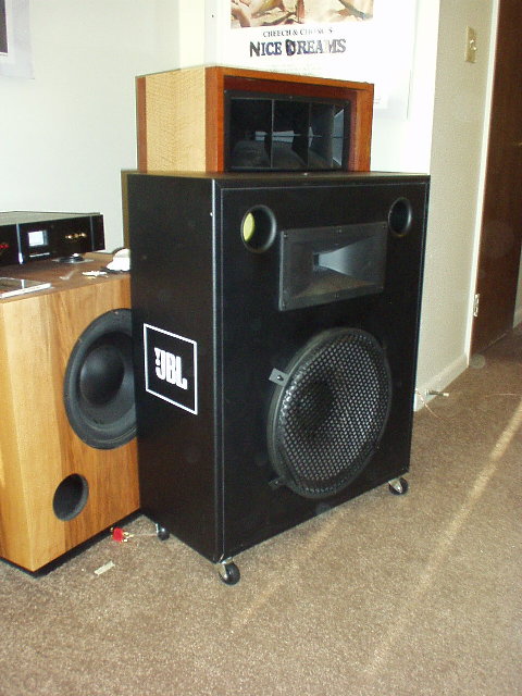

Has it been 12 years since the JBL Tent Sale?
Seems a lot of us posting here and Audio Karma and Asylum, etc. bought a pair of 3677s and at least one 4648A for it's set of two 2226Js (still have'm and still in my 4Pis). I vaguely recall thinking the 3677 came with a very good 2205(?) that turned out to be a far lesser woofer; the 2226Js went into the 3677 cabinets.
Those had the good 2370 horn (have you seen what they retail for?) and again, a down-market comp driver. I think I used Altec 902s in mine. It was thought the shallow depth of the box was a factor and they sounded very good.
End of story, the 2226 is unmatched as a mid-woofer and after 8 or 10 years of farting around with lot's of different cabinet builds, putting them in Wayne's 4Pi configuration was a revelation.
index.php?t=getfile&id=1431&private=0
  • Attachment: site1212.jpg
    (Size: 80.02KB, Downloaded 5711 times)
