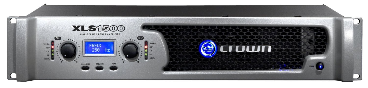

In the mean time, I ordered a Crown XLS-1500 tonight to drive my Pi 4s,

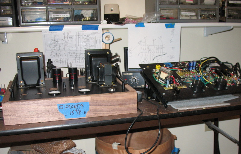

Where are the tubes?
index.php?t=getfile&id=1435&private=0
Coming soon to Pi 4s near you

Very nice. I hope to pick up a kit amp using tubes in the near future, but need to let my budget recover first! Any suggestions for one?

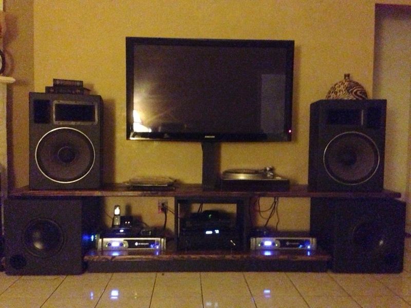

For those who haven't been following the thread:
- 2x Pi 4 mains w/ B&C DE250 + JBL 2226H
- 2x Pi 3 subs
- 1x Yamaha RX-A830
- 1x Crown XLS-1500 (mains)
- 1x Crown XLS-2500 (subs)
- 2x Art CleanBox Pro (one for each amp)

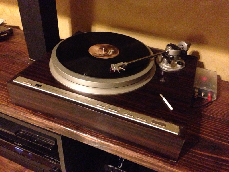

- 1x Sansui XR-Q7 turntable w/ Denon DL-110 cart
- 1x Hagerman Bugle 2 w/ 1k loading & 50db gain
index.php?t=getfile&id=1444&private=0
Veneered cabinets, matching TT plinth, and 2x Phase Linear D-500 amps possibly coming in the near future!

Love that system! Love your turntable! Nice!
How do you keep the feedback from killing you though? In between the mains, maybe I guess if you keep the power down. But your Crown's are made for SPL.

Thanks!
The turntable plinth is made of at least 3/4" wood and has 2+" diameter rubber feet that go at least an inch into the chassis. It does a very good job of damping vibrations from the speakers.
It does become a problem, but not until you reach absurd listening levels.

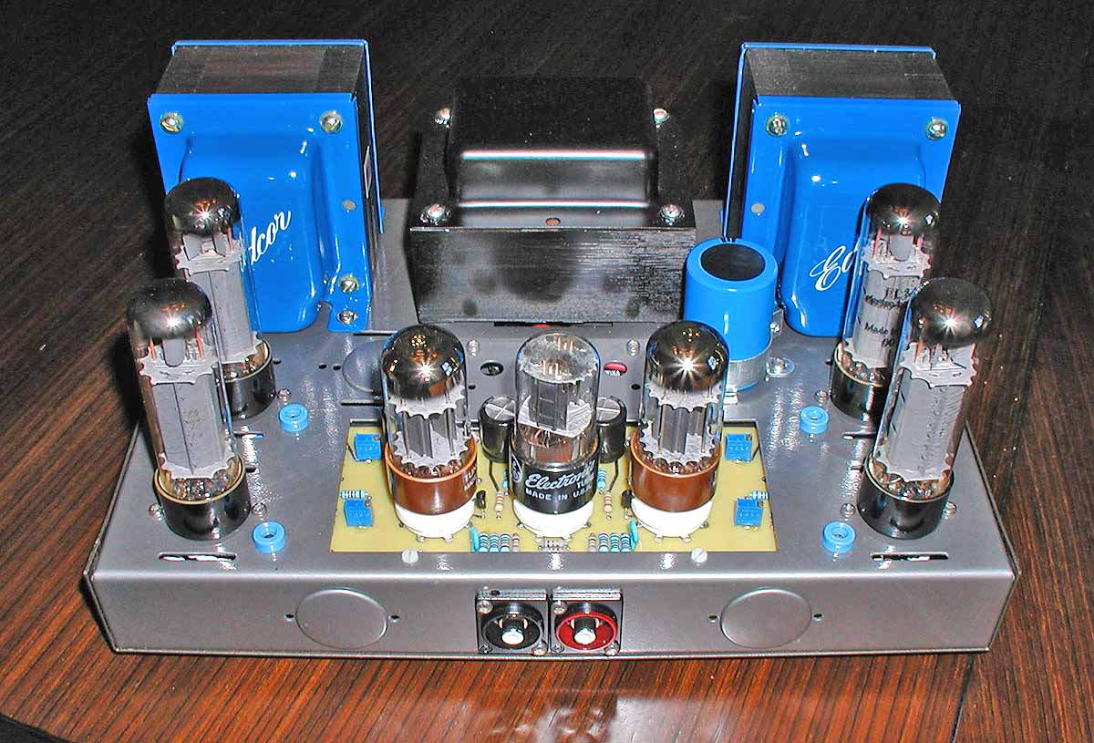

I have a pair of speakers, close to the Pi4. I already had some drivers, but not what Wayne uses. But I needed to save cost, so I used what I had. The crossover I use is from Wayne. I ordered it built, with upgraded coils and resistors. The amp I use is a 35 watt Dynaco 70 clone. One of my favorite upgrades on the amp is the VTA Octal driver board using Octal input tubes. I use new old stock GE input 6SN7 and new phase splitter 6SN7 tung sol reissues.
I agree with most all the decriptions of the speakers. They sound great. Dynamics and power like no other. Now I am trying figure out what type of subwoofer to use.

What driver did you use? Your amp sounds neat; I'm going to build a tube kit of some sort in the near future. I don't think you can go wrong with the 3 Pi subs. Get two!
