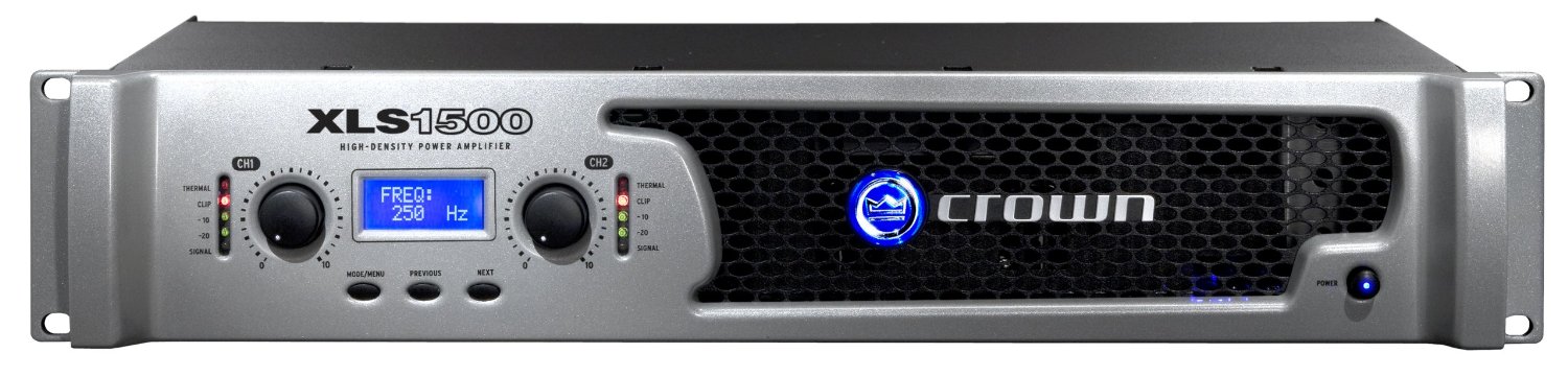

In the mean time, I ordered a Crown XLS-1500 tonight to drive my Pi 4s, along with two Art CleanBox Pro's and XLR cables to put between the CleanBox's and the two Crown amps. The CleanBox's will be used to correct the gain issues mentioned in the last post. I've read great things about them on other forums.

jshupe wrote on Mon, 17 March 2014 00:58

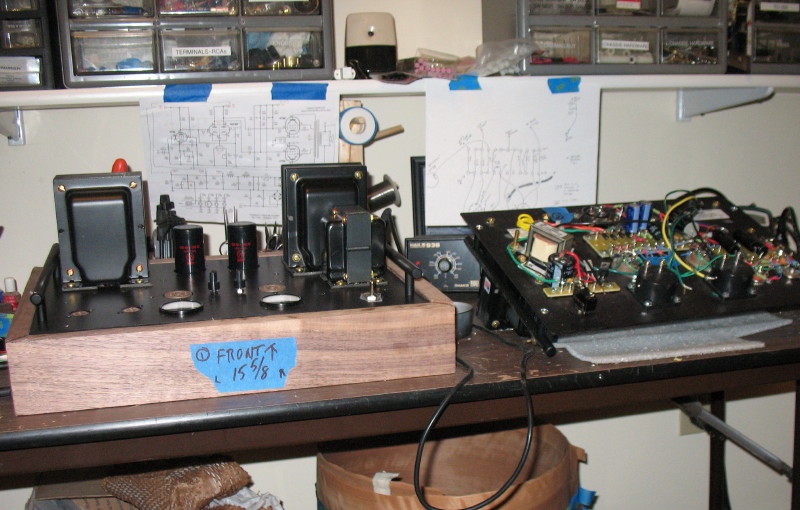

Where are the tubes?
index.php?t=getfile&id=1435&private=0
Coming soon to Pi 4s near you

That 1500 should drive those 4s really well. I'm using a pretty big amp on my 3s a W4S STI500. It's nice to have lots of power on them because they do dynamics really well. I have a 50wpc tube amp but haven't tried it yet.
