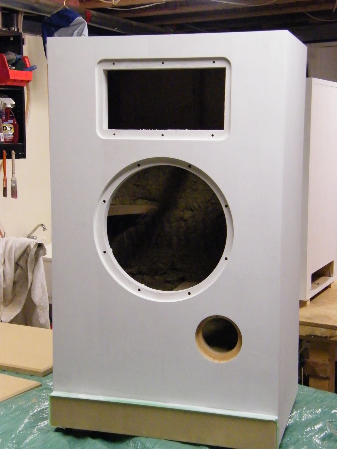

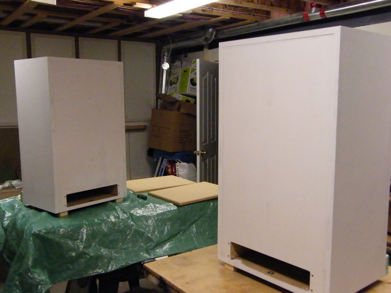

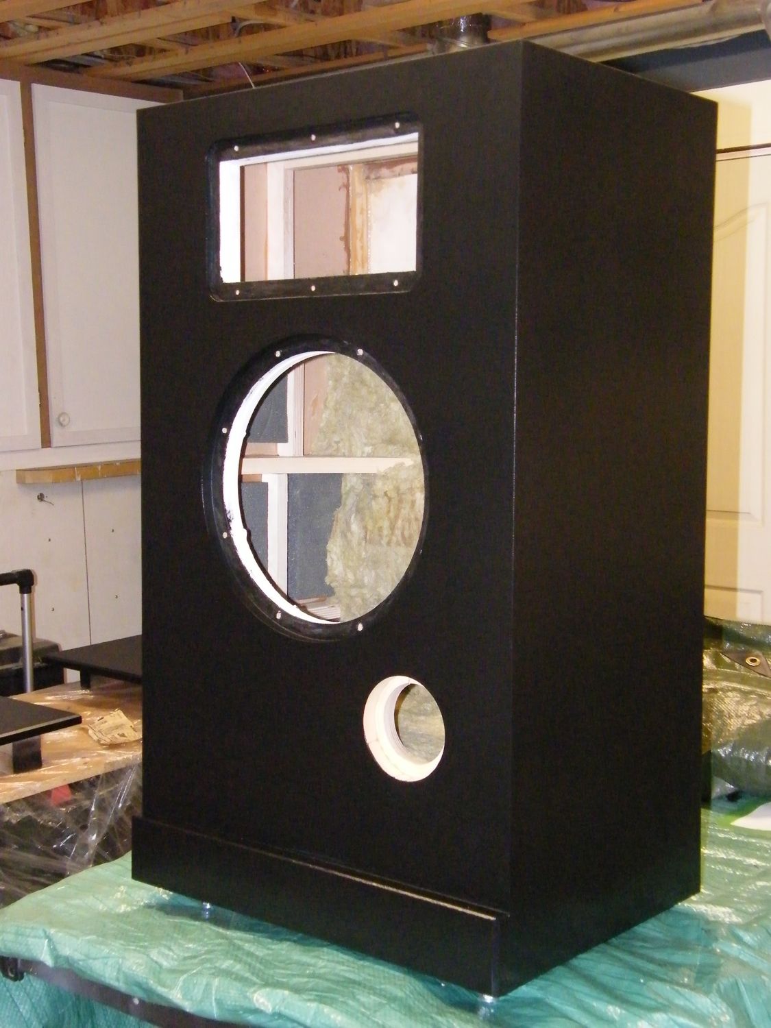

OK, next up. Finishing the boxes. I started with a coat of Zinzers oil based "Cover Stain" primer.
index.php?t=getfile&id=1399&private=0
index.php?t=getfile&id=1400&private=0
I had planned to paint the plinth at the bottom of the baffle and the tops with a Black Lacquer. After experimenting with this on the tops I abandoned it for now. It did not go well and the odour was strong and persistent. I still may lacquer the tops. I painted them with the same finish as the rest of the box. I screwed them on without gluing them so I can change them out if I decide on a different finish. Perhaps in the summer when I can work outside i will try again.
I then applied 2 coats of Rustoleum Painters Touch flat black latex. I used a foam roller. Next I applied 2 coats of Varathane Diamond Coat satin with a good quality bristle brush. If you try to roll this stuff you get runs and air bubbles.
index.php?t=getfile&id=1401&private=0
index.php?t=getfile&id=1402&private=0

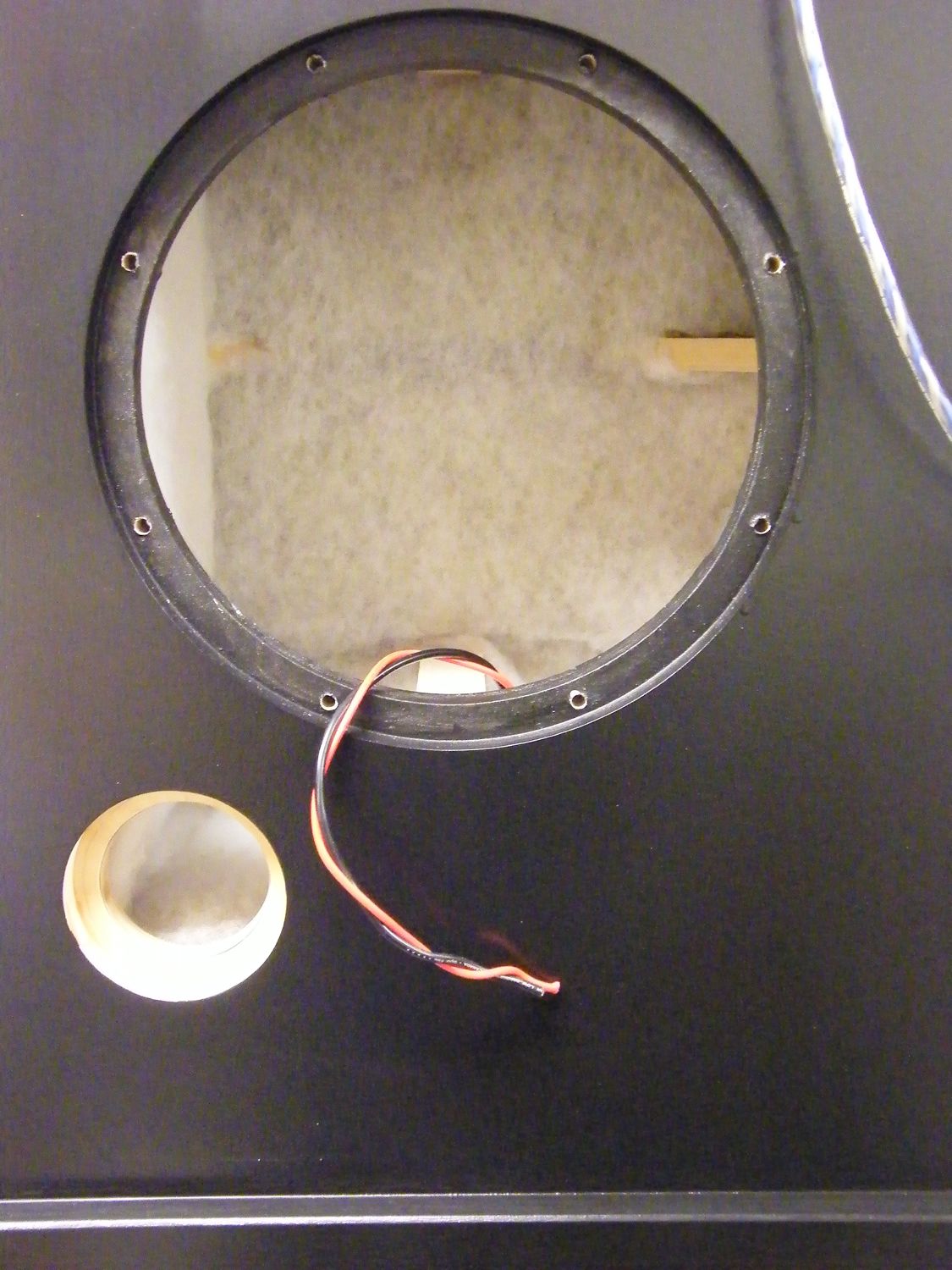

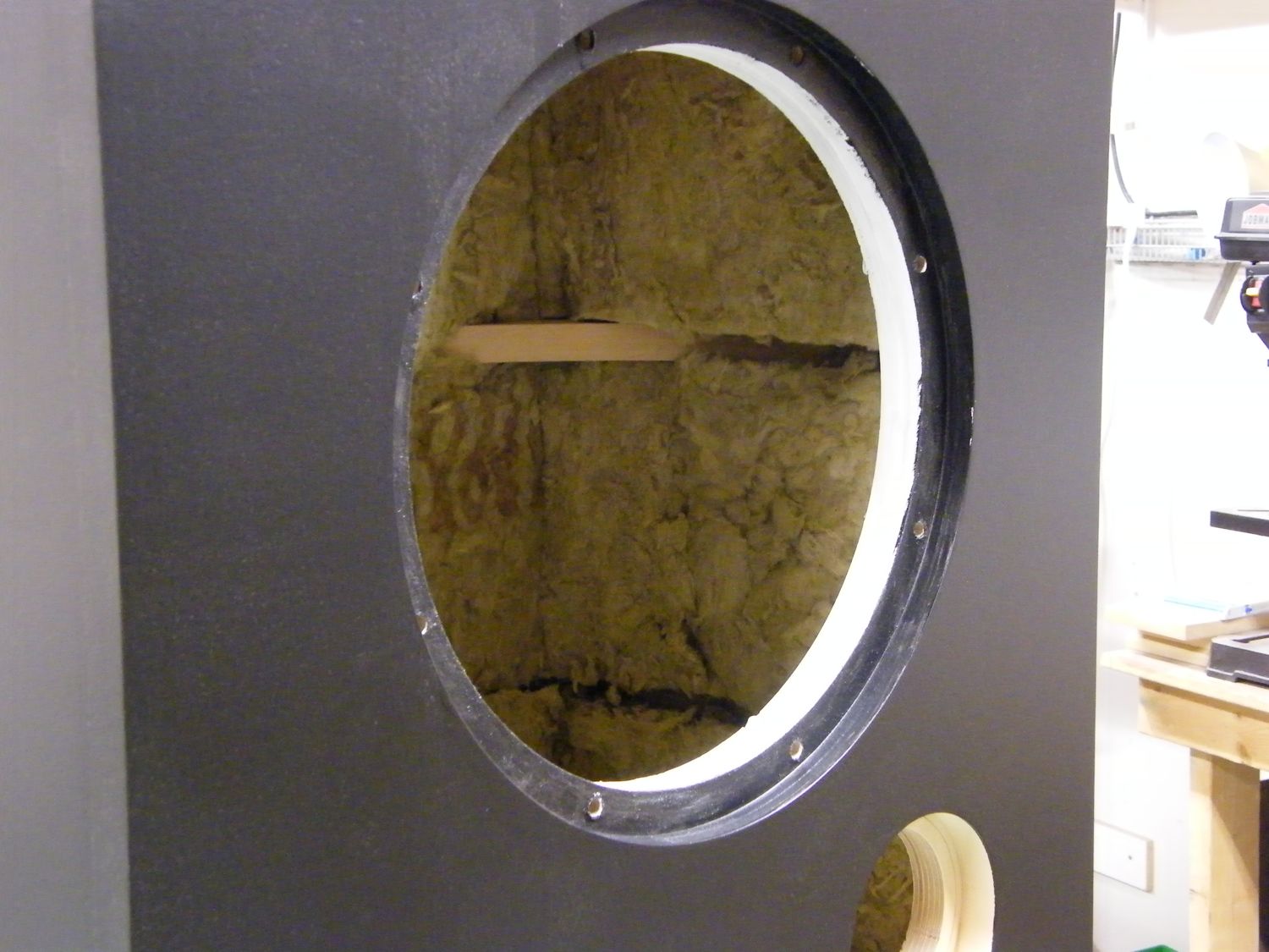

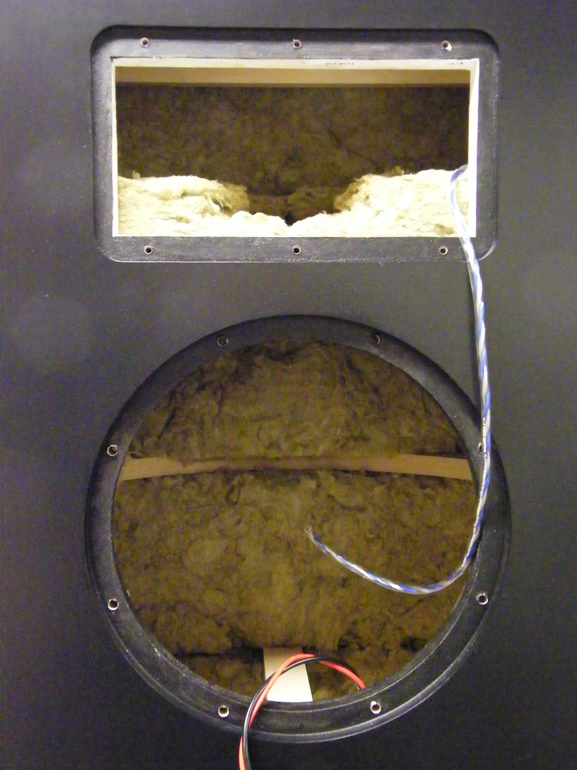

I next ran the wiring from the crossover up through a hole in the base. I sealed the hole with electricians putty on the bottom and silicone on the top. I used batt insulation on the backs, bottom and side nearest the port. I also placed a batt on the window brace between the horn and woofer. I covered the batts in the woofer section with a layer of quilt batting to prevent any fibres from getting out of the box. I remember demoing some speakers one time and the salesman decided to show off and play a track of some thunder at an extreme level. A big chunk of fibreglass blew out the port. Needless to say I didn't buy anything from them and have always wondered if any fibres are being pushed from a fibreglass insulated box in routine operation.
Note! The camera somehow got switched to image stabilization mode which resulted in low quality pictures here.
Batts in place. I cut away some of the insulation for the horn/driver to fit.
index.php?t=getfile&id=1403&private=0
Quilt batting added.
index.php?t=getfile&id=1404&private=0

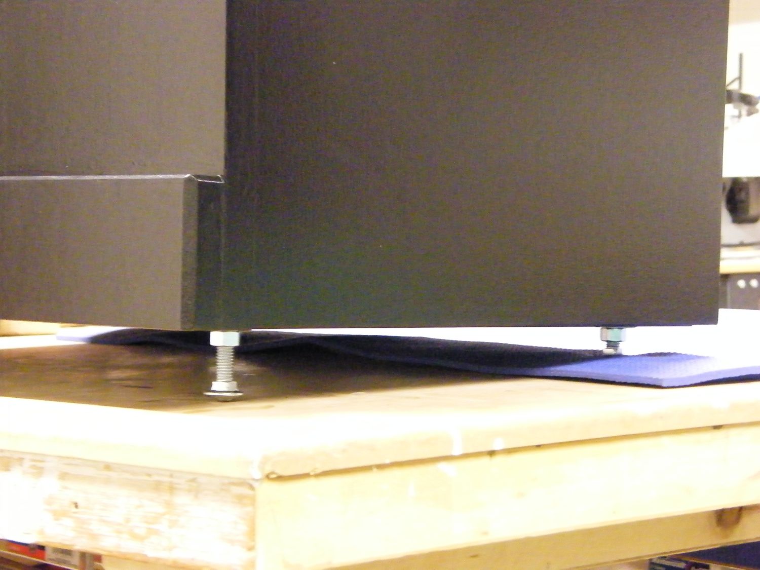

I also installed some "affordable" spikes. Carriage bolts, nuts and washers. In this case the size is 3/8". If you are doing something like this make sure you allow clearance for bolts to extend up into the enclosure. I set up the enclosures for a upward tilt of about 3/4" from back to front. This should get the sound up high enough to not need any stands.
index.php?t=getfile&id=1405&private=0

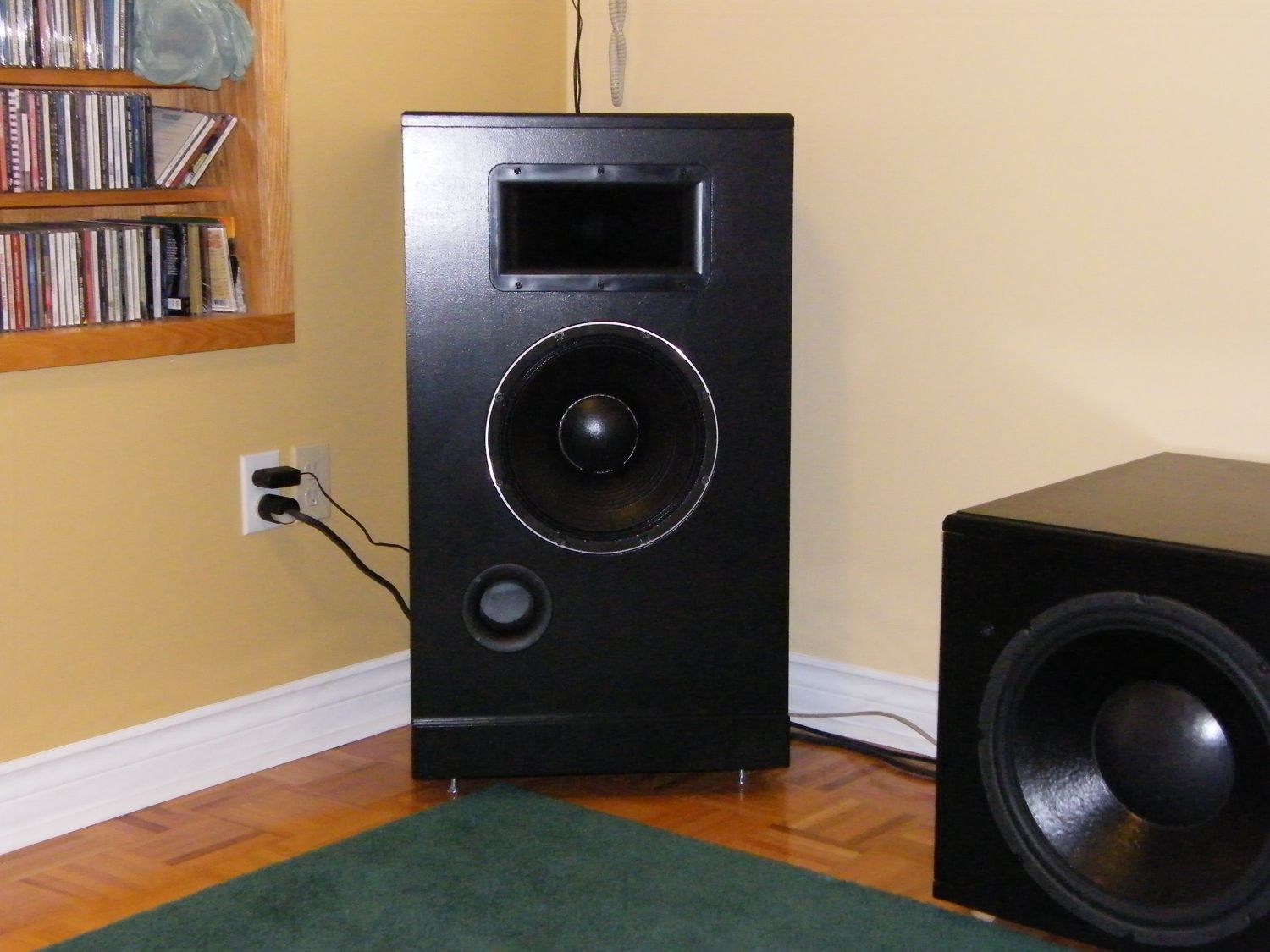

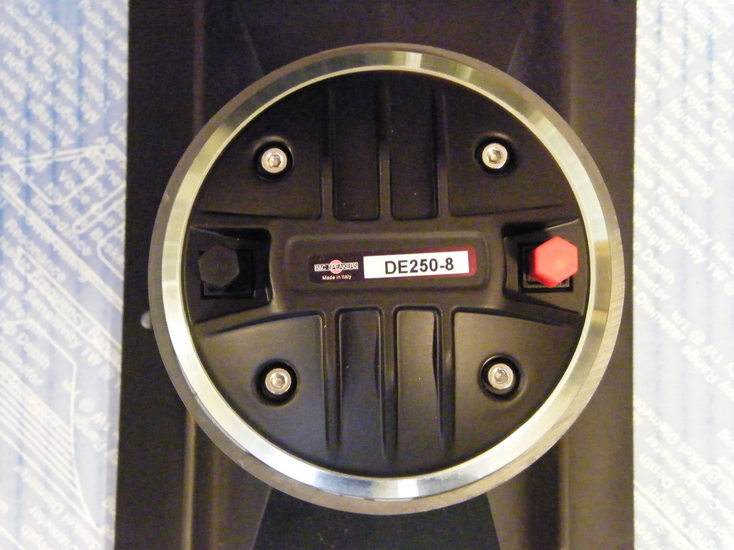

For ports I am using some that I had around. They are flared at the front and tapered slightly in diameter. I had 4 of them. 2 used and 2 new. In order to get the correct box tuning I decided to experiment with the used set of ports. I used an average diameter for the port. This figure was about 10% larger than the stock 2.5". Since the port length formula has radius squared as a variable I squared 1.1 and came up with a figure of 1.2 x the stock length of 2.5" or 3". I cut the used ports to 3" and installed them as a starting point. I can then measure the tuning frequency and work from that figure to find a port length for the permanent installation.
Driver install was pretty straight forward. The BandC 250 came with hardware to install them on the horn. It didn't take long to get things finished.
index.php?t=getfile&id=1406&private=0
index.php?t=getfile&id=1407&private=0
index.php?t=getfile&id=1408&private=0
I decided to try the corners as a location for these. The room is 19' x 12.5'. I put them in the corners of the long wall angled at 45 degrees which seemed incredibly far apart. I am not using the subs at this point.
So... how do they sound. Different from what I was used to. It's early to make any judgements but one thing is obvious. Dynamics are stellar. I played Jonny Lang - I Am from the album Wonder This World. This track is very dynamic and I turned it up and was surprised to hear it play much cleaner than I'd heard it in the past. The vocals stayed clean where previously they would get nasty when even approaching these levels. The overall tonality is good with no obvious problems. Bass is tight and a bit thin down low, but the woofer is just breaking in and I am used to 2 subs being in the mix. I'll post more later on sound. It's very promising at his point.

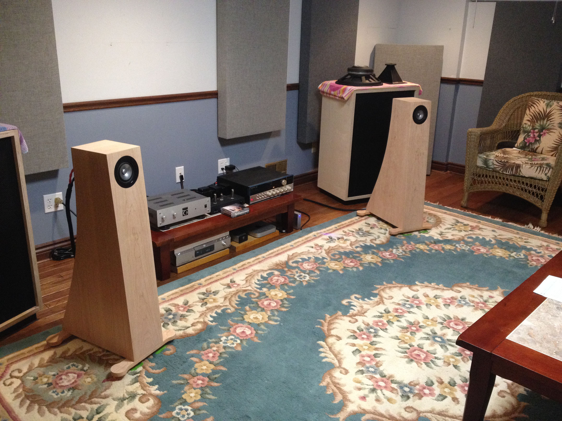

I have my Cornscalas in a 20' x 15' room, speakers on long way about 3' from side wall and 2' into room which puts the front-center of the speaker about 12' a part and main seating position 11' from each speaker.
This gives me a nice wide sound stage with no noticeable hole in the middle.
Even when I had my previous KHorns in the 20' corners I was getting a similar good soundstage.
I would suggest moving your 3PIs closer together, yes you will probably lose some bass response with them out of the corner, but you should improve your side to side imaging.
I know PWK suggested using a center channel in mono to help imaging with wide corner placements but I never have tried that technique.
index.php?t=getfile&id=1410&private=0
This shot shows how my CSs are place in relationship to my 20' corners... about the same for the left speaker that is not completely in pic.
Hopefully trying some different positioning will get you where you want to be.
Yes, horn speaker do excel in the dynamics.
I love the way hons sound, a real "live sound"!
I am sure your 3PIs and my 4PIs (once I get them built) will be equally enjoyable in this regard.

Tom, your system and room look great! I see you have some interesting items damping the tops of your Cornscalas! I've never experienced horn loaded tweeters in my system. They are not harsh or strident at all, just the opposite in fact. I had the subs on last night and have got them dialed in pretty close by ear. I'm going to get out my DEQ2496 and measurement mic and see what's up in the bass. I want to give the woofers a little more break in time. I re tightened the mounting bolts last night and they had loosened off a bit. Gasket compression I guess. I need to measure the port tuning frequency so I can determine the proper port length for the permanent install. I hope to get the grill frames done on Saturday.

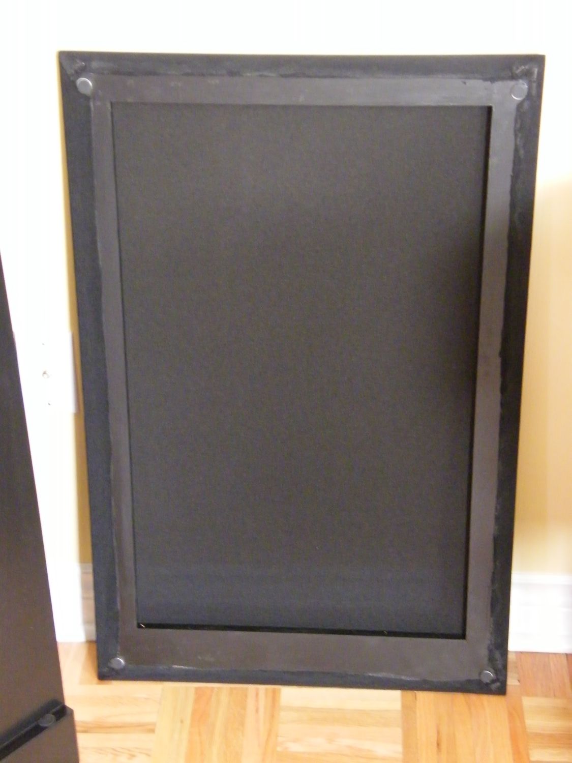

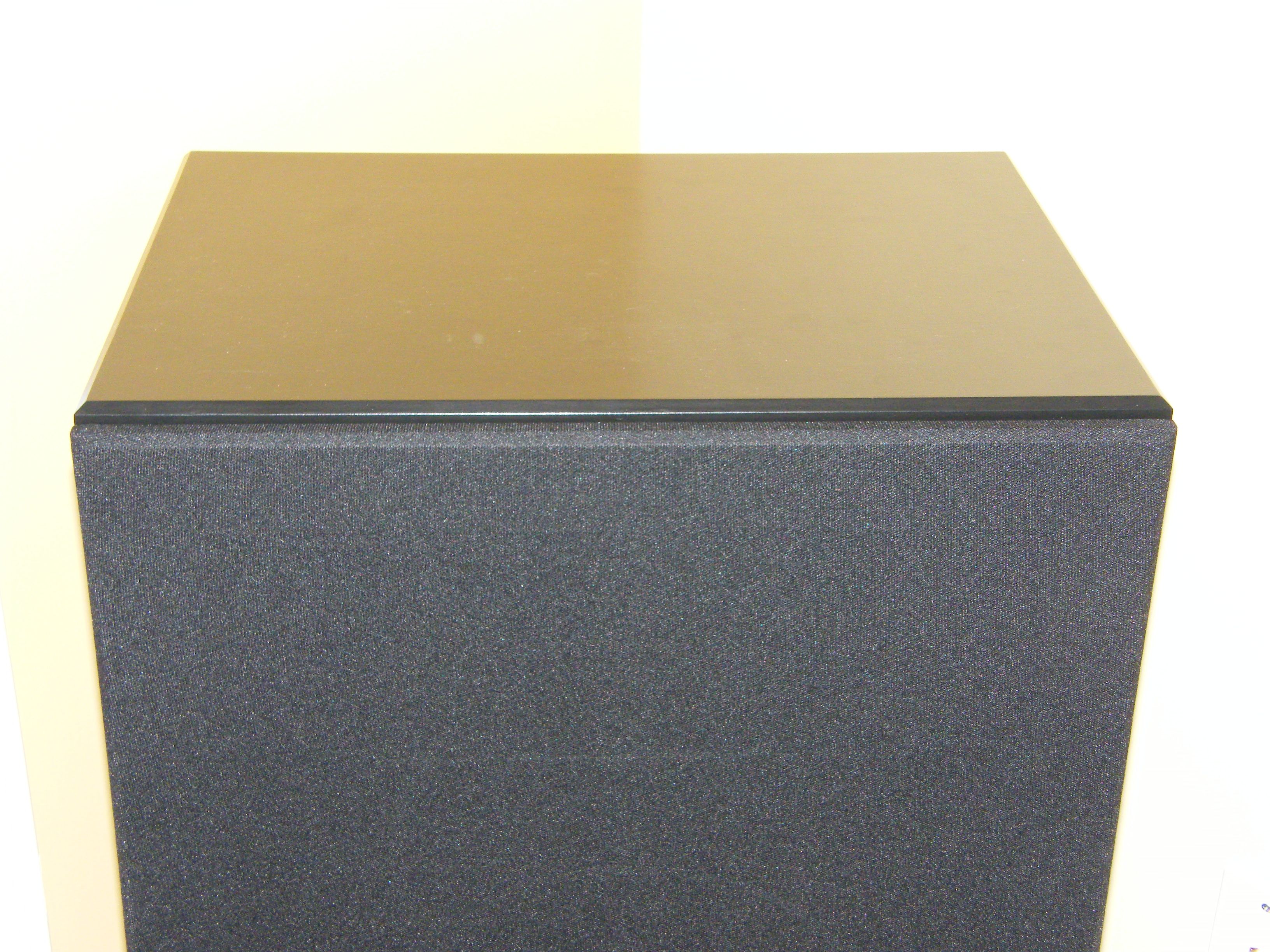

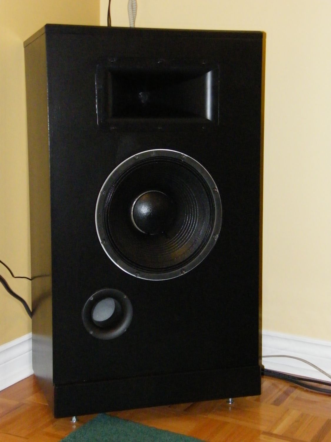

Got the grills done and have continued to experiment with placement. The grills are simply a frame of 1/2" MDF 2" wide on the top and sides and 3" wide on the bottom. They are simply butt joint glued together and painted flat black. The fabric and magnets/ friction discs were added and they do the job just fine.
index.php?t=getfile&id=1420&private=0
index.php?t=getfile&id=1421&private=0
index.php?t=getfile&id=1422&private=0
I have abandoned trying to get decent sound on the long wall. Even with the speakers moved in to 11ft. apart I still could not get a decent centre image unless I sat right in the middle. Moving a foot to the side would pull the sound to the speaker. I also had my chair against the wall which never seems to work well IME.
I put them in the corners firing up the long dimension of the room where I could sit further back. This seemed to create the stable image that they are supposed to produce. I placed my subs in the opposite corners behind the listening seat. This provides excellent deep bass and integration with the PI 3.
I got a chance to check the port tuning and it was lower than spec at 26.5 hz. I cut the ports down to just under 2" and got a tuning of 29.8hz which is right where it should be. I do wonder if I have too much insulation in the boxes. I used rock wool batts that are 3" thick and are designed for acoustic duty. At 2.5lb/cu.ft. they are slightly denser than regular fibreglass or rock wool which I believe are around 2lb.
