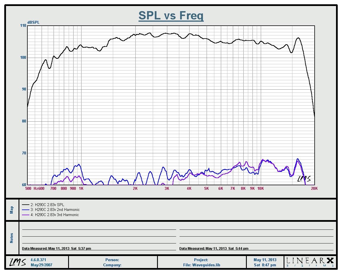

I may have answered my own question. I found this graph from another website:
Looks like it doesn't start tapering off until 850 Hz or so.
It was a toss up between the H290C or SEOS-15.

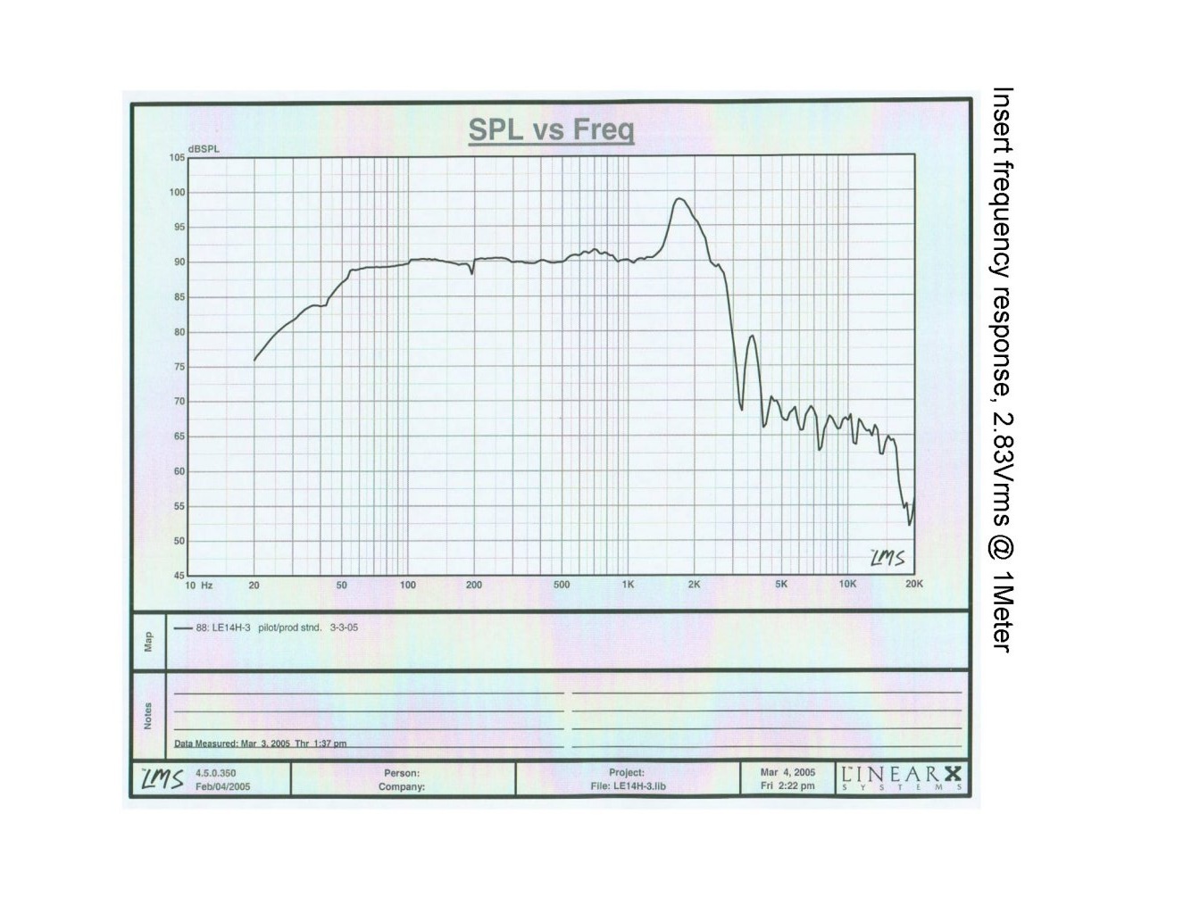

index.php?t=getfile&id=1412&private=0Here is a freq response I found for the JBL.
Looks like it will play high enough for the 2-way speaker I hope to build.

Re: H290C and JBL LE14H-3 [message #79476 is a reply to message #79360] Mon, 17 February 2014 09:06 Go to previous messageGo to next message
maxserg is currently offline  maxserg
Messages: 1
Registered: February 2014
Location: Montreal
The freq resp in on axis for the LE14. No shure it would go higher than 500/800Hz, you would need a horn that goes lower. The dispersions need to be almost the same for the 2 components at xover point.
