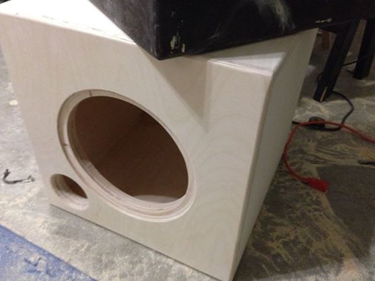

I still have a lot of cleaning up and finish work to do on the mains, but here they are so far.
Rectangles are hard to get right -- for my next set of cabinets I'll be making a router jig for them.
index.php?t=getfile&id=1415&private=0
index.php?t=getfile&id=1416&private=0

Re: New Pi 4 + Pi 3 Sub buildout [message #79392 is a reply to message #79383] Mon, 10 February 2014 22:28 Go to previous messageGo to next message
jshupe wrote on Mon, 10 February 2014 13:24
If you don't rebate the horn the cut out isn't critical but no way to get 'round the appearance of the vent.
Cheap trick is to craft a really square vent box and get it glued on to the baffle before glue-up just right. Then, make the cut with a flush trim router bit. The vent box is your guide.
Re: New Pi 4 + Pi 3 Sub buildout [message #79393 is a reply to message #79392] Mon, 10 February 2014 23:01 Go to previous messageGo to next message
Messages: 31
Registered: January 2014
Location: Austin, Texas
Bill Epstein wrote on Mon, 10 February 2014 22:28
I'm not going to recess the horn this time around, but next time I will. I'm thinking about making a jig or even trying to get some CNC time.
Thanks for the tip. I tried using the vent box as a guide for the jig saw. I really wish I knew this before doing it -- I would have picked up a flush trim bit for the job. I didn't want to use my spiral upcut bit for fear of taking too many chunks out of the vent itself. I bought a router specifically for this project so I'm not too experienced with it and have a sparse bit selection.

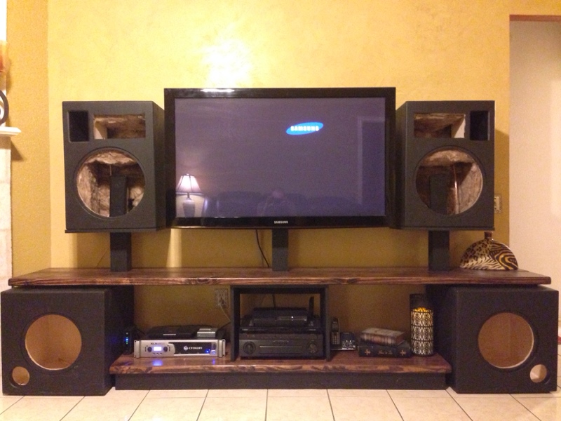

index.php?t=getfile&id=1417&private=0
Can't wait for the rest of the stuff to come in! Very Happy
Just waiting on the components and a couple cables now.
Note: it looks like the posts under the mains go through the bottom of the cabinets, but they don't. I just happen to have my HTIB speakers sitting inside the cabinets temporarily and they are the same size and color as the posts.
Re: New Pi 4 + Pi 3 Sub buildout [message #79430 is a reply to message #79422] Thu, 13 February 2014 08:09 Go to previous messageGo to next message
Messages: 44
Registered: February 2011
Location: Austin
Looking good, although i would want to try them sitting on the shelf. They would be positioned almost perfect for listening. I believe Wayne recommends roughly 15" off ground.
Re: New Pi 4 + Pi 3 Sub buildout [message #79431 is a reply to message #79430] Thu, 13 February 2014 09:56 Go to previous messageGo to next message
Messages: 31
Nick77 wrote on Thu, 13 February 2014 08:09
Thanks. I thought about that in my design -- originally they were supposed to be even higher. I may drop them down some more or eventually put them on the shelf like you said. I'm trying to compromise with my wife on the aesthetics so I can keep these in the living room.

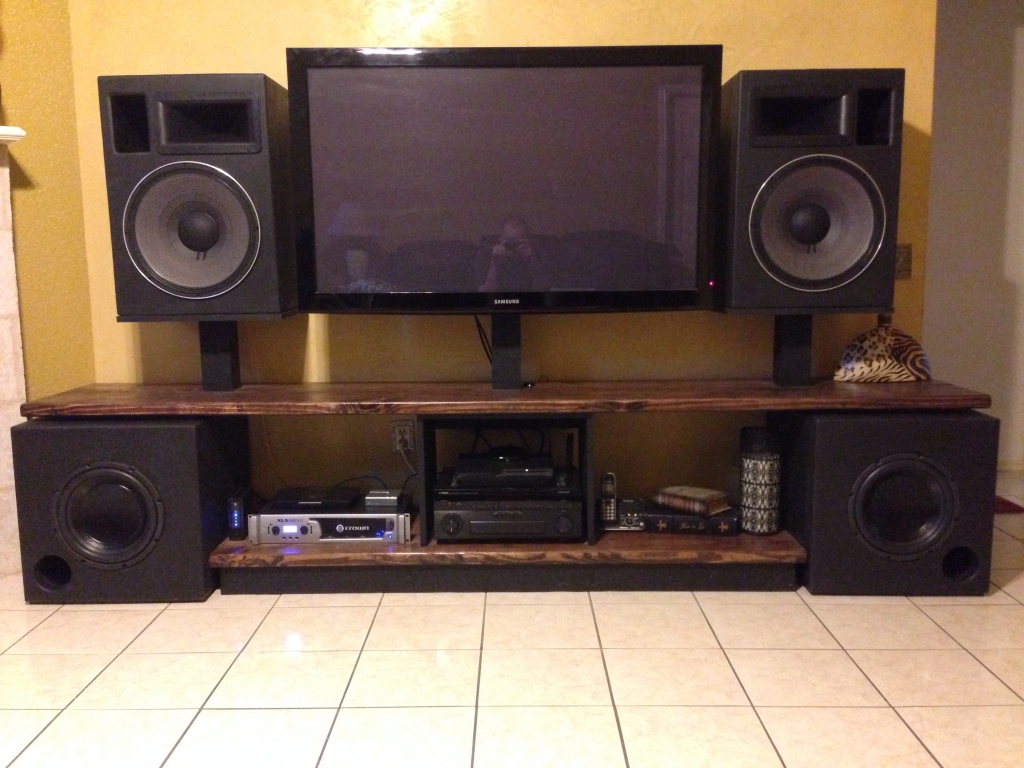

Anyway, here is an updated photo from when I called it a night. I installed the R13 and added a divider that also acts as a support to keep the shelf from bowing under the weight of TV and the mains.
index.php?t=getfile&id=1418&private=0
I'll probably build a 1pi for a center channel and put it right under the TV, and add four more in the future for full 7.2 audio.

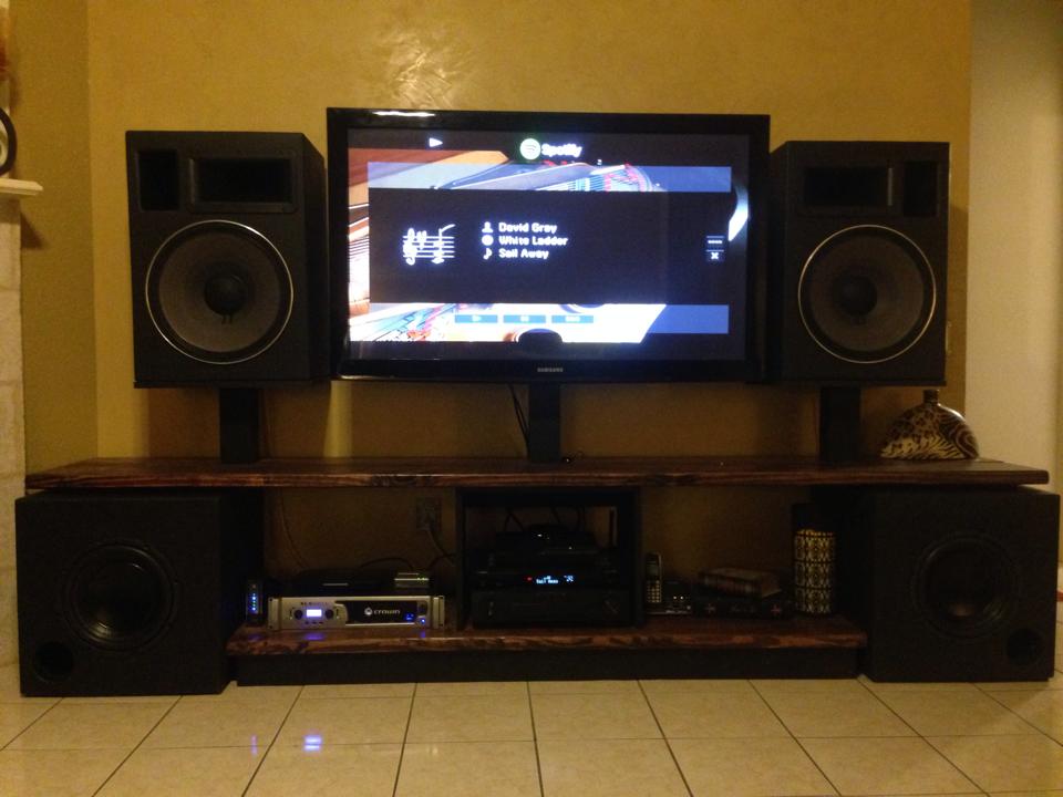

These sound amazing. I'll post a full review after a few weeks with them and playing with some different amp configurations.
I'm not really satisfied with my cabs, but that's another story and another time to fix.
index.php?t=getfile&id=1425&private=0
