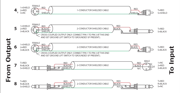

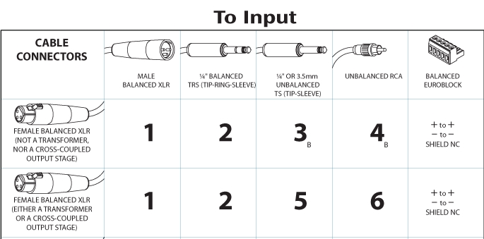

My next issue seems to be the balanced outputs of the Rane crossover. It looks like the easiest way to connect the balanced outputs of the Rane to my unbalanced Amp would be to have Blue Jeans Cable send me the correctly configured cables. Does anyone know if I should use #4 or #6 from the attachments?
index.php?t=getfile&id=1414&private=0
index.php?t=getfile&id=1413&private=0
Does this mean that I'll lose half my signal?
