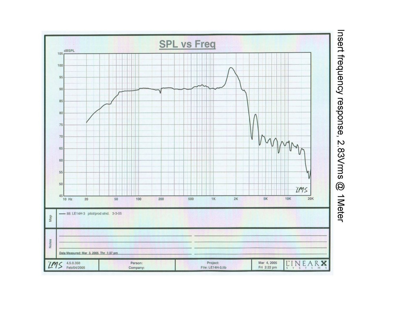

index.php?t=getfile&id=1412&private=0Here is a freq response I found for the JBL.
Looks like it will play high enough for the 2-way speaker I hope to build.

The freq resp in on axis for the LE14. No shure it would go higher than 500/800Hz, you would need a horn that goes lower. The dispersions need to be almost the same for the 2 components at xover point.
