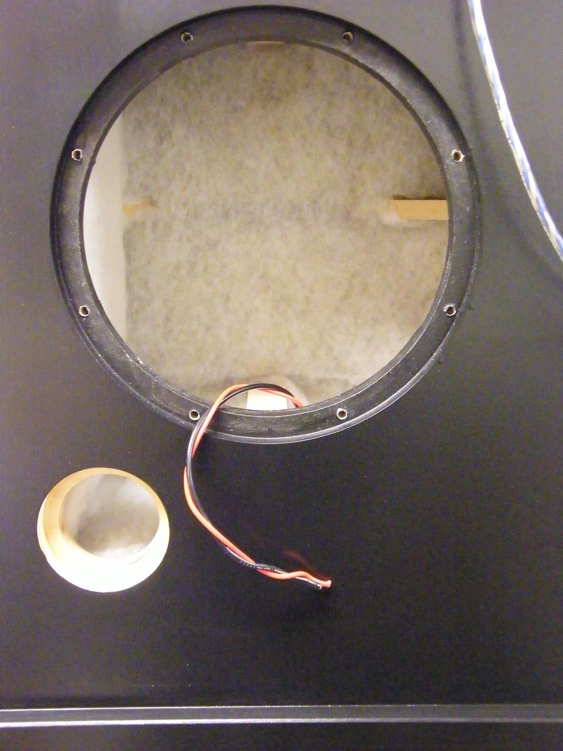

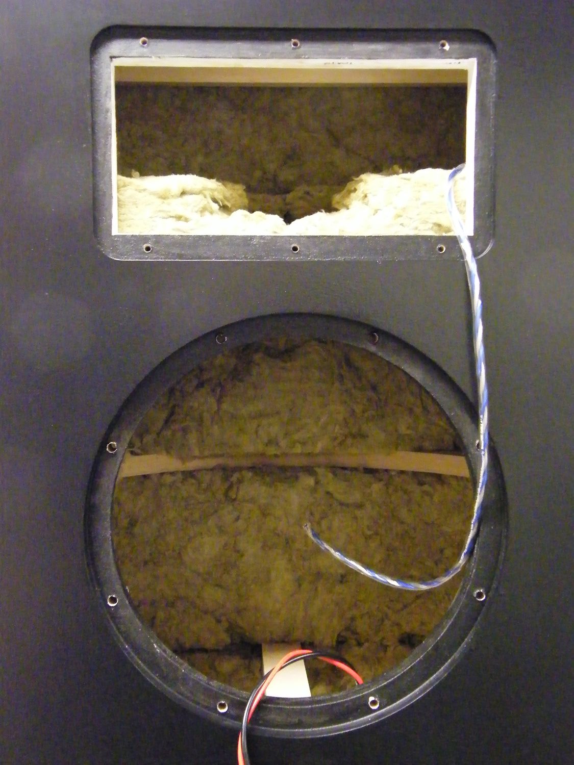

I next ran the wiring from the crossover up through a hole in the base. I sealed the hole with electricians putty on the bottom and silicone on the top. I used batt insulation on the backs, bottom and side nearest the port. I also placed a batt on the window brace between the horn and woofer. I covered the batts in the woofer section with a layer of quilt batting to prevent any fibres from getting out of the box. I remember demoing some speakers one time and the salesman decided to show off and play a track of some thunder at an extreme level. A big chunk of fibreglass blew out the port. Needless to say I didn't buy anything from them and have always wondered if any fibres are being pushed from a fibreglass insulated box in routine operation.

Batts in place. I cut away some of the insulation for the horn/driver to fit.
index.php?t=getfile&id=1403&private=0
Quilt batting added.
index.php?t=getfile&id=1404&private=0

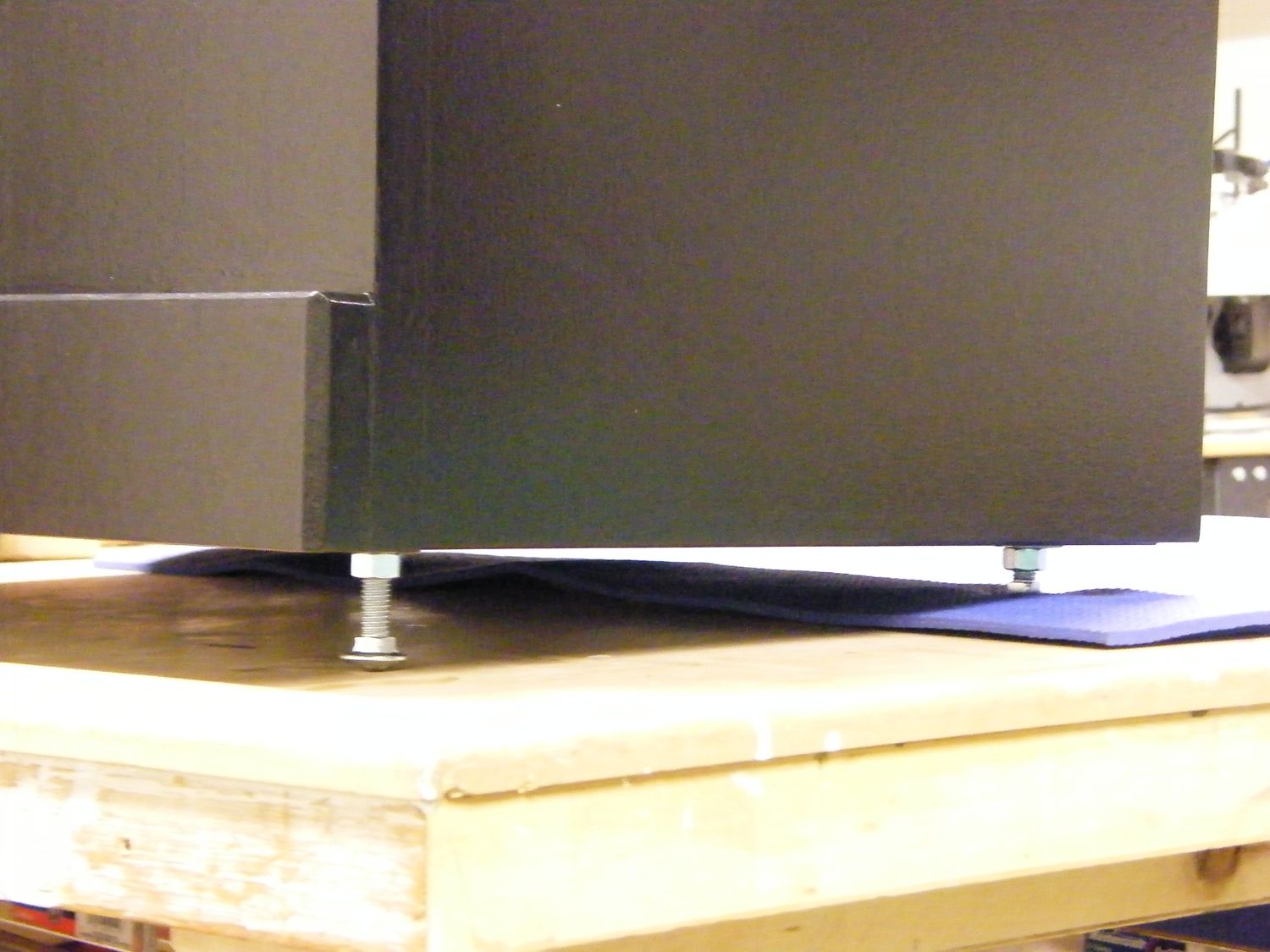

I also installed some "affordable" spikes. Carriage bolts, nuts and washers. In this case the size is 3/8". If you are doing something like this make sure you allow clearance for bolts to extend up into the enclosure. I set up the enclosures for a upward tilt of about 3/4" from back to front. This should get the sound up high enough to not need any stands.
index.php?t=getfile&id=1405&private=0
