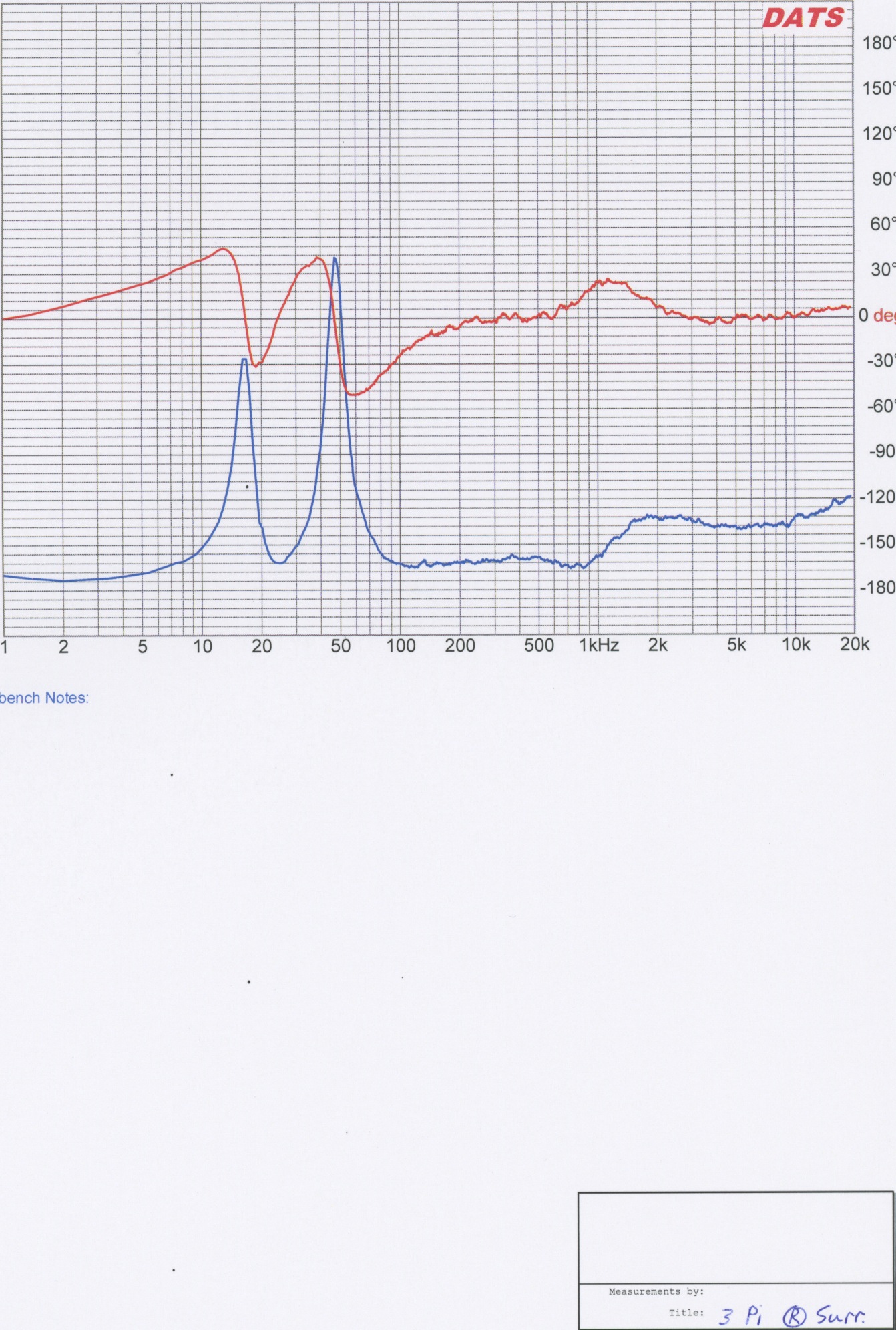

index.php?t=getfile&id=1369&private=0
The 3 Pi surrounds, slightly modified 3 Pi center and 6 Pi main loudspeakers in my home theater all use the AE TD12S. This evening the impedance of each was measured with a Dayton DATS system. The 3 Pi curves appeared to be essentially identical and, similar to the 6 Pi curves, reveal no discernable anomalies at the 750, 1500 or 2000Hz frequencies from the previously posted plot. The impedance graph from the 3 Pi right surround is included for review. The averaged 1 meter response curves on the tweeter axis for the 3 Pi and 6Pi show smooth midrange responses using the Dayton Omnimic. The room curves at 3 and 4 meters also lack any significant anomalies, the waterfall plots look good and the distortion through the midrange appears to be below the noise floor of the room (<0.5% at 95 dB/1 m). No evidence of cone breakup at all! These examples of the TD12S woofer range from less than one to about 3 years old and all demonstrated tight clustering of T/S parameters measured during the construction phase of the projects. The rough response posted doesn't correlate with my measurements or listening impressions. There is obviously a disconnect somewhere in all of this.
Re: 4012HO vs TD12S [message #78976 is a reply to message #78975] Fri, 17 January 2014 08:32 Go to previous messageGo to next message
Messages: 19066
I agree with you. Older model drivers are perfect, and I used them for years without issues. But four samples of recent drivers all measured as shown in the charts I posted above. My suspicion is that AE got a batch of cone assemblies that were different than what they used in the past, and exhibit the breakup we see above.
I'm not sure when this new cone batch first appeared on the scene, and John has not been forthcoming, so there's no really way for me to know how to identify versions of the TD12S driver by way of something like serial number or build date. It may not even be as simple as a "bad batch" of cones. It might be something else, altogether. All I know is my early measurements of TD12S drivers were good, but this last year, I measured four that were as shown above, and therefore best used below 800Hz.
Hey, just for reference, what does your driver's amplitude response look like? You remember the response charts of my three π speakers with TD12S drivers manufactured a few years back: Nice and smooth, nothing like the ones I measured last year. Are all of yours like that?
Re: 4012HO vs TD12S [message #78980 is a reply to message #78976] Fri, 17 January 2014 17:44 Go to previous messageGo to next message
Messages: 78
Location: Florida
The amplitude curves are very smooth with the 3 Pi at 1 meter. The new H290C tweeter and modified crossover seem to make almost no difference to the frequency response either. It is a shame if this is all just a bad run of cones, the TD12S is a significant improvement over the Eminence 12LFA.
