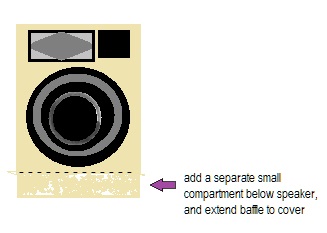

I definitely don't want to mess up anything having to do with the performance. I was re-reading my post and maybe I didn't explain myself very well. I just wanted to clarify that I don't intend to do anything to the dimensions of the speaker cabinet. I was wondering if adding a separate compartment below the baffle would have a negative effect.
index.php?t=getfile&id=1357&private=0
Re: 4pi Baffle length [message #78779 is a reply to message #78778] Thu, 26 December 2013 15:31 Go to previous message
Oh, I see what you're saying now. That's fine, no problem at all.
