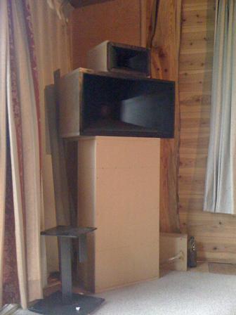

Well, FINALLY got the Pi 7 bass cabs built. Have been using JBL 4507 cabs since December last year- quite satisfactorily, I must say. Not knowing too much about acoustics, I was somewhat anxious that the reduction in cabinet volume would result in less extension or 'punch'. But, if both are tuned to the same frequency, then performance must be similar in that regard, right?
So, I did the experiment. Used two window braces above and below the woofer, port was simple and I was able to finish both (MDF was cut at the hardware store), in a day. Initial impression was the the bass had tightened up and was as smooth and full as with the 5 cubic feet cabs. Most notable was an improvement in midrange balance- NICE! Won't ramble on too much until I've become accustomed to the change.

Thanks for the update. Post pics, if you can!

'You want it? You got it!' (from The Kills Keep on Your Mean Side 2003.)
Crappy photo to camoflauge nasty MDF:
index.php?t=getfile&id=197&private=0
Re: 4 Pi and 7 Pi bass response- More similar or different? [message #63090 is a reply to message #63089] Mon, 07 June 2010 21:01 Go to previous messageGo to next message
Messages: 19101
Nice, looks great! Gonna veneer or paint?
