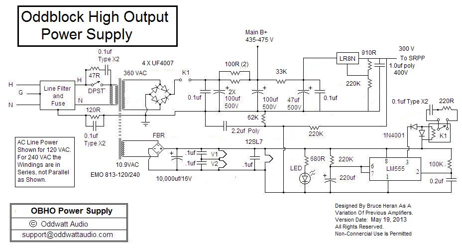

Where is the circuit diagram of PSU for KT 120?

Hi, I'm on the road at the moment and don't have the files with me. I'll get back to you Saturday or Sunday.
Re: KT120 Class A Push-Pull U/L Mono-Blocks [message #78435 is a reply to message #78428] Sat, 23 November 2013 20:02 Go to previous messageGo to next message
Hi, The PS is attached.

Hi The posted power supply is the one that is virtually identical to the earliest ones and is the current one used. Our kits are nearly identical to the diy posted projects. This is intentional as we want to make quality audio available to everyone without having to go broke in the process. We support both the commercial kits and the diy projects the same. Our experience is that because of skill differences some individuals like to source all the parts and build a custom version of our designs. At the same time there are many other individuals that do not have that level of skill or desire and for them we offer the kits.
So while there is an evolutionary process in the designs and some have significant improvements over a period of years, the KT120 amplifiers are mostly unchanged. The power supply they use is now common to all the large amps.
I hope this answers your questions, if not please write back.

Re: KT120 Class A Push-Pull U/L Mono-Blocks [message #78871 is a reply to message #78836] Fri, 03 January 2014 23:00 Go to previous message
Hi, Go to the diyaudioprojects.com forum on tubes. There are numerous comments. Also on Oddwatt amps in the same section. As for difficulty they are rather easy to build and trouble free. The KT120 mono blocks weigh about 30 pounds each when you use the recommended transformers. Since the amps were designed aroung those particular transformers the use of others may (or may not) compromise various aspects of the performance and stability.
