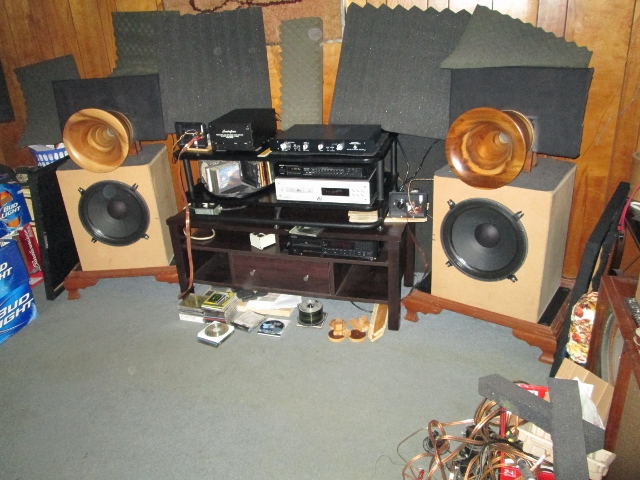

Re: I'll see your 4Pi Feet and raise you 2Pi Tower Wheels [message #78399 is a reply to message #78390] Mon, 18 November 2013 12:41 Go to previous messageGo to next message
spkrman57
Messages: 522
Cmon Bill!
You big spkrs are like my little spkrs!
I can't wait to get cabs built for my 1501Fe's. Approx 4.2 cu ft tuned to 32Hz per JBL (4365 system).
They are like 2226's but with lower bass response and just slightly less spetacular midbass/midrange response. And 4 db less efficient.
Right now they are in 3 cu ft tuned to 36 hz.
You will have a reason to come to Ohio and listen to them.
Sorry for hijacking your thread!
Ron sends...
index.php?t=getfile&id=1344&private=0
Re: I'll see your 4Pi Feet and raise you 2Pi Tower Wheels [message #78402 is a reply to message #78399] Mon, 18 November 2013 15:22 Go to previous messageGo to next message
Still using those Salad Bowls I see.
Who's building your boxes?
Re: I'll see your 4Pi Feet and raise you 2Pi Tower Wheels [message #78433 is a reply to message #78402] Fri, 22 November 2013 13:20 Go to previous message
spkrman57
Messages: 522
Bill,
Yeah, I love the round wooden tractix Edgarhorns.
I have tried Yuichi horns and other non-round horns and just can't give up the 3-D holographic imaging!
These are the 350Hz and x-over will be approx 700hz to 1200hz to be determined as I go. I'm using a dbx driverack Pa + and 300B SET on the horns(2445/Be).
SS Mosfet amps Adcom 555 II or Soundcraftsman "shoebox" PM-860. Both amps are 200 wpc for the 1501Fe's.
My cab builder is one who likes to remain anomymous. I have several cabinets that he built and they are solid and dense with no box sound!
Regards, Ron
