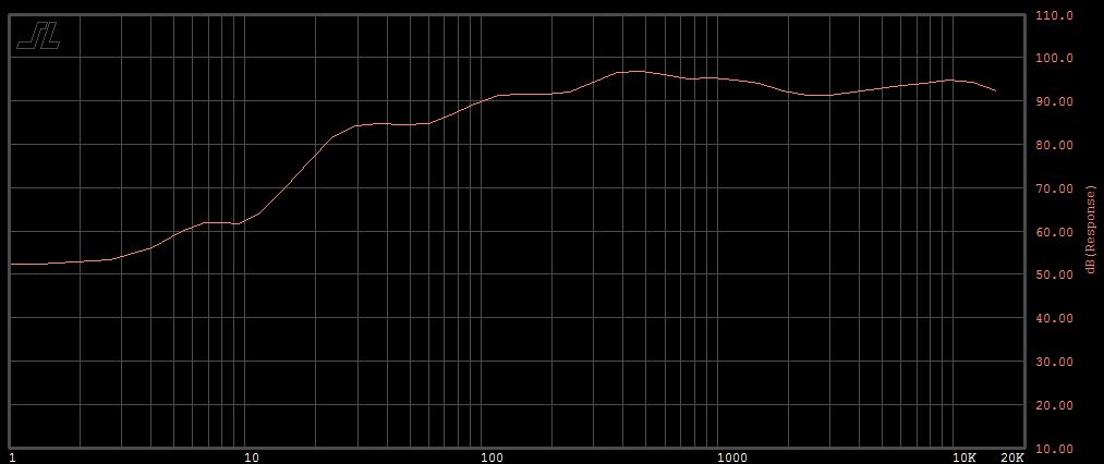

Btw, is there any fresh review of 3Pi speakers with Eminence Definimax 4012HO by now? Would be interested to know what is the difference and how close is to JBL 2226H sound wise, also it would be nice to see new measured response from updated speaker if possible.
Re: PSD2013 [message #78347 is a reply to message #78346] Tue, 12 November 2013 14:42 Go to previous messageGo to next message
The three Pi speaker with Definimax woofer has an EBS alignment, so it sounds gently rolled off down low. It isn't so pronounced that it sounds weak without subs, but it definitely sounds better with them. That's fine, it's all part of the design philosophy. I do not incorporate BSC into my speakers because they are intended to be used with flanking subs anyway.
http://www.pispeakers.com/Measurements/threePi_Definimax_response.jpg
three π loudspeaker with Definimax woofer
In the response curve above, you'll notice the baffle influence on directivity starting around 200Hz. This is the upper range of helper woofers, and augmentation using flanking subs is my preferred method of dealing with that. You'll also see the EBS in the octave from 50Hz to 100Hz. Flanking subs will help provide extension in this range too.
There is usable response very deep from this speaker, so it provides a good deal of energy for blending with helper woofer / subs to provide modal smoothing. Or in cases where it is used without subs, it has enough low frequency output that the deepest notes are definitely heard. But again, while the speaker sounds pretty good without flanking subs, I think it definitely sounds better with them.

Hi Wayne,
Thanks, great info!
Just to clarify, this is measured in free space or actual room response?
Re: PSD2013 [message #78349 is a reply to message #78348] Tue, 12 November 2013 17:18 Go to previous messageGo to next message
That measurement was made outdoors.

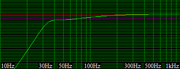

Just had a look at the Definimax in my abandoned (well, I feed the cat up on top of them Very Happy ) 3 Cu Ft Utah 12" boxes from last year.
index.php?t=getfile&id=1342&private=0
That's with adding a 4" port 6" deep, tuned to 35.47 Hz; an hours work. Hmmm.
