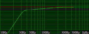

Just had a look at the Definimax in my abandoned (well, I feed the cat up on top of them Very Happy ) 3 Cu Ft Utah 12" boxes from last year.
index.php?t=getfile&id=1342&private=0
That's with adding a 4" port 6" deep, tuned to 35.47 Hz; an hours work. Hmmm.
  • Attachment: 3Pi Clone.bmp
    (Size: 198.02KB, Downloaded 4636 times)
