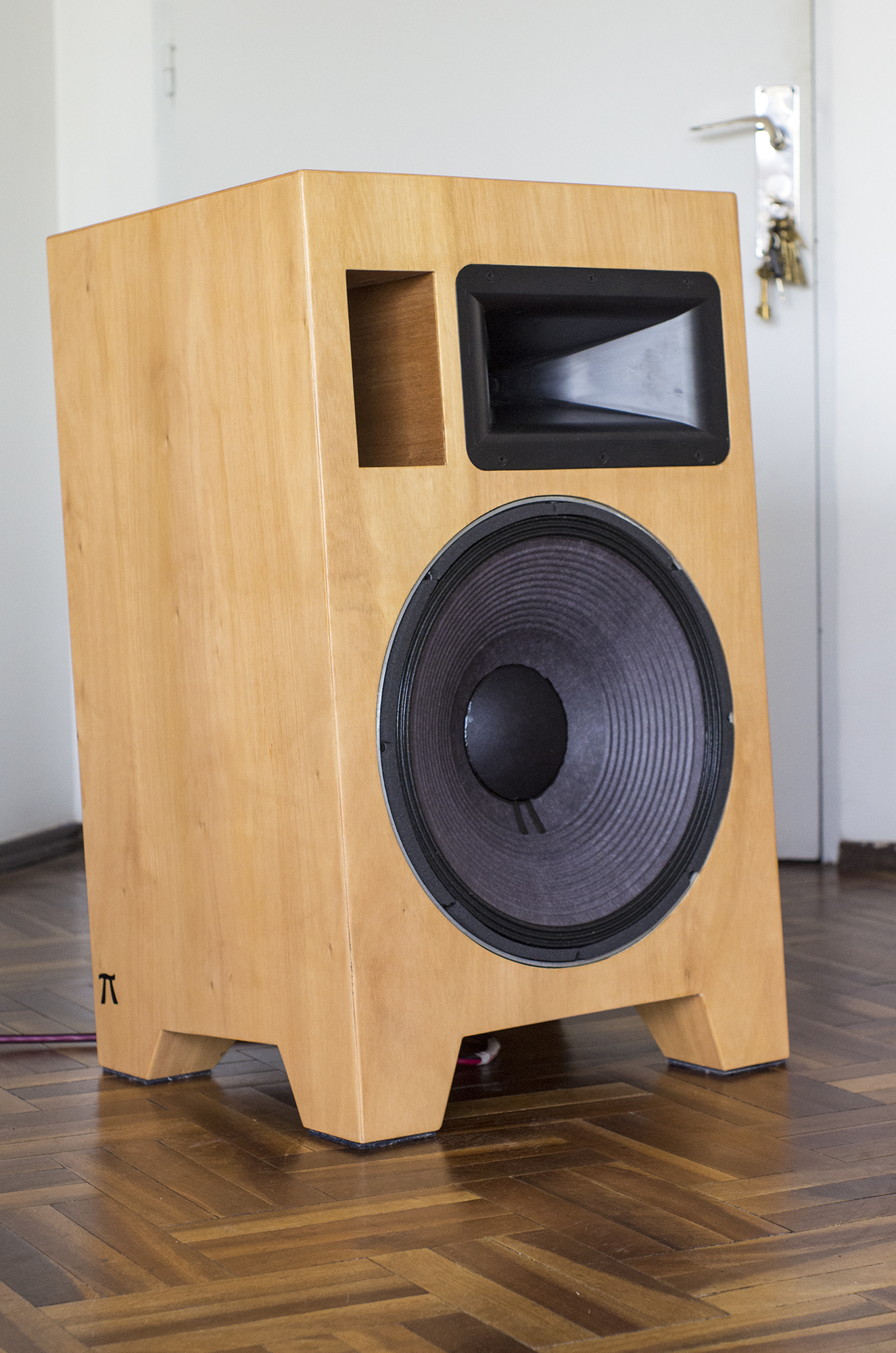

One last take with the reconed woofers.
index.php?t=getfile&id=1339&private=0
  • Attachment: 4Pi_photo.jpg
    (Size: 1.54MB, Downloaded 9333 times)
Re: 4Pi with feet [message #78335 is a reply to message #78333] Sun, 10 November 2013 15:06 Go to previous messageGo to next message
Looks really great!
Re: 4Pi with feet [message #78385 is a reply to message #78335] Sat, 16 November 2013 21:34 Go to previous messageGo to next message
Duncan McBride is currently offline  Duncan McBride
Messages: 41
The cabinet design is inspired. Well done.
Re: 4Pi with feet [message #78389 is a reply to message #78385] Sun, 17 November 2013 18:17 Go to previous messageGo to previous message
Messages: 43
Registered: October 2013
Thanks Duncan. I ordered some parts to make the grills, the magnets won't be invisible but I hope they look good. The grill cloth will be a black VOX cloth.
