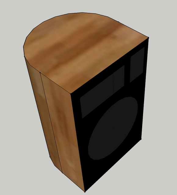

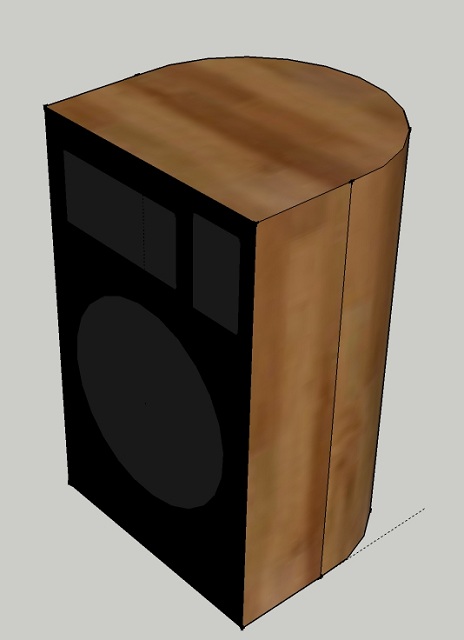

If I just make the speaker round and keep the volume and other parameters, is it less chance for ruin the construction sound vice ? (I guess we will not know before it is made and measured)
Made a simple sketch

That's a neat looking cabinet, but you will still need to analyze standing wave modes, and then verify with measurements afterward.
