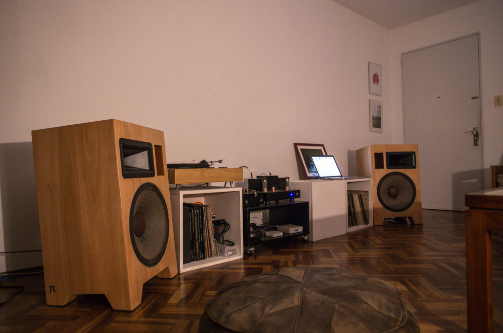

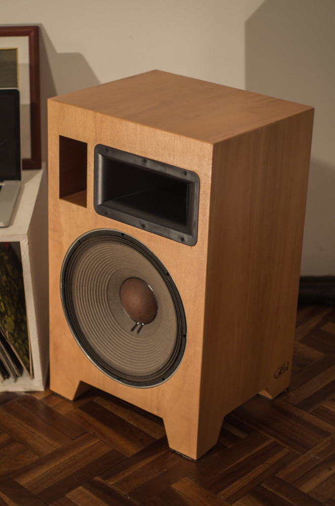

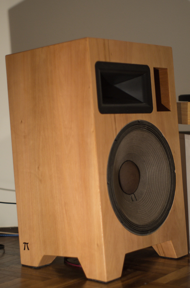

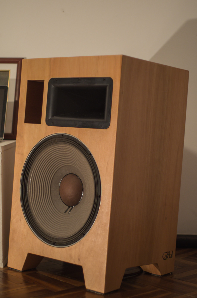

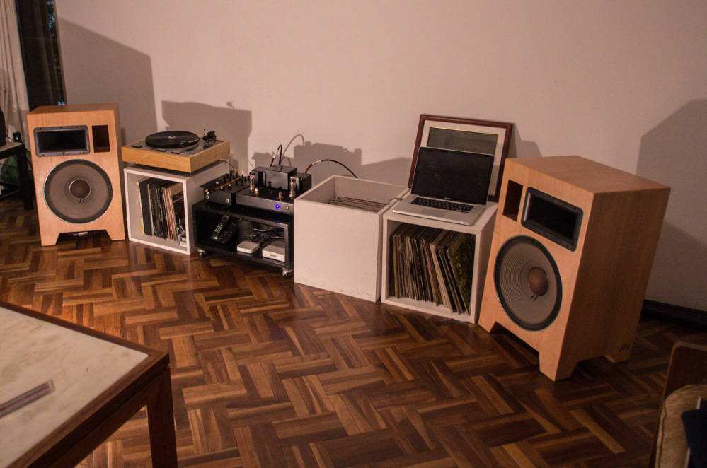

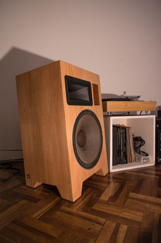

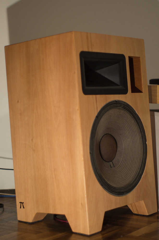

They are breaking in? Or something happened.
I changed the cables to a better one, I'm not really a cable fan, but maybe is this?
They sound great, amazing, better than anything I had before. They are truly record dependant, I hear from tom waits to kusturica, some jazz, some modern (james blake...) It depends on my humor.
Some records have great tight defined bass with great extension, some others lack it. I'll listen to them for some weeks, and then try less insulation. This way they sound great, better that I expected.
This photos are from now, its quite late so I have bad light, on the weekend I'll post some nice shots, I used to be a photographer...

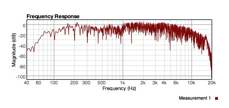

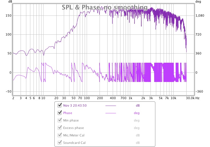

Some numbers, I made this graphs with REW 5.0 and the laptop internal microphone, so I guess its not very precise, what do you think about this?
Any way I can measure them without expensive equipment?
index.php?t=getfile&id=1330&private=0

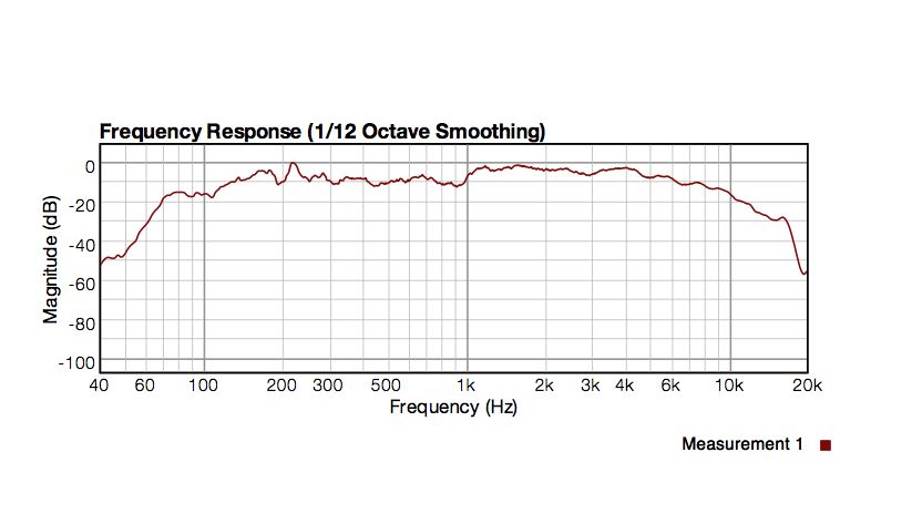

Then I made this other graphs with Fuzzmeasure, again with the crappy internal mic of my laptop. With and without smoothing.
index.php?t=getfile&id=1331&private=0
index.php?t=getfile&id=1332&private=0

It's a little hot above 1kHz. I'm not completely comfortable with the measurements because the graphs show more top-octave rolloff than I would expect and that's common with uncalibrated measurement systems and microphones.
But then again, putting aside the top-octave rolloff, the chart looks about right except for that amplitude shift at 1kHz. So that makes me wonder if the woofer is a little low or the tweeter a little high.
What compression driver are you using? What resistor values are installed in positions R1 and R2? Are you sure your woofers have genuine JBL cones with 8Ω voice coils?
Re: 4Pi with feet [message #78274 is a reply to message #78127] Sun, 03 November 2013 23:07 Go to previous messageGo to next message
Messages: 43
Registered: October 2013
The compressor is a B&C DE250, the XO is the one you sent me (by mail you said it was made for the B&C, but I didn't check it). I bought the JBL used and I don't know if they were reconed, maybe you can know looking at the pictures.
I'm finding them a little fatiguing after some hours. But the place were they are is not the best.
Re: 4Pi with feet [message #78275 is a reply to message #78274] Mon, 04 November 2013 00:28 Go to previous messageGo to previous message
I'm not really sure what compression driver you listed in the notes on your crossover order, but I can check tomorrow. Then again, that doesn't matter really - Please double check the values installed on your boards. The R2 resistors (four closest to the edge of the board) should all be 16Ω values and the R1 resistors (next four in) should be 20Ω and 30Ω values. Please verify that.
If the R1/R2 values are right, then I know what your tweeter SPL is, and that leaves only the woofer. You can't tell the condition of the woofer by looking at it - Some third-party recones look very much like OEM parts, but they're not. Some are really bad, to be honest, with horrible breakup and other nasty things. Yours don't look that bad, but they do look like they are less sensitive than they should be, by about 6-8dB from your charts.
I'd like to see absolute SPL values, as measured on an LMS system at a known distance and drive voltage. I'm sort of assuming the compression driver is good, since it's a new part. Under that assumption, I can sort of use the tweeter as a baseline, since I know what it does. I suppose it is possible that the compression driver is abnormally "hot", but I find that extremely unlikely. And even if the R1/R2 values were set for the PSD2002 instead of the DE250, that would only explain 2dB shift, not the level we're seeing in your charts. So I am leaning towards woofers being out-of-spec at this point.
