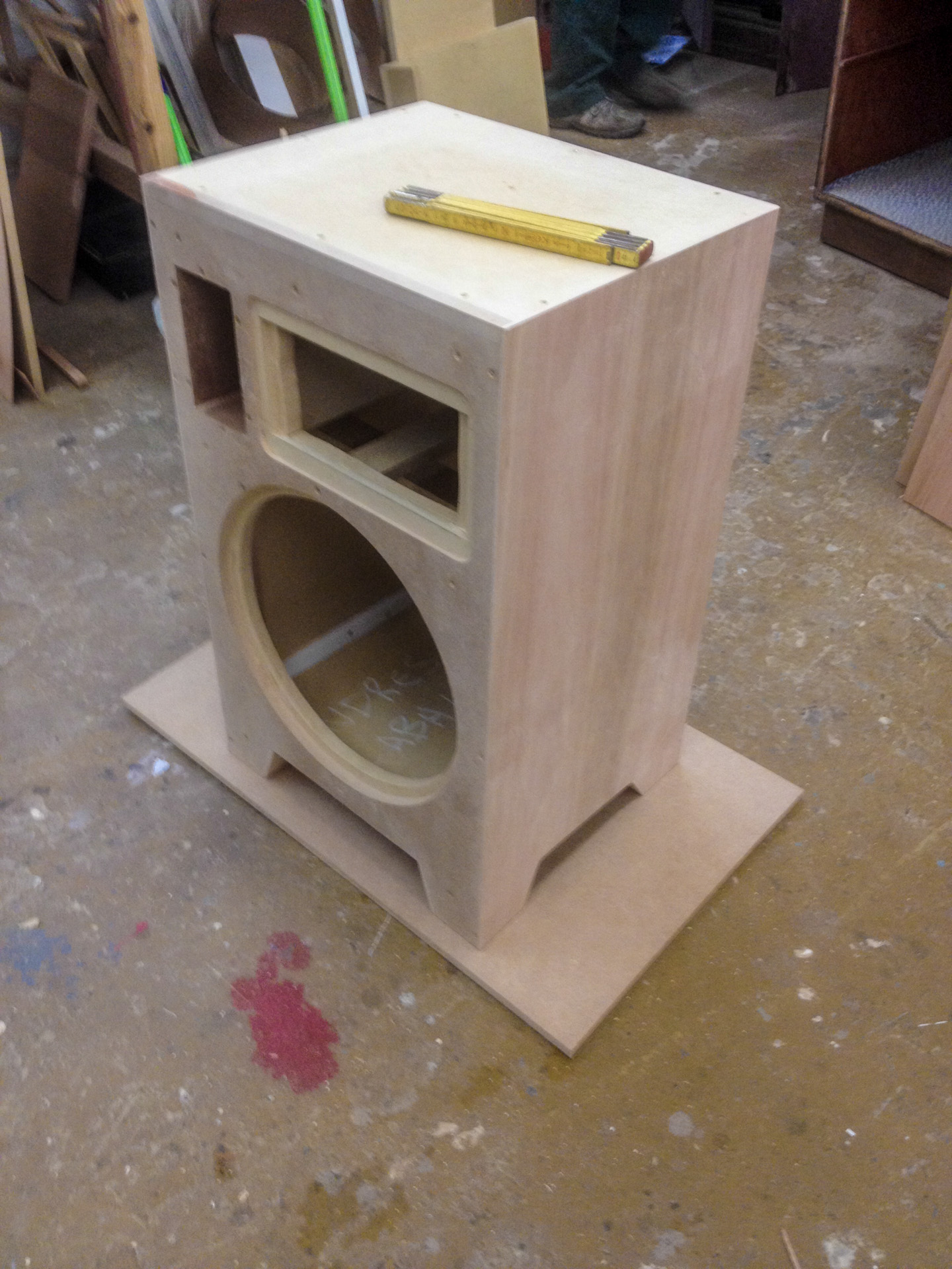

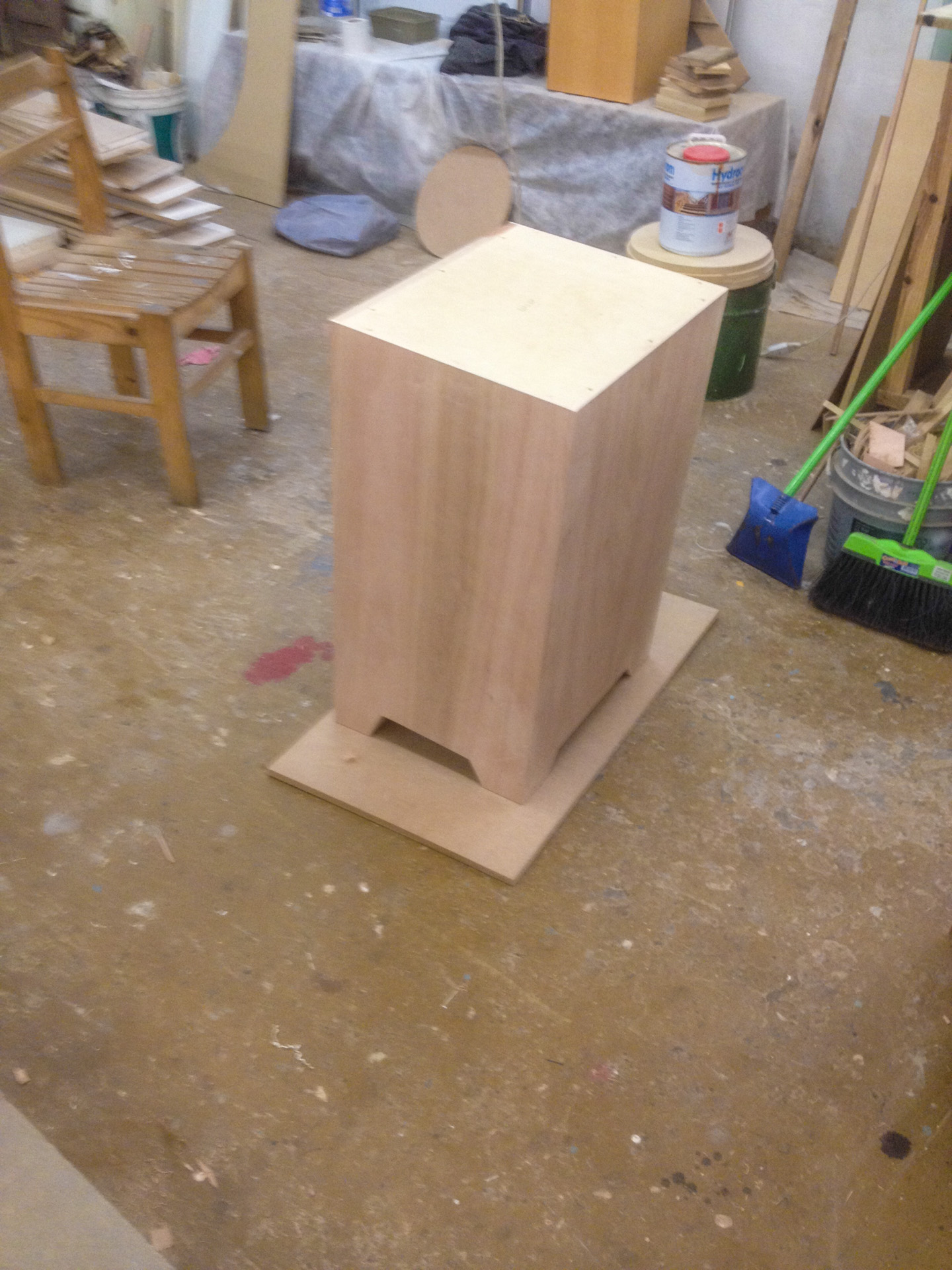

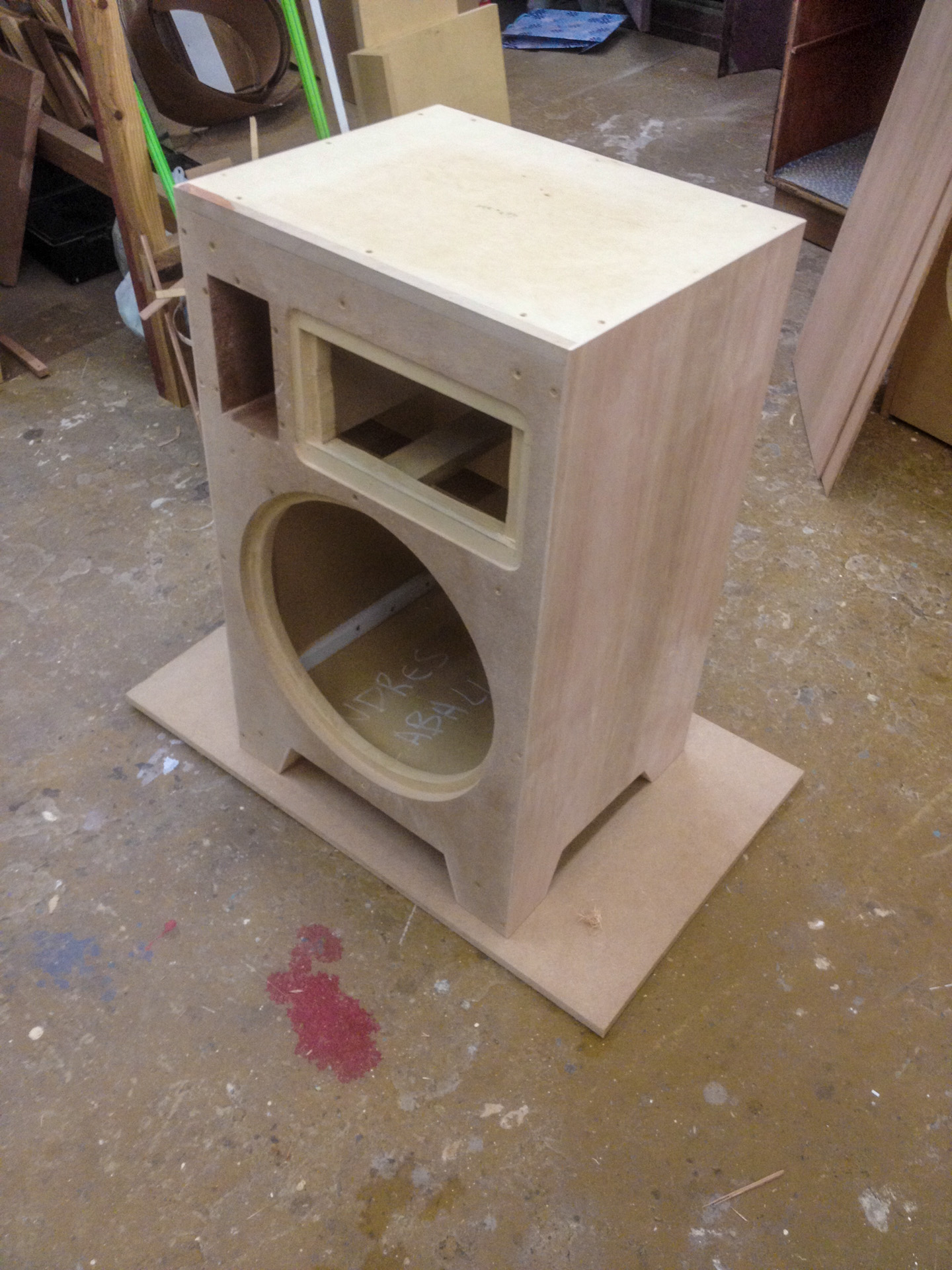

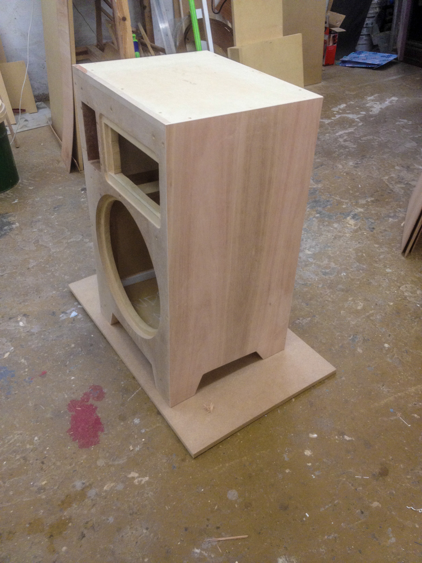

Hi,
This is my first post here, I've been emailing Wayne for a while for my 4 pi project, and now i'll show some of the work i've done.
I've followed Wayne's plans, and used JBL 2226h woofer/mid and b&c de250 comp. tweeter. I modified the bottom of the speakers adding some MDF solid feet and made the front face thicker to cover the woofer.
I hope you like it, the photos are quite bad, as my iphone is quite destroyed. Next week I'll post some photos with a better camera.
BTW, thanks you all in the forum for all the info posted here Smile
Lucas.
index.php?t=getfile&id=1281&private=0
index.php?t=getfile&id=1282&private=0
index.php?t=getfile&id=1283&private=0
index.php?t=getfile&id=1284&private=0
index.php?t=getfile&id=1285&private=0
index.php?t=getfile&id=1286&private=0

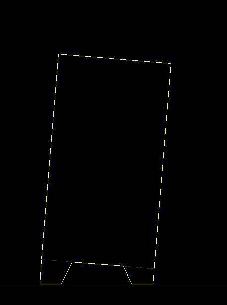

Re: 4Pi with feet [message #78135 is a reply to message #78127] Thu, 17 October 2013 20:46 Go to previous messageGo to next message
Is that way cool parallax in Pic #4 or did you build in a tilt?
Excellent casework!
Re: 4Pi with feet [message #78138 is a reply to message #78135] Thu, 17 October 2013 21:46 Go to previous messageGo to next message
Messages: 43
Registered: October 2013
Thanks Bill!
The feets on the front are taller than the ones on the back. So the speakers are tilted 5 degrees, its subtle, but it works great in my room. And I liked how they looked tilted!
By making this gap with the floor, I can install the binding posts on the bottom of the speakers, hidden
Here is a side view of the speaker:
