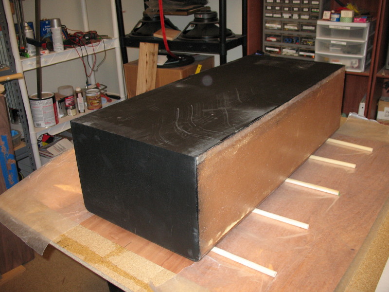

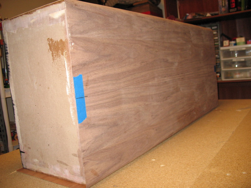

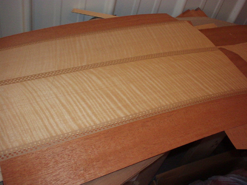

I have a half-gallon of Titebond II left over from my 2Pi Towers you can have Rolling Eyes iron-on veneering was a disaster for me! "Bubble, bubble, toil and....."
Cold pressing with Urea Formaldehyde PPR is still the king of glues, especially with multi-leaf glue-ups.
index.php?t=getfile&id=1245&private=0
index.php?t=getfile&id=1246&private=0
Requires a lot of clamps, a lot of time and making cauls and platens to cover each side as you clamp it up....or invest in a vacuum bag press system.
Next best is contact adhesive with NBL veneer. Use a 6" long piece of soft pine 2x4 to press out (press hard!) the veneer after mating the surfaces. Contact also works just fine for curved cabinet edges.

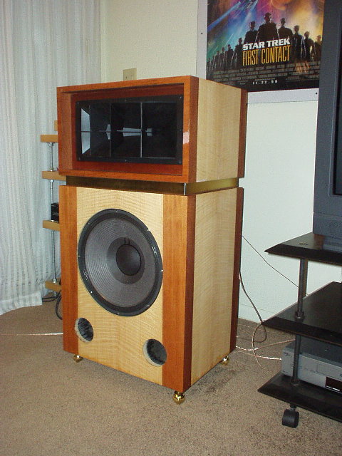

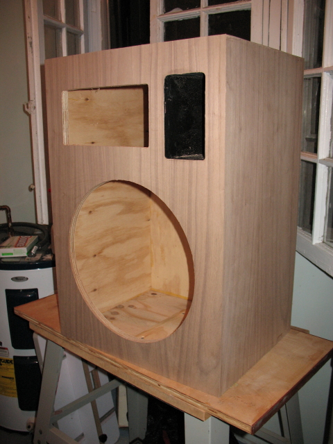

For the weekend DIY'r this is the best. My 4Pis have no issues 5 years later.

I had to look up NBL. Those 4Pis are inspiring, Bill. Now I need to add a room to the house. Thanks, man.
