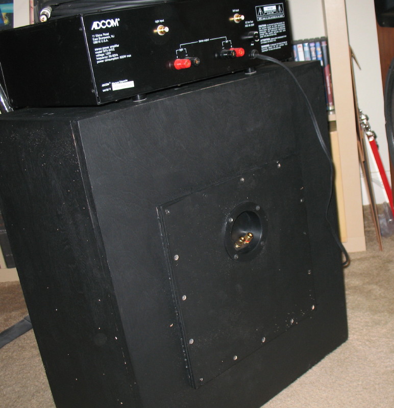

Some may remember I long ago cut down the BatSpeakers
index.php?t=getfile&id=1239&private=0
and installed the 15" Dayton Classics with mis-matched plate amps.
index.php?t=getfile&id=1240&private=0
Last year one amp quit and I hadn't been happy with the other from the start so left the subs out of the system 'til now.
With all the rain we've had this year I've spent a lot of time listening and thinking...thinking about what to do with the Adcom 545 I picked up cheap as a "Summer amp" but really didn't enjoy listening to. Then...(envision light bulb)
...acquired a cheapo 130Hz Dayton dual coil subwoofer crossover, cut it in half, installed each half in a sub, buttoned up the plate amp hole and installed a terminal.

Figuring there might be a SLIGHT mis-match between the 1.8 Watt 45 Amp and the 150 Watt Adcom Laughing Laughing Laughing Laughing Laughing,

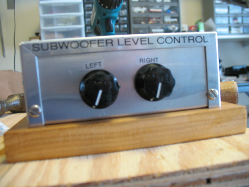

I built a level control with a pair of Alpha 10K mono pots and a $4 Radio Shack project box.
index.php?t=getfile&id=1243&private=0
Subs are playing nicely with the 4Pis which is especially gratifying 'cause my "pre-amp" is passive; the level controls make the combo work.
A new pair of plate amps would have been $250 and hum is always an issue with them. I spent less than $50 bucks over what I already had in the Adcom and parts drawer RCAs, etc.

but it's great getting all the notes down to 27Hz or so.

I thought I might be going overboard building four 15" sealed subs. My sub amp is switched with my processor, so it's easy to play music or video with the main amps off (and speakers silent).
The subs just rumble and thump somewhat quietly and don't seem to be doing a lot. But once the main speakers come online, the sound is full and amazing. Kill the sub amp and the life just drains out of the system.
Multiple subs, loping along not breaking a sweat, do wonderful things to the sound.

BTW, if anyone is interested in the level control, don't forget to tie the input and output grounds together. I did at first and heard HUMMMM!
