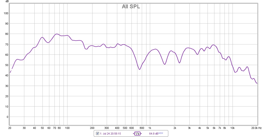

Re: 4Pi crossover study [message #77283 is a reply to message #77257] Wed, 24 July 2013 20:09 Go to previous messageGo to next message
Joe Sever is currently offline  Joe Sever
Messages: 11
Not out of the woods yet.
Here's 20-20K on the standalone USB mic. The downward trend from ~7K-20K is clearly there:
index.php?t=getfile&id=1222&private=0
So I'm starting to feel more confident of - but more discouraged by - the previous measurements.
Once I scare up some way to mount the other CD I'll see how it measures.
  • Attachment: samson.jpg
    (Size: 101.75KB, Downloaded 4296 times)
Re: 4Pi crossover study [message #77284 is a reply to message #77283] Wed, 24 July 2013 21:10 Go to previous messageGo to next message
Interesting. The response from the SEOS12 is as I would expect between 1kHz and 6kHz, but above that, it has more rolloff than it should have just from mass. There's 20dB drop from 6kHz and 10kHz, more than 18dB/octave. This would only happen if voice-coil inductance and the front chamber conspired to rolloff at the same point, and they're usually staggered, with mass starting around 4kHz, inductance around 12-16kHz and front chamber just above that.
Could be that the phase plug is blocked with debris, or maybe the diaphragm is misaligned. You might open the compression driver and check it out. Sometimes just taking it apart and putting it back together fixes that kind of thing.
