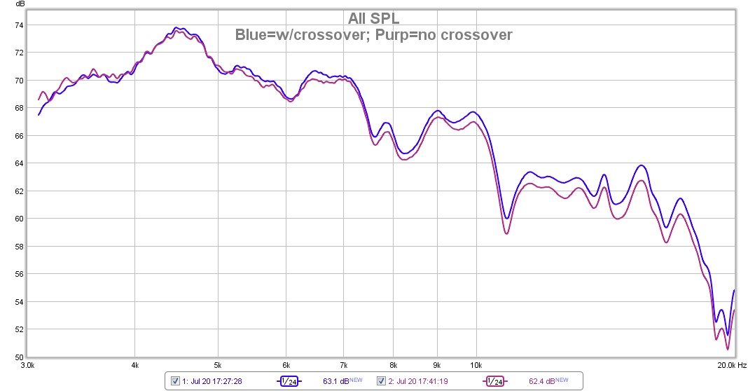

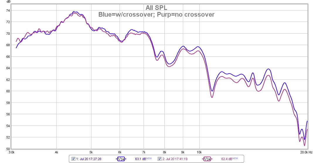

This time I measured with the speaker on its back, and the mic directly over the Radian's diaphragm about 19" away.
I took two measurements: one through the unmodified crossover, and the other directly from the amp to the speaker. The measurements were the same!
index.php?t=getfile&id=1214&private=0
So either I've miswired the crossover, or my measurement setup is faulty. Unfortunately I don't have any other speaker available for reference, otherwise I'd measure it.

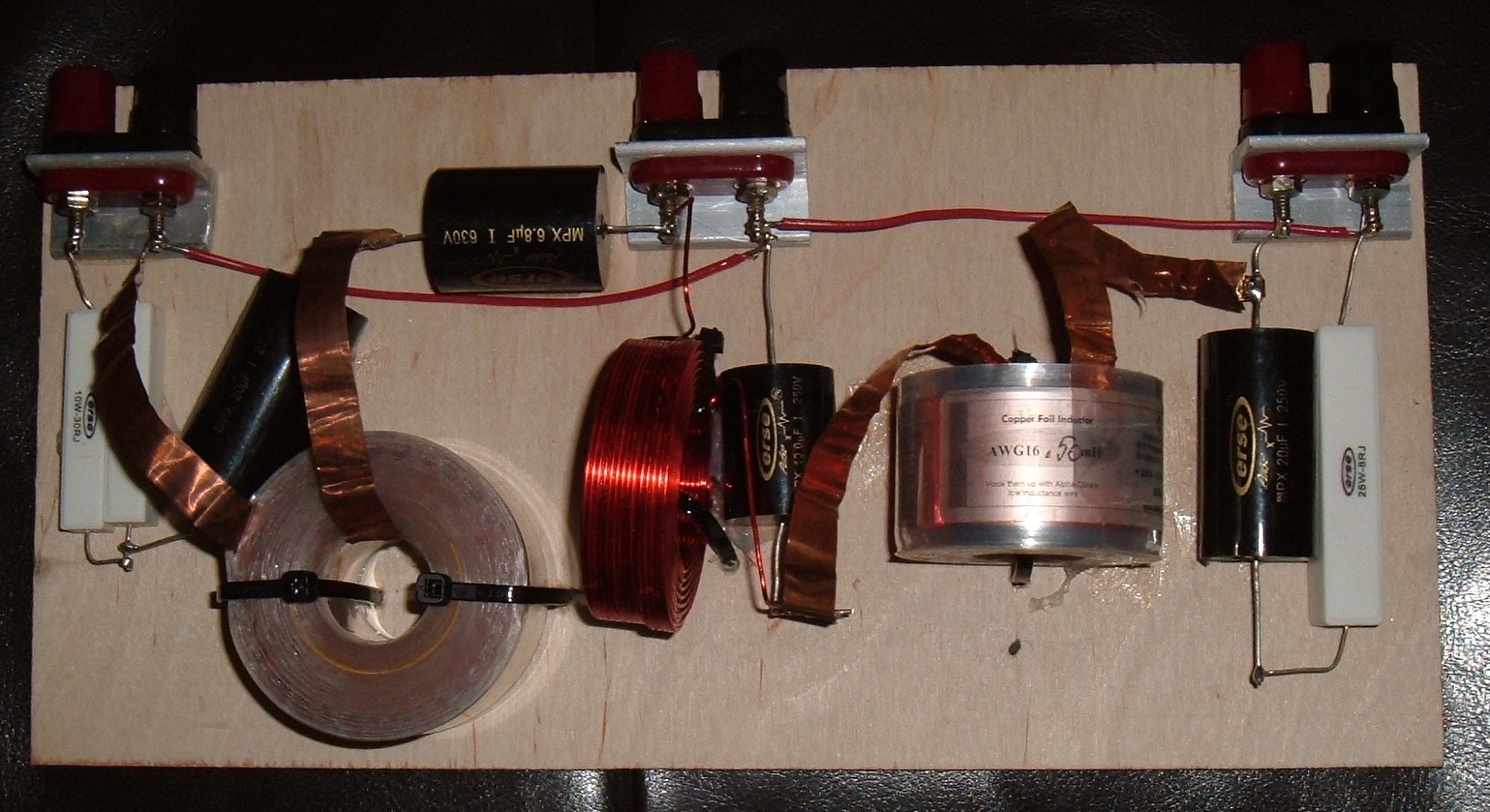

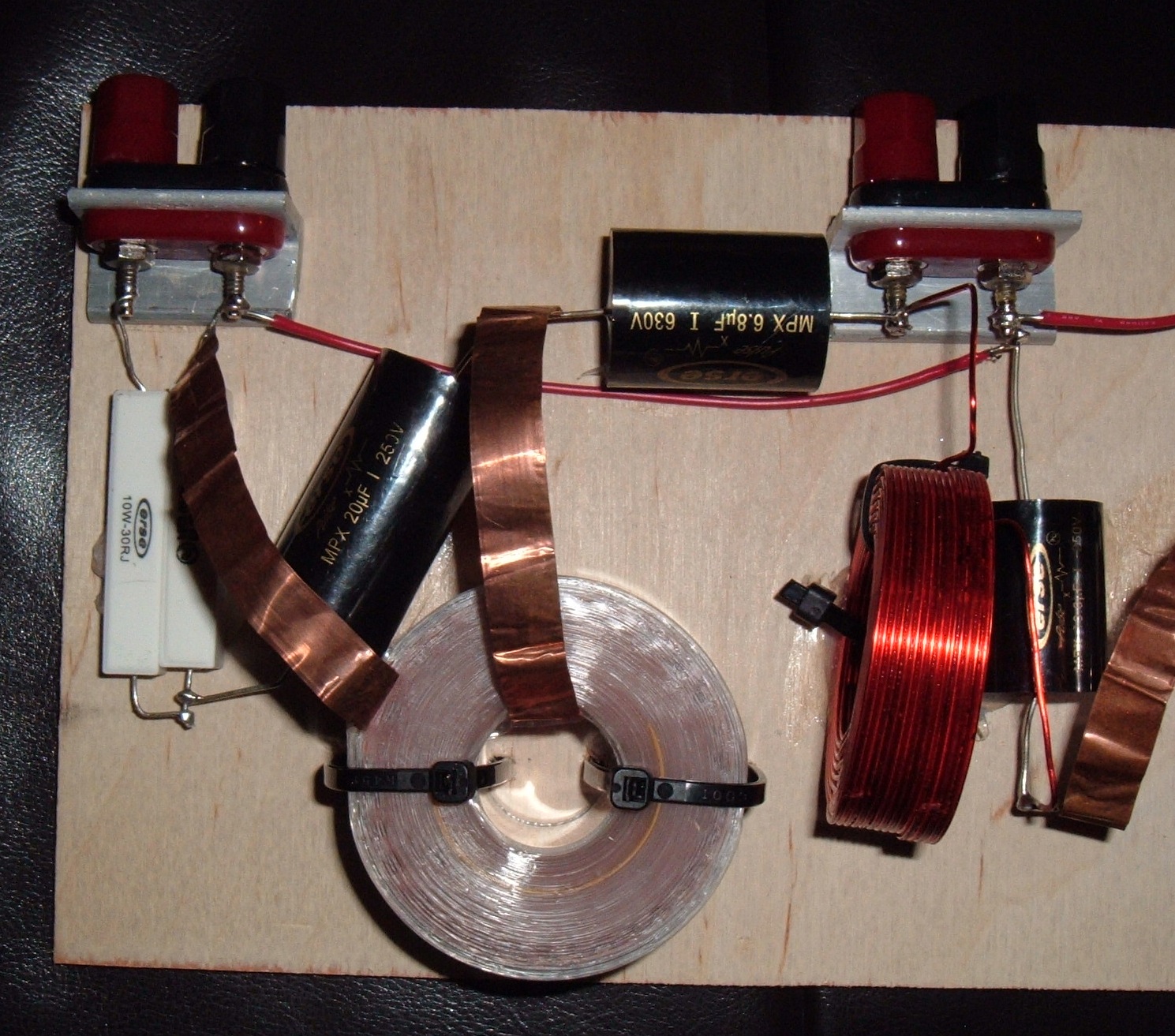

Though I suspect the measurements themselves at this point, here's the crossover for scrutiny:
index.php?t=getfile&id=1215&private=0
index.php?t=getfile&id=1216&private=0

As an extra sanity check, make a noise floor meaurement, i.e. one where no sound is made. See what that gives you. You might also try taking measurements of the speaker in way-off states, like muffled by a pillow, through a small value cap that tips up the response, etc. See if you can see those kinds of large changes.

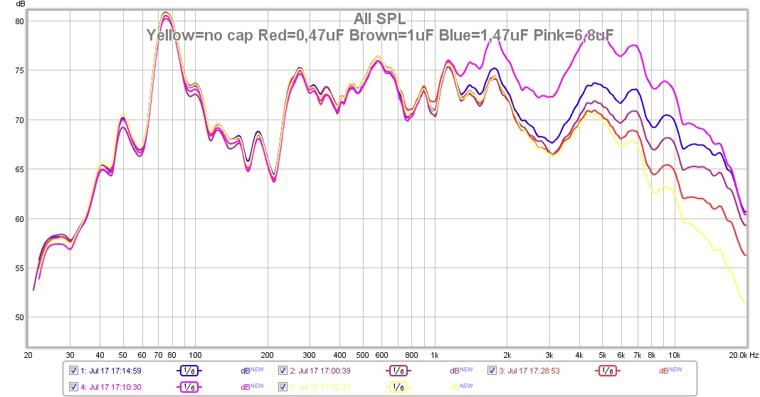

Not exactly what you suggested, Wayne, but I did see some movement when trying different values in the C1 position:
index.php?t=getfile&id=1217&private=0
