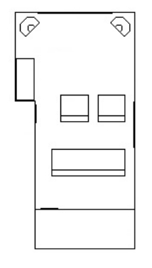

Hi Wayne,
Thanks for the 7PI plans. I didn't want to keep cluttering up the Helper Woofer thread with more 7PI stuff, so I started a new one.
Here's what I ended up with for the room layout with the 7PIs. I think the scale is pretty close.
index.php?t=getfile&id=1201&private=0
As you can see the screen blockage is pretty minimal and should only affect the seats on the right side of the room. I am a little worried about the desk on the left side though. It's only about 4' from the corner and is nearly 2' deep. I don't know if it's a problem for high or low frequencies, but I could cover the side closest to the speaker with some thick cotton batting if it helps.

The room layout looks good. The desk won't hurt, at least not at bass frequencies. It will have more impact at higher frequencies, being a reflective surface. Not sure how much impact it will have, but I know it would be the same for any speaker you put in that same general area.
