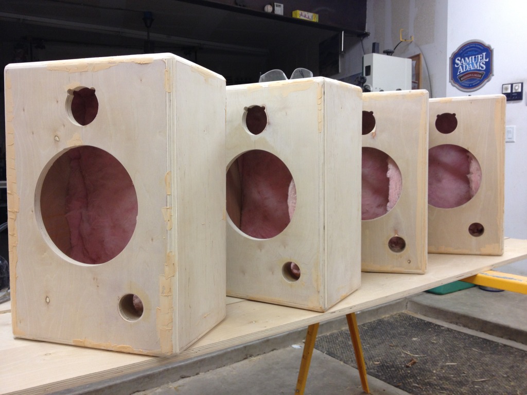

Teaser shot here. I'm making good progress on the project.

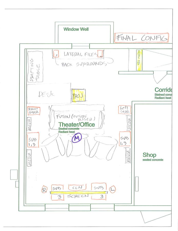

Here's a layout of my room. Current side surrounds are old B&W towers, the rears are bookshelf speakers on top of two drawer lateral file cabinets.
index.php?t=getfile&id=1188&private=0
I was planning to wall mount the 2π surrounds in the same locations, but at 6' or so above the floor angled slightly downward.
Re: Pete's Home Theater Build [message #76970 is a reply to message #76966] Thu, 06 June 2013 18:54 Go to previous messageGo to next message
Messages: 19101
I can certainly see why you want six π cornerhorns for mains. That room is perfect for them.
Are you planning to put the side surrounds on the subs? Or maybe hung on the walls above them? Looks like that's where they would work best.
Re: Pete's Home Theater Build [message #76978 is a reply to message #76970] Fri, 07 June 2013 12:42 Go to previous messageGo to next message
Messages: 76
Registered: June 2011
Location: Albuquerque, NM USA
I'll be mounting the surrounds on the walls with the bottom of the cabinet at about 5'. I'm going to play around with placement before I build the wall mount brackets.
Re: Pete's Home Theater Build [message #76979 is a reply to message #76978] Fri, 07 June 2013 13:35 Go to previous messageGo to next message
Messages: 19101
Sounds like a great plan. I think that's what I would do too.
Are you still planning to run constant directivity cornerhorns? Or are you going back to your original plan of using four π mains? The cornerhorns would be perfect for that room, but one advantage of the four π's is you can put 'em just about anywhere. The subs where you've shown will reduce self-interference from nearest boundaries if you blend them with the mains. So that's a good setup too.
