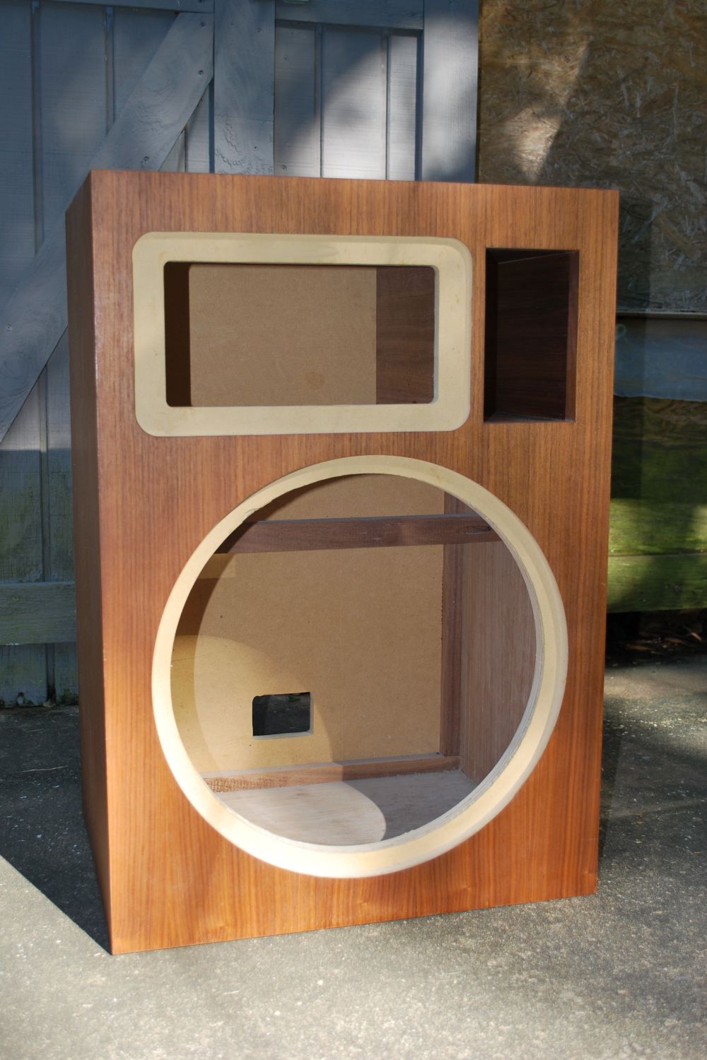

My woodworker sent a snapshot of his progress =>
index.php?t=getfile&id=1182&private=0
I am so pleased to be finally getting these done. They are the real deal, often imitated but never duplicated. Razz

Looks stunning good!
The bracing attached to the sides is that a third one additional to the original design?

It does look a little lower than most people put it, but as long as the front-back brace is in there between woofer and tweeter and the side-to-side brace doesn't interfere with the woofer, it's fine. Just make sure to install the cross-section damping material between woofer and tweeter.

Didn't Scott contact you about the braces? He asked me about them and I told him to email you directly.

Yes, Scott wrote to me asking if the front/back brace needed to be connected to the side/side brace. I replied essentially the same thing I wrote in my last post, that they could be separated a little bit, provided there was no interference with the woofer or tweeter and the sheet of insulation spanning the cross-section could be easily installed and supported by the brace.

Ok great, that's how they are. Thanks!!
