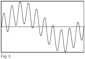

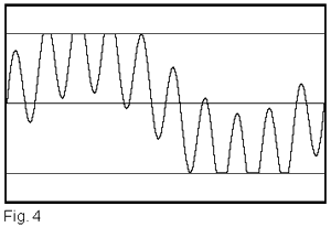

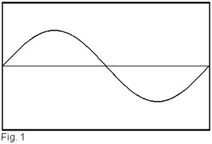

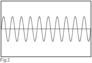

No problem, that's what we're here for. Let me give you some visual aids so you can understand what is gained by reducing amplifier bandwidth.
First, let's look at two signals. One is bass:
index.php?t=getfile&id=1163&private=0
The other is treble:
index.php?t=getfile&id=1164&private=0
When you put them together, as all music content does, the resulting signal looks like this:
index.php?t=getfile&id=1168&private=0
That's fine, and it is what we want. As long as the amplifier has enough voltage swing capacity, it can do everything we need. But you'll notice the treble sort of rides on top of the bass. So if the amplifier doesn't have quite enough voltage capacity, it may clip, like this:
index.php?t=getfile&id=1169&private=0
If you separate the bass from the treble ahead of the amps, then each amp will have less peak voltage requirement.

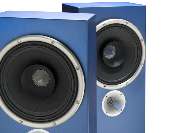

I would replace it with an aluminium ring, or maybe put the aluminum ring above it, like Zu Audio style...
index.php?t=getfile&id=1178&private=0

White (and yellow) glue is a water-based glue commonly used by woodworkers. It's not really all that important what adhesive you use, 'cause you're really just tacking it in there. Doesn't need much hold strenth.
The front gasket on the driver can be removed, but be careful. And I would suggest de-laminating the paper, and leaving a thin layer of the gasket attached. You'll see what I mean when you start pulling it off.
The surround is glued to the frame and the gasket is glued onto that, so you don't want to damage the surround in the process of trying to remove the gasket. The adhesive will have been absorbed into the gasket, and so a very thin portion of it will be hardened and I would suggest leaving that in place. Simply put your aluminum ring over that. Should look really cool.
Re: 2pi tower crossover: mono or biwiring? [message #76856 is a reply to message #76855] Fri, 24 May 2013 13:02 Go to previous message
