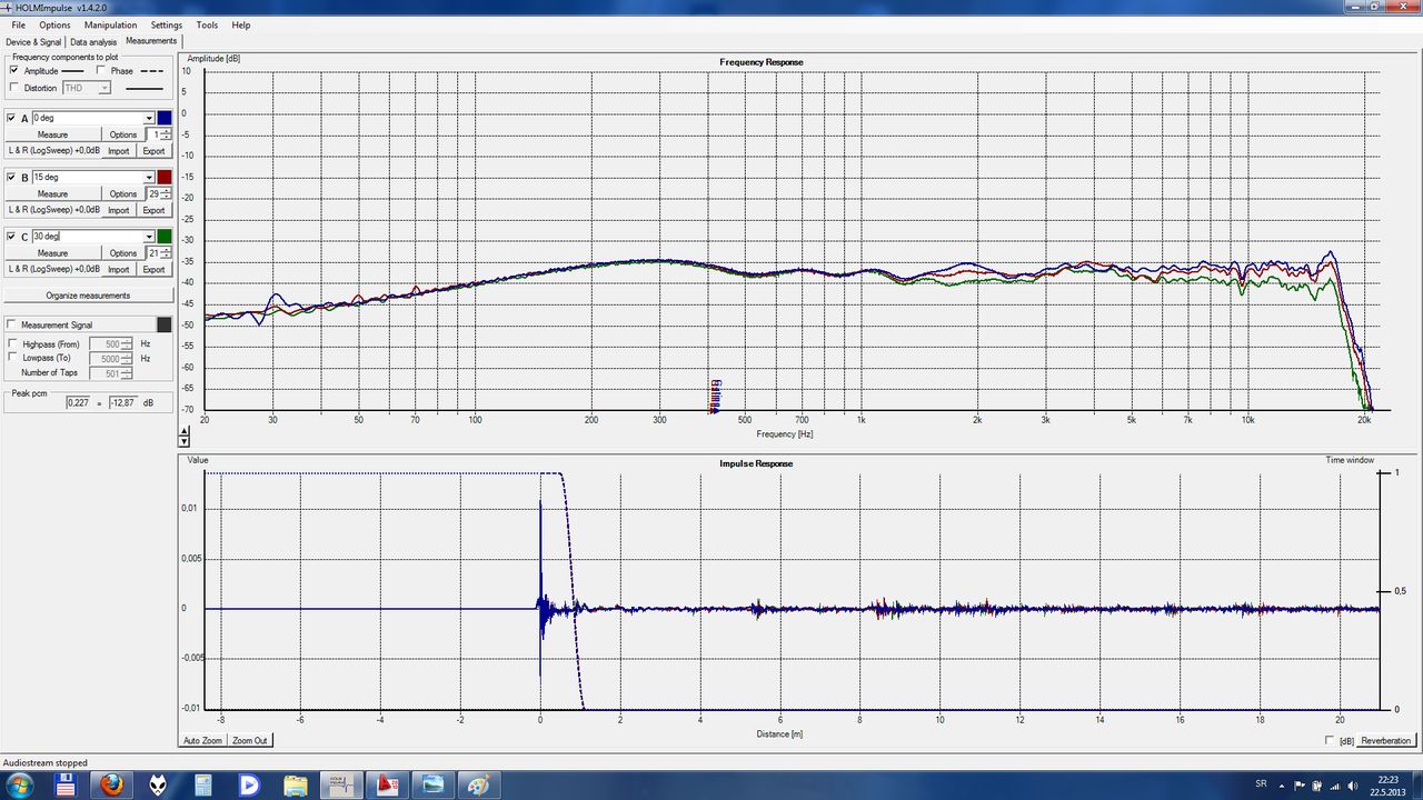

I wanted to thank you once again for all the effort on developing of pi speakers!
Here are some results of measurements that I took recently.
Microphone is WM61A and I used integrated sound card on my laptop.
index.php?t=getfile&id=1173&private=0
Re: 3pi with Sonido SCW-300 [message #76832 is a reply to message #76831] Wed, 22 May 2013 07:26 Go to previous messageGo to next message
Messages: 78
Location: Florida
The measured response looks excellent and similar to the measurements that I've done with the 3Pi (AE TD12S, B&C DE250 and Eminence H290). Try doing some in-room analysis and experiment with the speaker and listening positions. Even small changes can make for significant improvement.
Re: 3pi with Sonido SCW-300 [message #76833 is a reply to message #76832] Wed, 22 May 2013 08:46 Go to previous messageGo to next message
Agreed. Looks very nice!

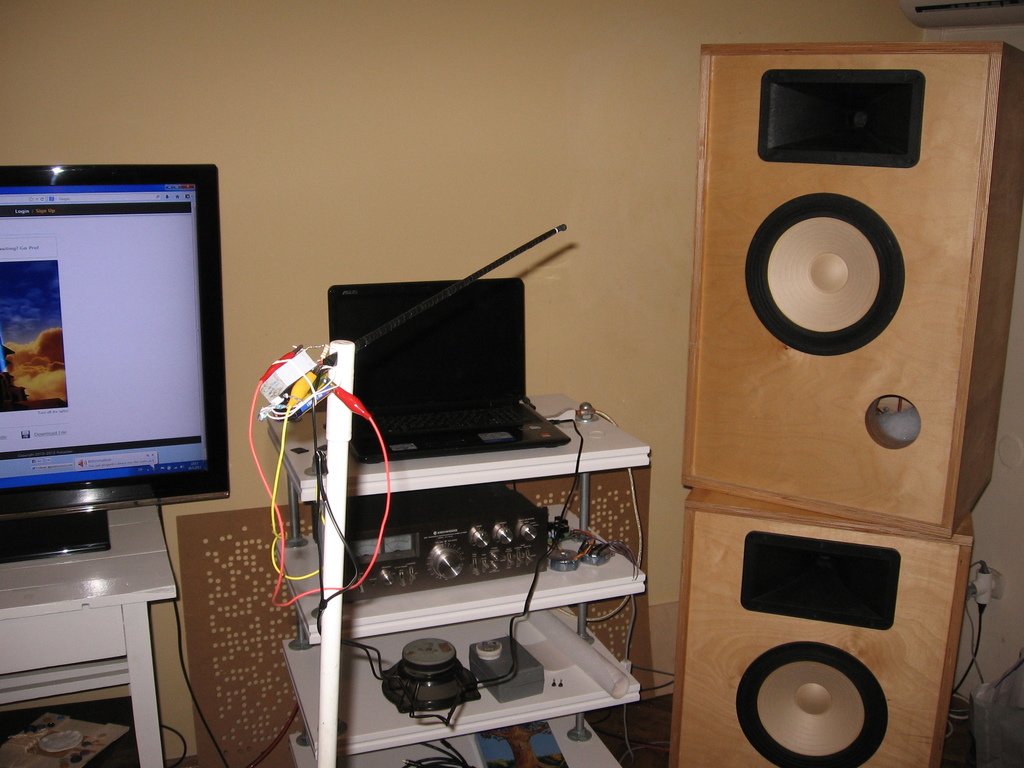

BTW, measuring was performed from 1m on axis with loudspeaker`s mid-center, with mid-center between drivers approximately on 1/2 room`s height.
Measuring equipment is as much poor man`s as possible
index.php?t=getfile&id=1174&private=0
Mic stand and holder are the things that I am most proud of. Laughing
I will try to play more with room position and measure response.

Here are results of offset measurement.
on 15deg, which is normally listening position, response almost looks unreal.
index.php?t=getfile&id=1175&private=0
Overal sensitivity of loudspeaker is around 91db.

Looks great!
