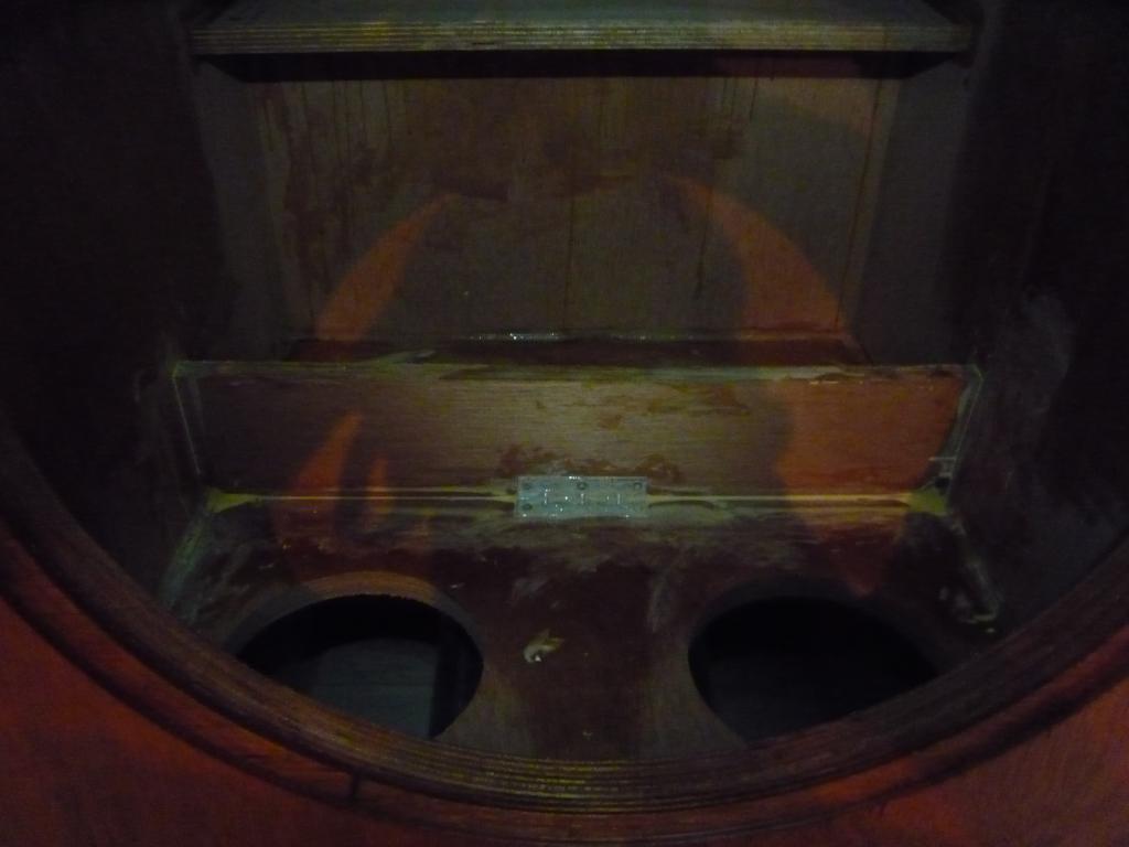

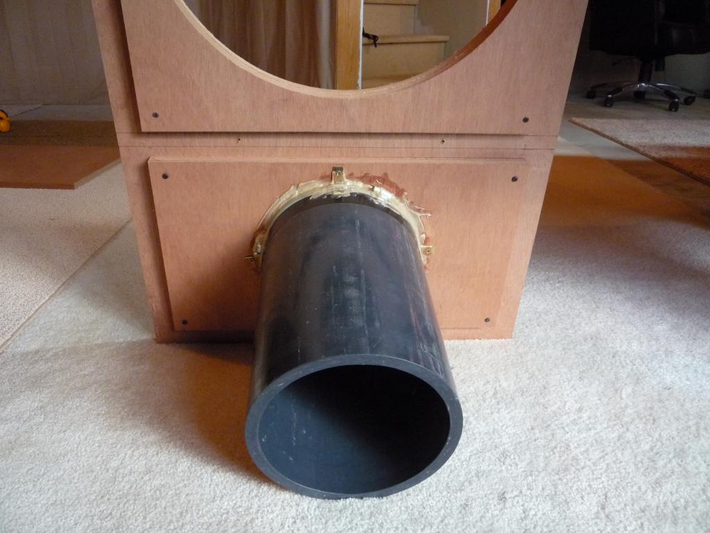

I used Marine Grade Okoume on the build like my 4PI. This is basically good baltic birch type void free wood.. Nice Mahogany veneer... I suck at veneer... I have two layers of 3/4" for the face..
The face I cut the port smaller then the actual port... Then ran a flush cut router so the actual hole of the wood is perfect with the port as the port drove the flush cut router bit. The port was put into a recessed hole on the back of the baffle.. Then I ran some L brackets and some worm gear HVAC brackets.. Covered all in some PL adhesive.. Strong to hold that fat 10lb port
index.php?t=getfile&id=1134&private=0
index.php?t=getfile&id=1135&private=0
Before Braces:
index.php?t=getfile&id=1136&private=0
Braces:
index.php?t=getfile&id=1137&private=0
index.php?t=getfile&id=1138&private=0
index.php?t=getfile&id=1139&private=0
