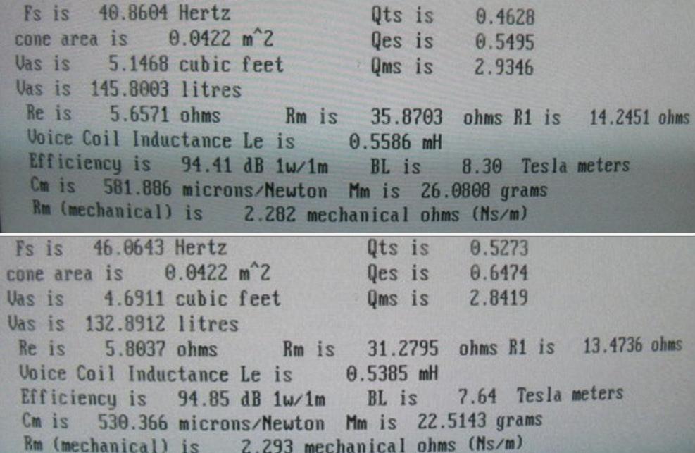

Last, got a couple numbers off the drivers, too, fwiw. No claims/everything disclaimed and any deviations are me or my measurement methods or both, blah, etc.

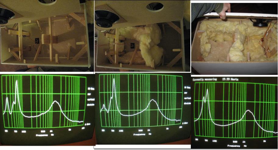

I've burned this whole night messing with stuffing and lining and my head hurts. There's basic voicing stuff either in addition to or resultant from all that internal reflection beeswax, too.
The closest I can get these 2pi tower-ish jobs to sound like pianos and acoustic guitars is completely empty but I can't make that trade for the clarity either.
If I overstuff, man the bass control is even more sweet and it just wants all the watts I can give it...but when returning volume to late-night levels with small/simple/sparse stuff, the "wood harmonics" are too far down and it's not right for guitar bodies and pianos; gets too "closed in".
I keep feeling like it's not even the standing waves but just what reflects back through the cone locally there...but maybe both for all I know. That's next when I step away from this keyboard.
I do feel like I prefer having some lining there closer to the alpha10 but it's all so much more sensitive than I'd have guessed. This driver Really needs space to breathe right (even with about a 15x10 cross section). The tuning doesn't really move but about 3Hz no matter what but the voicing of the thing is night and day.

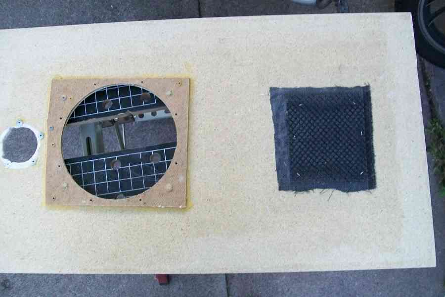

The upshot is that I didn't build the tower as-designed due to height limits--as such, all warts are mine. I simmed a zillion things in Martin's sheets and worked hard to try for a couple more Hz on the bottom. Put the port on the front for the extra couple dB whereever that was...I think I was aiming for max amplitude at ~42Hz or something. Overcooked it a little bit and ended-up throttling the port a little with three layers of fabric from the surplus store stretched over a hunk of gutter guard (aka mammal and grandkid filter) and more fiberglass internally. If I were a proud man, I'd say aperiodicity was a goal and that I Meant to do that. Fact is, the thing lit-up some rooms here and taught me a lot about my house (one placement got my foyer to resonate, somehow, for one, which was wild). It was aligned higher-Q too-low for my place, but better for where it was headed. (And, since the port location will come-up, yup, I did look at about the first 5 box harmonics when choosing that spot).
Because it's a kit, all the heavy-lifting is done, but I still used it to investigate what could be had from going nuts on whatever else was left. I learned a lot. Worked so hard and learned so much building something for a friend that I'll never do it again Wink

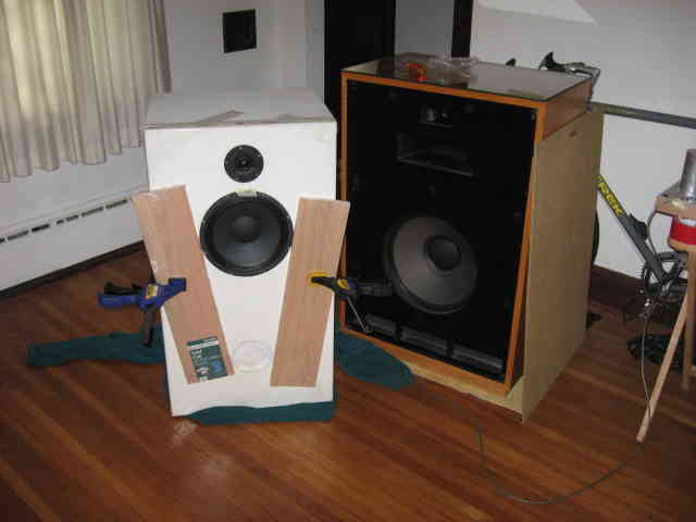

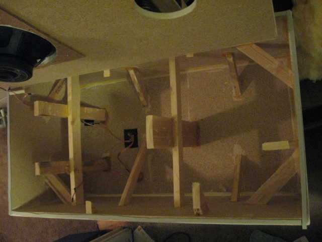

I glued 5-sides early and then clamped/unclamped the baffle during all manner of wanking with bracing and lining. Ran them maybe 8-9 months that way, in and out of the system as thoughts of rebuilding different boxes or trying different drivers danced in my head. Ran them side-by-side with 8 other pairs of speakers from OB to tiny monitors to...everything in the place.
First, I used 1/2 (walls) and 5/8 (baffle) particle board as a nod to weight considerations and sought to brace for what was traded in wall thickness. I did diy an accelerometer and a little preamp to mess with that stuff, but honestly, once I figured out how to really listen for pboard walls, the knuckle system worked reliably and I didn't have to wonder about any data. Where I arrived is pretty-much ~6" max unbraced span. Anything else even the knuckle-test reveals. Spent a lot of time comparing to plywood and, if I had to do it over again, I'd go all-plywood if I could swing nice plywood. Still and all, best boxes I've built.
The lining and tuning, as mentioned-above, are interdependent, but I went through several extended sessions running them on their backs and quickly iterating lining configurations. For kicks, I took some Z curves when doing that to see what might've been happening with tuning. The tuning shifts were minimal compared to the voicing of the boxes. I can't recommend the exercise more strongly. Over the course of maybe a year, I did probably four 3-4 hour sessions cycling the same snippets of the same material. (In case anyone wonders, dry bead of RTV was on one box, and I went with rope caulk on the other. Packing tape and clamps for the rest. After having to scrape and 40-grit the RTV out prior to gluing, note-to-self--Never use RTV for that again. I tried weatherstripping once, too, which is fine for short clamp-ups, but has the same problems as the RTV if you leave it mashed into the edges of the box for days).

In the end, I listened to them the most alongside Cornwalls and tuned to approximate them. They get closer than I'd have thought possible, though in-fairness, it's clear that a 10 inch driver is not a 15 inch driver (mostly in scale of presentation, not amplitude/FR so much). I worked really hard to make piano and cello sound the same Size on these as on the Cornwalls. The large box really helps (and there's no substitute), but lining is part of that as well. The size illusion came-off really-well.

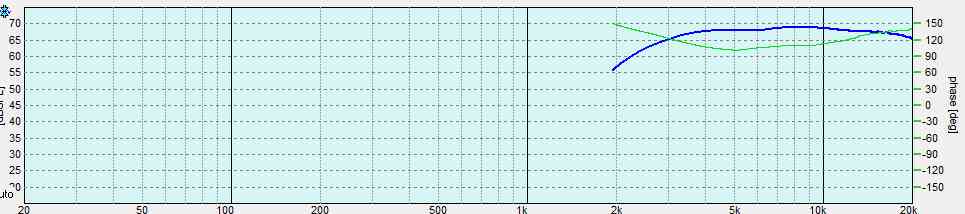

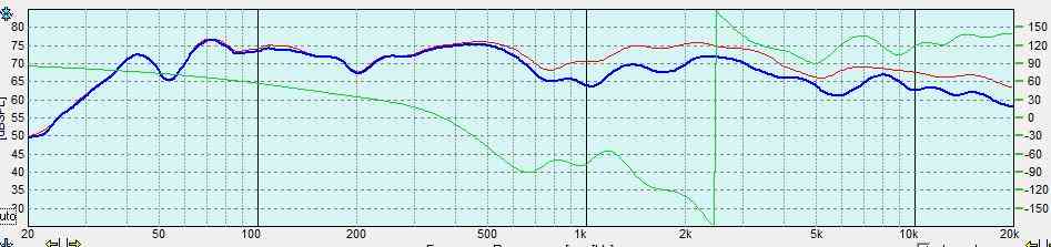

Couple more files while I'm here (and yes the CW are almost exactly 1-bicycle tall). Thanks for all the bandwidth.

Looks like a great cabinet, and the (no grille) measurement results look pretty similar to what I get from the towers, so I think you've kept the internal standing waves at bay. Nice job!

Thanks, but I'm sure my quick in-room is heavy on the room and I hesitated to post-it. I literally only had about 20 minutes to cobble a rig and take whatever data I could when it came time to ship them out.

That's true, of course, but the HF range looks pretty much untainted by the room. The LF response is going to be dominated by the room, but it looks clean above 100Hz. And the 100-300Hz range is what I was most concerned with anyway. That's where the internal standing waves would have presented themselves, and even smoothing wouldn't hide them. But response is clean there, so I'd say your port, driver and stuffing layout is good. There's something going on at 200Hz, but I'm betting that's self-interference from a boundary outside the box.
