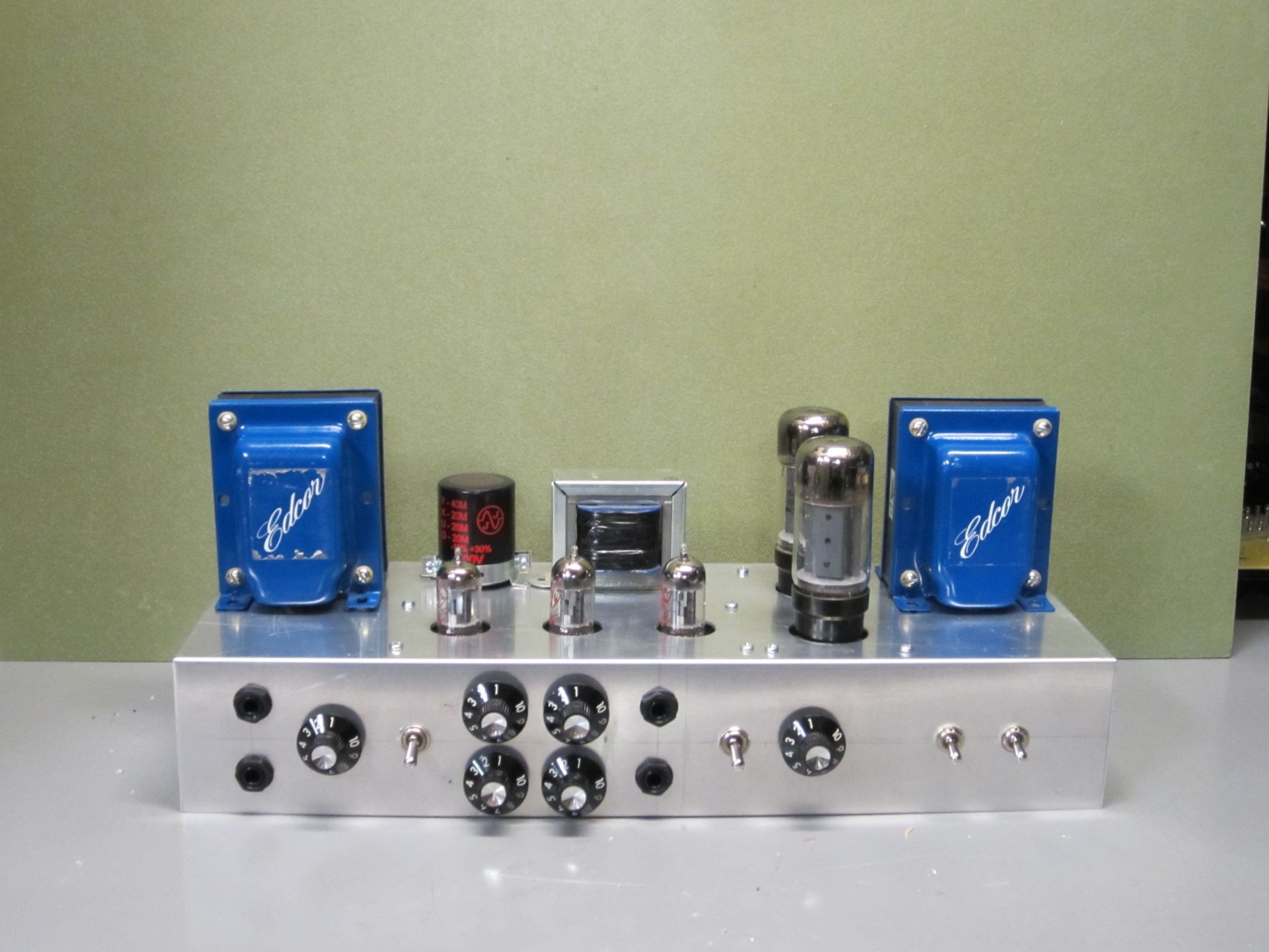

Hi Everyone, Getting serious now... index.php?t=getfile&id=1021&private=0
