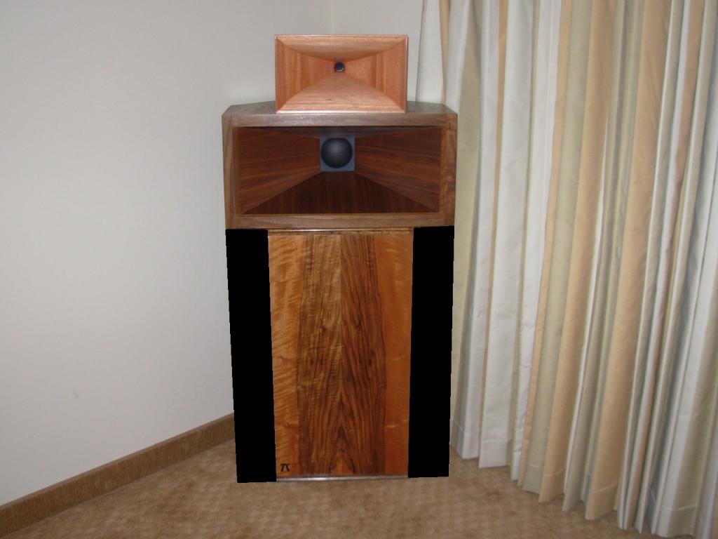

Hi Wayne,
I wanted to see what you think about the idea of using filler panels to make the Cornerhorn's mid-horn and bass enclosures appear more monolithic (similar to the look of the Khorns). These panels would butt up against either side of the bass bin and extend from the floor to the underside of the mid-horn. To look consistent from all angles, the panels would need to be L-shaped to also fill-in below the mid-horn's sides. If the filler panels need to be acoustically transparent, large cut-outs could be added to the panels and then wrapped with grill cloth.
I also wanted to ask if the portion of the bass bin that extends into the corners has any sonic significance (other than providing the correct spacing from the corners)?

There's no problem adding "wings" to the bass bin, although it does reach a smidge into the lower midrange so I wouldn't shadow it too much. An acoustically transparent (or nearly transparent) grille or foam would probably be best.
There is no significance in the top of the "doghouse" shape, it is merely a positioning device. It's really just a woofer in a slightly overdamped alignment, facing into the corner. The walls do all the work here.

Here's a 7Pi with photo-shopped wings:
index.php?t=getfile&id=1060&private=0
Re: Pi Cornerhorn Aesthetics [message #75790 is a reply to message #75789] Tue, 12 March 2013 19:02 Go to previous messageGo to next message
Looks kind of like a shortened version of the old seven π-18 bass bin, which was used with JBL 2241, 2242 or 2245 woofers. It was 24" wide and 46" tall, which is a foot taller than that (2226) seven π bass bin.
