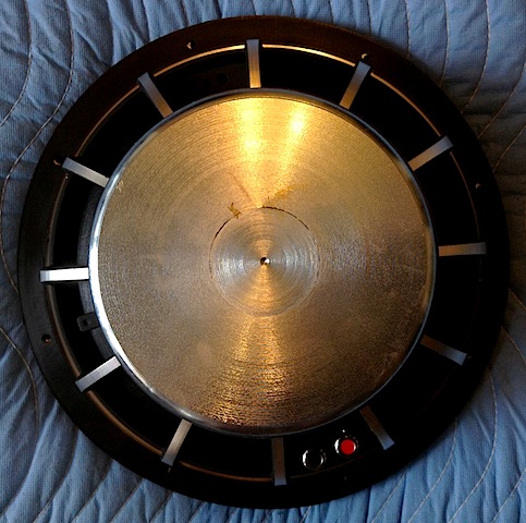

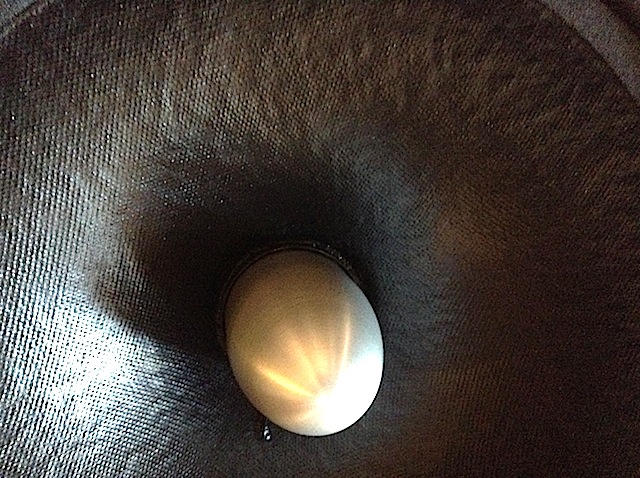

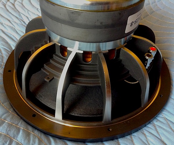

Finally got my AE TD12S woofers.
I have a few questions. First, there is an inconsistency in the circular cutout of the cone surrounding the phase plug. I tried to get it clear in pics, but it looks worse in real life. Is this OK? I assume that as long as it doesn't rub, and is close enough to the phase plug, I am OK. However I never had woofers like this and, like I said, it looks worse in person.

I'll send plans out right away.
As for the TD12S, I think what you're saying is the voice coil former was cut slightly on a diagonal. I suppose it doesn't matter, since there is no dust cap to interfere with. For that matter, some dust caps are glued to the former but others are glued to the cone, and don't touch the former. There are probably a lot of 'em out there covering voice coil formers that were cut just like yours.
All that said, I would probably give John Janowitz a call. The AE woofers are very attractive, and most people proudly run 'em without grille's because of that. So can understand that you don't want 'em looking funny. You might give John a call and see what can be done.
Re: Skywave's 3 Pi Build [message #75546 is a reply to message #75545] Sat, 16 February 2013 20:07 Go to previous messageGo to next message
Messages: 107
Thanks or pointing that out, Wayne. I did not consider that the voice coil former could be out of round, thinking there would be a tight tolerance in the gap. But now I understand that one is really the same as the other.
I am not talking about a diagonal. but out of round.
I think I can unscrew the phase plugs to get a better look at the vc former roundness.
Not happy at all.
Re: Skywave's 3 Pi Build [message #75547 is a reply to message #75546] Sat, 16 February 2013 23:07 Go to previous messageGo to next message
Yeah, I suppose it could be a little out of round without rubbing. The gap tolerance isn't like hydrodynamic bearing clearance, nothing even close to that. It couldn't be and still allow room for thermal shifts. But it is best that the former be round and centered in the gap.

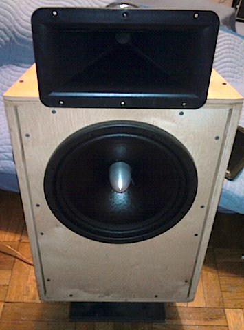

I couldn't wait, so I threw one woofer in my existing too-small box, sealed, a lot of stuffing, with the H290C on top just to check it out. I was previously using a 4 Pi crossover, so was not difficult to change the circuit to 3 Pi.
As expected, not much bass due to the small, sealed box. I could mount the waveguide in the baffle. However this is just temporary because I will use a ported box to spec.
Have not decided what I will do about the out of roundness.

Re: Skywave's 3 Pi Build [message #75552 is a reply to message #75543] Mon, 18 February 2013 06:05 Go to previous messageGo to next message
Messages: 78
Location: Florida
The three AE TD12Ss that I have all show an even reveal of a bit less than a millimeter around the phase plug, so you you're driver may be an exception. Do both woofers show the same issue? Is the phase plug really round or a subtly elliptical? As Wayne said, the issue is probably only cosmetic and won't have any functional consequence, but I'd confirm that with Acoustic Elegance. Mounting the woofers with the most uniform gap area at the top may address the cosmetic issue with the TD12Ss mounted in the cabinets if there are no functional issues. The Eminence 12LFA is a good driver, but the AE TD12S is worth the extra cost in the 3Pi. Good luck!

Messages: 107
Thanks, rkeman, I will attempt to call AE tomorrow and see what they say. I have not been able to remove the phase plugs, I'm a little afraid of applying a lot of torque to unscrew them.

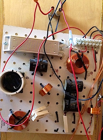

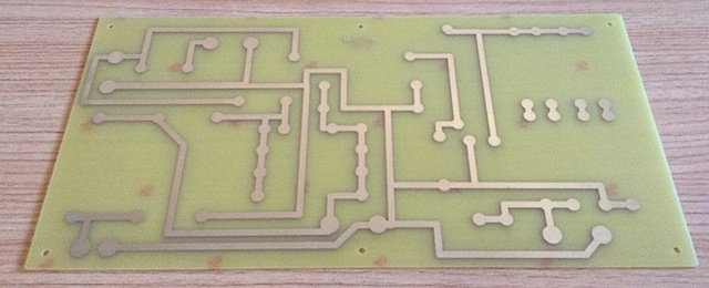

For giggles, here's my crossover, modified. All the components on that board are not in use because the 3 Pi uses fewer components. Following that are the beefy Pi crossover boards I have waiting in the wings for the build. Smile

OK, I moved parts from my breadboard to the Pi PC board. I don't have enough of the correct value resistors for the HF attenuation circuit, so I improvised. What I have is a total of 30 Ohms (single 30 Ohm, jumpering R1B) in the R1 position and 14 Ohms (2 paralleled 20 Ohms to a 4 Ohm in series) in the R2 position. Let me know if I did anything stupid.
I will order Mills resistors in the correct amounts and values so the crossover will be able to handle full rated power. At the moment there is no chance anything will become warm.
I used silicon under the permanent components, as Wayne suggests.

skywave-rider wrote on Wed, 20 February 2013 11:06
Looks good! You're on your way to having a top-notch speaker!
Your resistors will work that way, but, yeah, when you get the Mills, it will be better 'cause not only will it take full rated power but even at lower power levels, the resistors will stay very cool. That's always good.
I see you drilled holes for component leads, as most circuit boards are done. I didn't do that because I normally put the board on a gasket and mount directly to the inside bottom panel of the cabinet. The solder pads would protrude if I did it this way, so I mount the components on the solder side. But if you use stand-offs for mounting or use a really thick gasket, the solder pads won't protrude into the wood panel.
http://www.pispeakers.com/misc/pcb_gasket_outline.jpg
