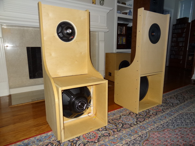

This is a reboot of a topic I initially discussed on the LSAF 2013 thread. I don't want to hijack that thread with too much discussion about one DIY project, so I'm restarting it here. The speaker project incorporates open back Dayton Audio PS220-8 8" Point Source Full-Range Neo Drivers with H-Frame mounted Eminence Alpha 15's as subwoofers. A DEQX digital processor is used as the elctronic crossover and for equalization.
Here's a picture of the two speakers with the drivers mounted but not wired:
index.php?t=getfile&id=1026&private=0
  • Attachment: DSC01287.JPG

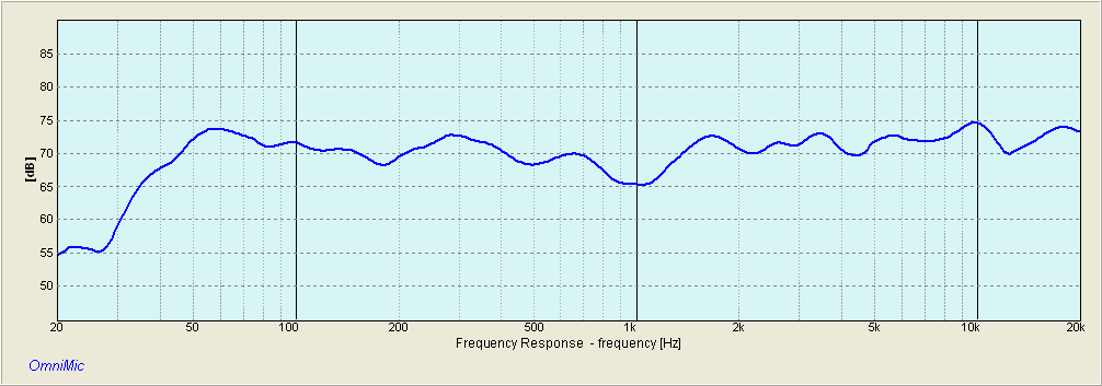

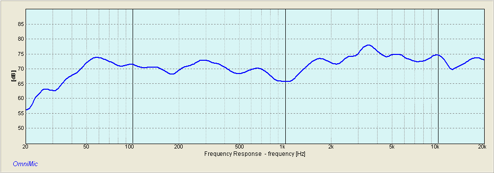

I wired them up this morning and connected them to the system. Just to get started I set the crossovers for 150hz, using a 48dB LR slope for the subwoofers and a 24dB slope for the full range drivers. Measurement revealed the full range drivers were about 5dB more sensitive than the subwoofers, so I added a 5dB boost to the subs. Here's the measured in-room frequency response of one speaker, on axis, with no equalization.
index.php?t=getfile&id=1027&private=0
Re: Dayton Audio/Eminence Full Range Single Driver [message #75507 is a reply to message #75506] Tue, 12 February 2013 11:45 Go to previous messageGo to next message
Messages: 377
Location: Houston
Here's the measured response with some equalization added. The next step will be to get about 25 hours of time on them before further tweaking.
index.php?t=getfile&id=1028&private=0

Re: Dayton Audio/Eminence Full Range Single Driver [message #75563 is a reply to message #75505] Tue, 19 February 2013 15:14 Go to previous messageGo to next message
Messages: 377
Location: Houston
I've decided to try something different, and so far I like what I'm hearing. These speakers sound very good using the DEQX for equalization and crossover, but realistically how many people have that kind of equipment? If I can make them sound good with no digital equalization and a couple of subwoofer plate amps on the subs, then they become a very affordable alternative for somebody wanting to try an open back full range single driver speaker that has impressive bass.
While there's no way to achieve the flat response in the second graph above, anything that can be done to reduce the level of that broad peak centered about 3.6khz will make them less in-your-face bright, and far more listenable. Many single driver builders incorporate a bsc circuit to balance the bass with the upper midrange and treble, but this has the unfortunate effect of reducing the speaker's sensitivity by several dB, not a good option if you're planning to use them with a flea power tube amp. With these speakers the bass is handled by the subwoofers, so there's less need for baffle step correction, and a simple notch filter can be incorporated into the full range driver's signal path to reduce the unwanted peak. This I did, using a 6.8uF cap, a 0.2mH air core inductor, and a 12.5 ohm resistor, all wired in parallel, and inserted into the positive lead to the full range driver. Works like a charm.
For subwoofer amplification I used a couple of buyout 100W amps that Madisound was selling for $25/ea a few years ago. I bought four and still had two stashed away in the man cave. One hundred watts (70W into the Eminence's 8 ohm impedance) doesn't sound like much power, but this isn't a speaker you would build to listen to Metallica or Mahler, and it works fine.
I'll post some measurements plus some listening impressions after I've had a few days with them.

Re: Dayton Audio/Eminence Full Range Single Driver [message #75572 is a reply to message #75564] Wed, 20 February 2013 05:58 Go to previous messageGo to next message
Messages: 377
Location: Houston
Wayne Parham wrote on Tue, 19 February 2013 16:41
If the humpty-dumpty response is too much, then give it a filter to make it better. There's a sort of balance, I think, between a little bit of voicing and what's too much. Some designs clearly go too far in the quest of ruler-flat on-axis response and the speaker sounds dead and lifeless.
That's what I've found with dsp equalization. You can create any number of filters and make the response +/- 1dB or less, but that doesn't mean it will sound better. Quite often when I completely equalize out a peak, I find I prefer the sound with that peak only partially eliminated. For example, that 6dB peak at 3.6khz is going to sound really bright, but the speaker might sound more lively and more involving with that peak reduced to only 3dB rather than completely eliminated.

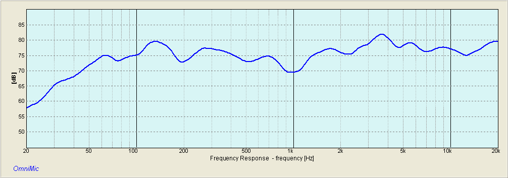

Re: Dayton Audio/Eminence Full Range Single Driver [message #75587 is a reply to message #75572] Thu, 21 February 2013 07:57 Go to previous messageGo to next message
Messages: 377
Location: Houston
Here's a frequency response graph, with the mic positioned at ear level (35" from floor), 40" from the Dayton driver, about five degrees off axis, without the notch filter, using 1/6 octave smoothing.
index.php?t=getfile&id=1045&private=0
Re: Dayton Audio/Eminence Full Range Single Driver [message #75588 is a reply to message #75587] Thu, 21 February 2013 07:58 Go to previous messageGo to next message
Messages: 377
Location: Houston
The same, but with the notch filter installed.
index.php?t=getfile&id=1046&private=0

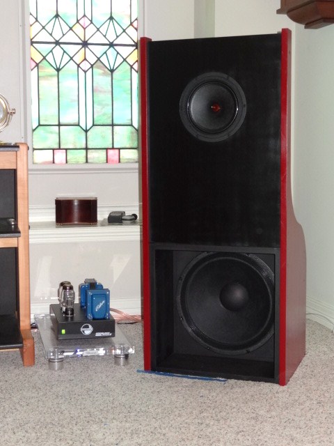

Re: Dayton Audio/Eminence Full Range Single Driver [message #76038 is a reply to message #75505] Wed, 27 March 2013 16:50 Go to previous messageGo to previous message
Messages: 377
Location: Houston
Finally put some lipstick on them.
index.php?t=getfile&id=1081&private=0
