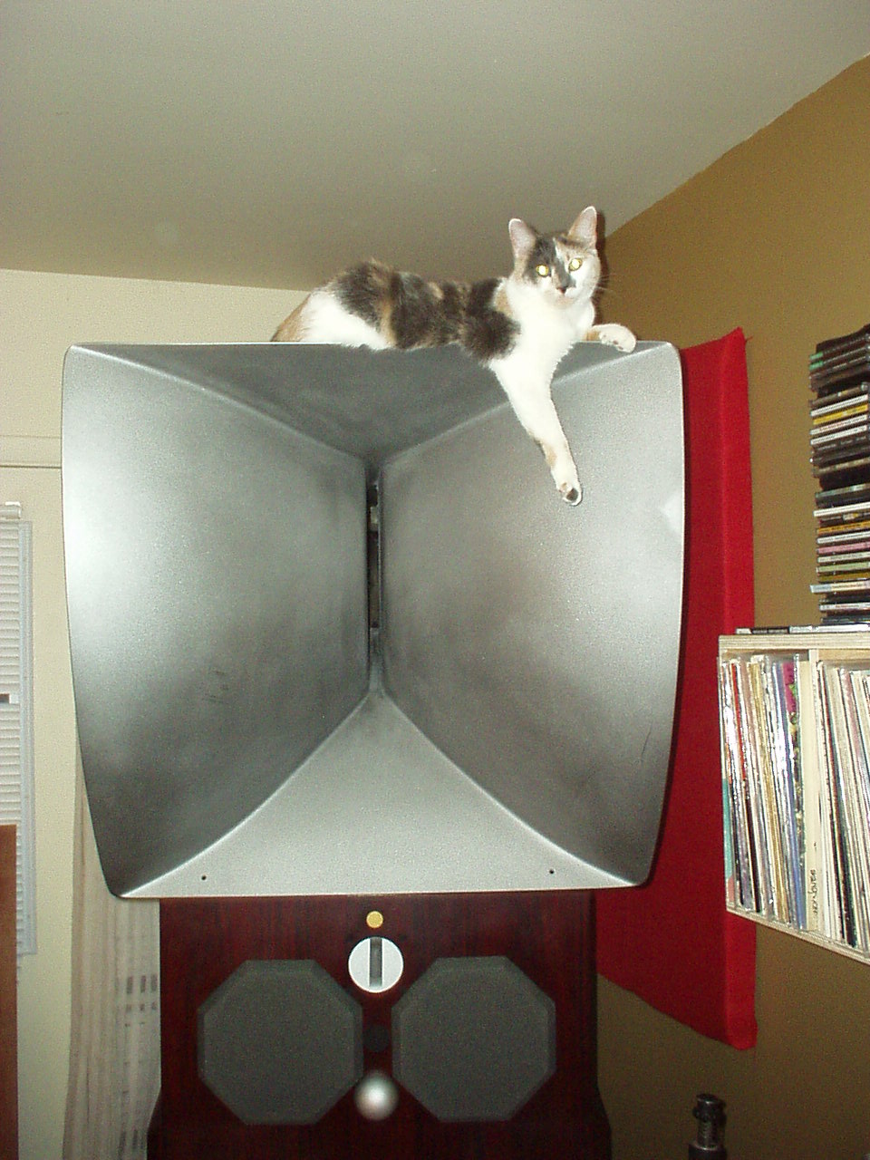

I thought the JBL 2446 and 4370A Horn were just the right size for the home and so did Moose
index.php?t=getfile&id=1024&private=0
