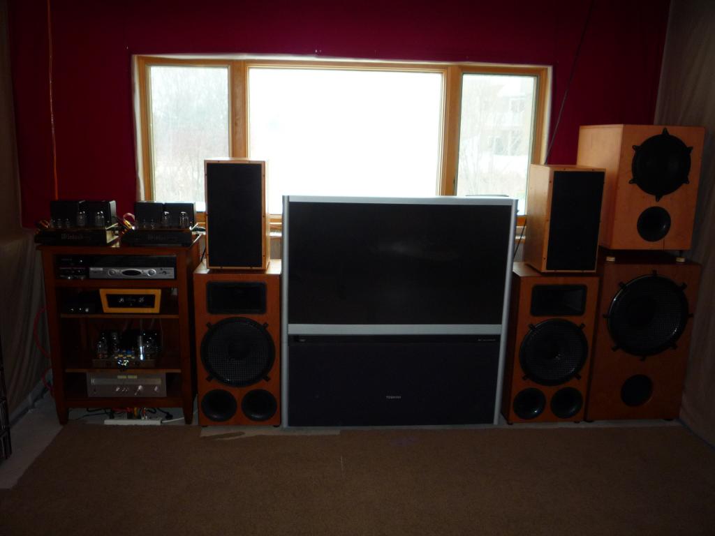

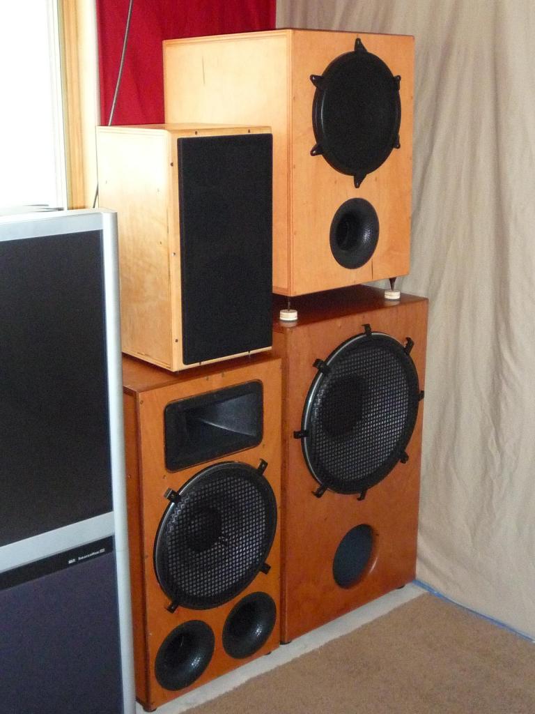

I finally got a Subwoofer built using the 2242h 18" driver. Love it!
I'd 100% support anyone in going this route. I'd love to go with 2 but the room is an issue... that and the $$$$.

Re: 4 PI by Andy [message #76368 is a reply to message #76364] Thu, 18 April 2013 18:36 Go to previous messageGo to next message
Those speakers look fantastic!
But - yeah - I know what you mean about the size of those big-box 10ft3 monster subs. They start getting intrusive when you consider using them in multiples. That's why I designed a smaller cabinet when I started doing multisubs.
My little three π subwoofer is a nice size for flanking the mains and/or distributed multisub placement. It provides excellent extension and smooth response, but it isn't as efficient the larger cabinets like you have. That's the trade-off for their smaller size.

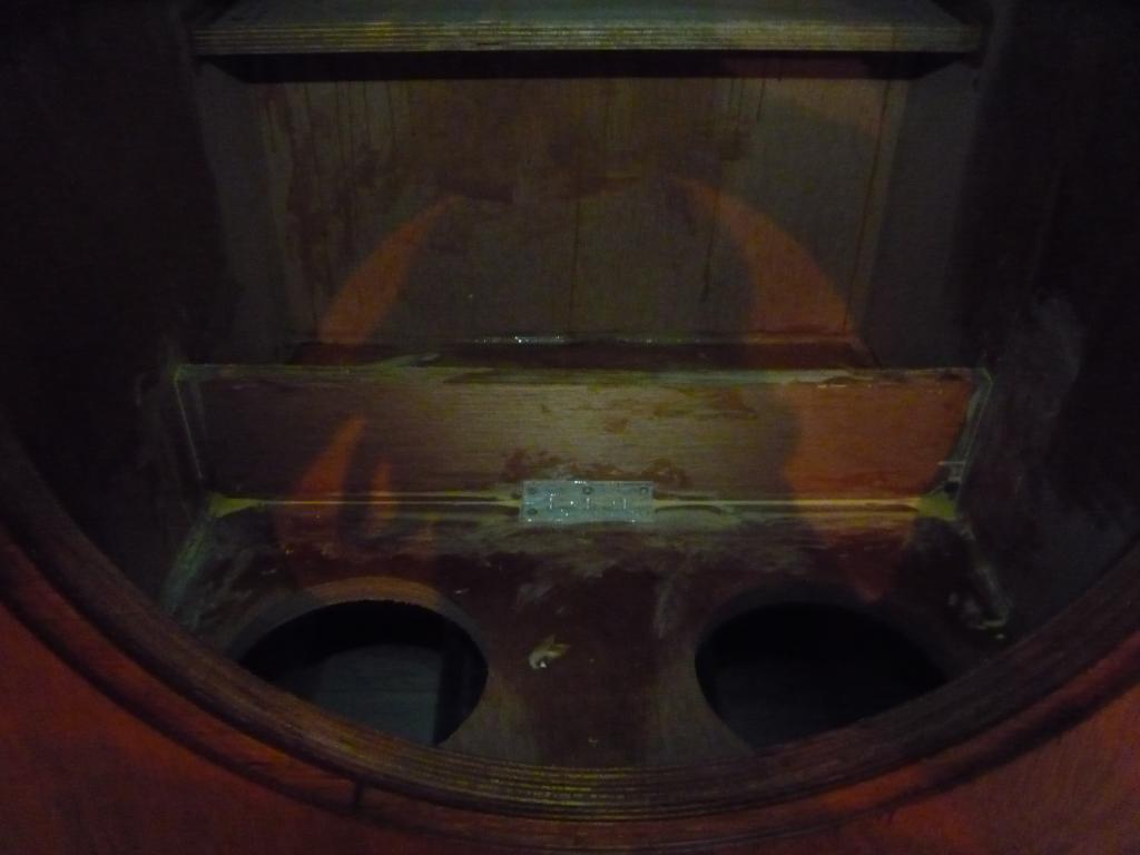

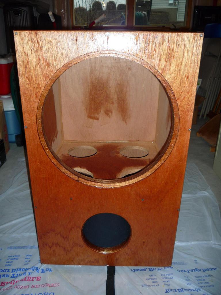

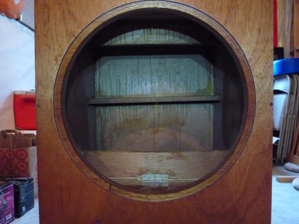

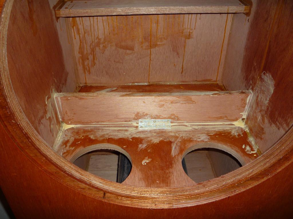

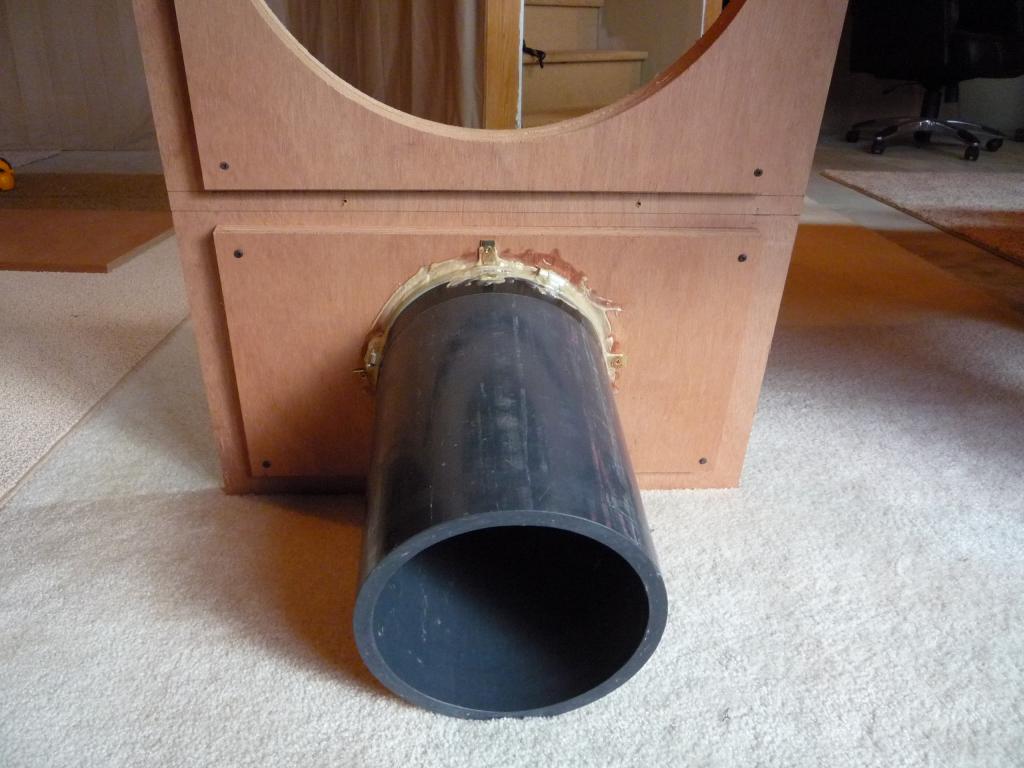

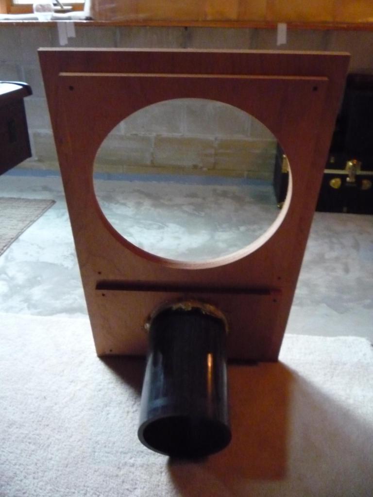

I used Marine Grade Okoume on the build like my 4PI. This is basically good baltic birch type void free wood.. Nice Mahogany veneer... I suck at veneer... I have two layers of 3/4" for the face..
The face I cut the port smaller then the actual port... Then ran a flush cut router so the actual hole of the wood is perfect with the port as the port drove the flush cut router bit. The port was put into a recessed hole on the back of the baffle.. Then I ran some L brackets and some worm gear HVAC brackets.. Covered all in some PL adhesive.. Strong to hold that fat 10lb port
index.php?t=getfile&id=1134&private=0
index.php?t=getfile&id=1135&private=0
Before Braces:
index.php?t=getfile&id=1136&private=0
Braces:
index.php?t=getfile&id=1137&private=0
index.php?t=getfile&id=1138&private=0
index.php?t=getfile&id=1139&private=0

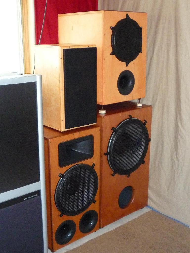

index.php?t=getfile&id=1118&private=0
  • Attachment: speakers.jpg
    (Size: 54.15KB, Downloaded 5751 times)
icon14.gif  Re: 4 PI by Andy [message #76379 is a reply to message #76376] Fri, 19 April 2013 00:02 Go to previous messageGo to next message
Impressive system, and nice finish work, they look great!
I've always loved the JBL 2242 driver. I think my favorite all time direct radiating sub is a JBL 2245 in a 10ft3 box tuned to 30Hz. The 2241 and 2242 are very similar, and louder too. So kudos to you on that!
