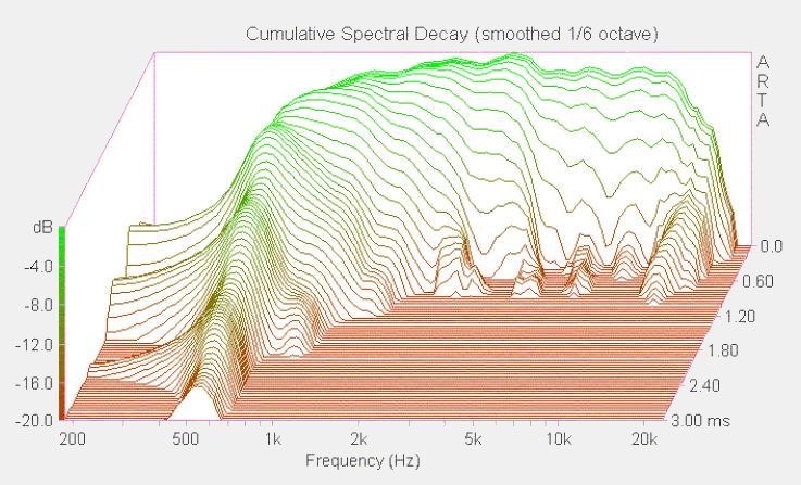

Are any impulse response or waterfall charts of DE250 in your systems posted online?
Re: Spectral decay time of HF drivers [message #74684 is a reply to message #74682] Fri, 30 November 2012 15:30 Go to previous messageGo to next message
Messages: 19099
index.php?t=getfile&id=940&private=0
DE-250 Spectral Decay
