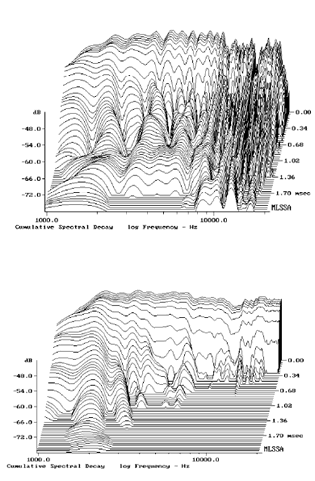

just looking at the two waterfall charts below and leaving all other considerations aside, would you expect the difference in decay time on this scale to be a factor in practical terms?
http://www.alconsaudio.com/site/images/cinema/proribbon.gif
Re: Spectral decay time of HF drivers [message #74681 is a reply to message #74680] Fri, 30 November 2012 14:58 Go to previous messageGo to next message
Yes, I think the device with the greater decay time at 10kHz would sound more "spitty", like the old compression drivers on diffraction horns. But I would also question whether or not the charts presented by a manufacturer about competing products were really a good representation, or whether they picked a "worst case" to compare themselves with.

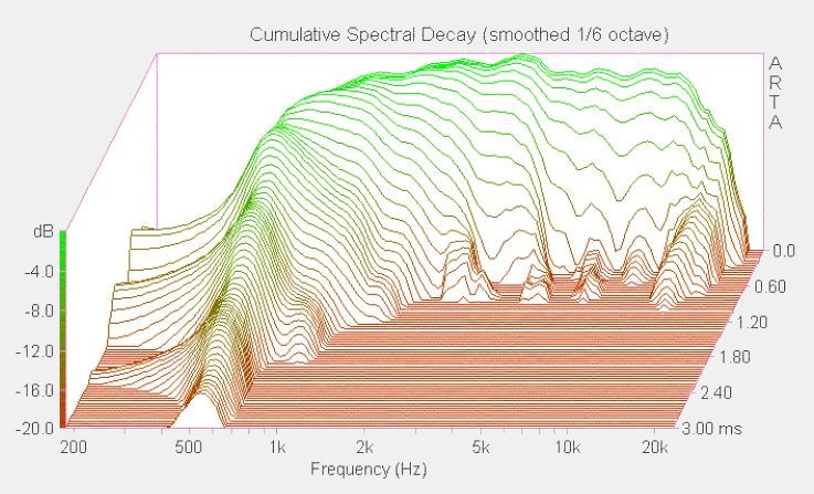

index.php?t=getfile&id=940&private=0
DE-250 Spectral Decay
