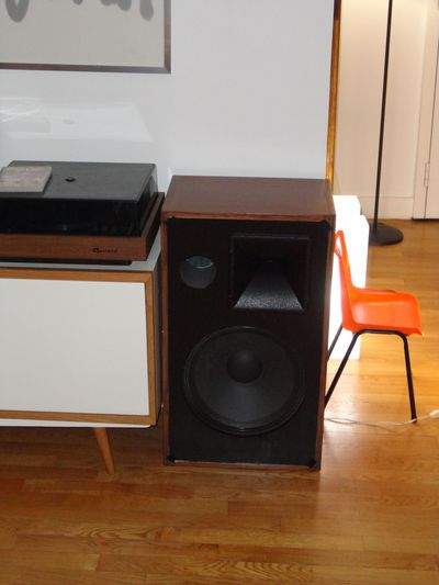

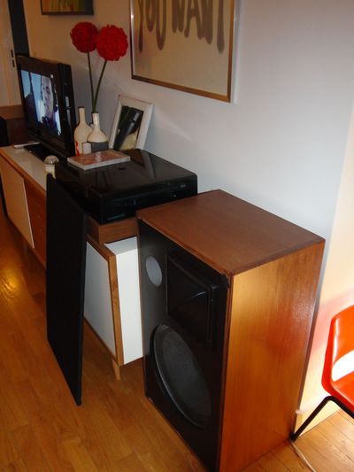

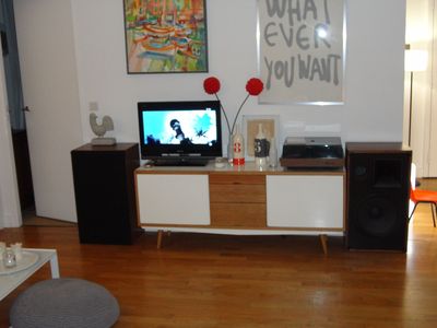

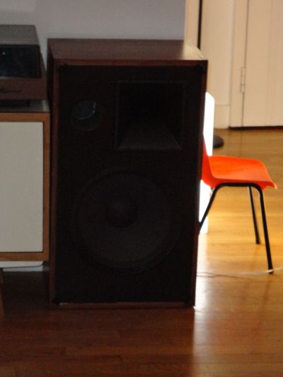

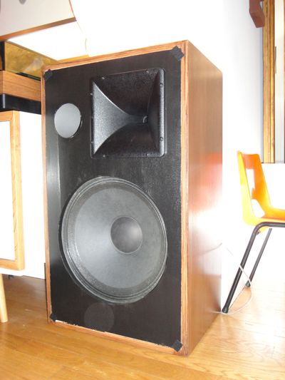

As mentioned in my last post, please find below the attached files with the pictures:
index.php?t=getfile&id=932&private=0
index.php?t=getfile&id=933&private=0
index.php?t=getfile&id=934&private=0
index.php?t=getfile&id=935&private=0
index.php?t=getfile&id=936&private=0

Those are very nice looking speakers, Arthur!
Kind of remind me of Geddes Summas. I'll bet they sound really good!
But I do think you'll like the version with the H290C better. It provides a better pattern, with a taller forward lobe (thanks to closer driver spacing) and less output at large off-axis vertical angles, so less celing slap.
