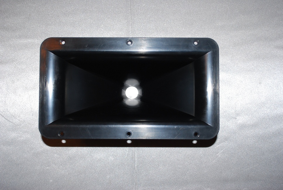

Sorry to belabor this, but I want to be sure to get the baffle recesses right. In the H290C picture below, it looks like the corner radius is about the same height as the top and bottom flanges which are about 0.8", right?
index.php?t=getfile&id=931&private=0
Re: H290C dimensions [message #74651 is a reply to message #74650] Thu, 29 November 2012 12:33 Go to previous messageGo to next message
Yes, exactly. If you continue to rotate the curvature of the corner to form a full circle, it will have diameter of 1.6", e.g. radius of 0.8".
